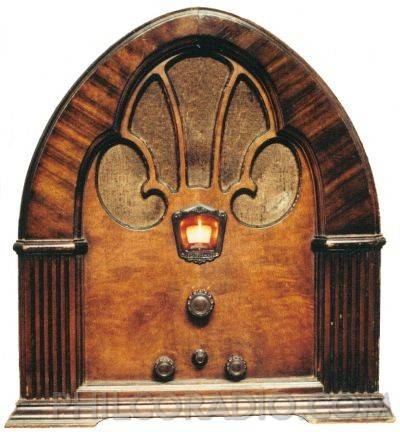

Cathedral - Model 90 Baby Grand, 1931 Tombstone - Model 16B, 1935

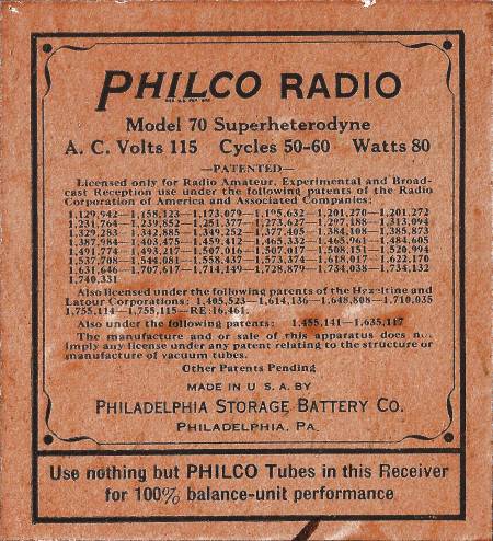

Model number label for Philco model 70
For Philco models made between 1929 and 1932, just look for a large gold label which will state PHILCO RADIO at the top. This label will have several patent numbers on it. But the number we are looking for is easily found underneath the words PHILCO RADIO.
See?
It clearly says "Model 70 Superheterodyne."
The model number of this radio is Model 70.
This decal is on a large tube shield which may be missing from your radio, in which case there will be no identification elsewhere on the radio.

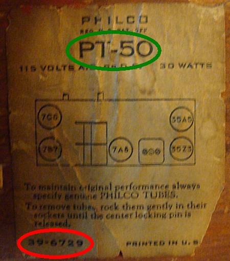

Model number label for the PT-50
Finally, here is a type of label that confuses a lot of people.
Many folks believe the numbers in the lower left corner of this label (in this case 39-6729, inside the red oval) is the set's model number.
This is not correct.
The 39-6729 is the part number for this label! It is of no use whatsoever in identifying this radio.
Again, you need to look underneath the word PHILCO to find the real model number - in this instance, it is PT-50, inside the green oval.
These types of labels, which also identify the tubes used in the set, can be found inside the cabinet, or on the bottom of some table model cabinets.
