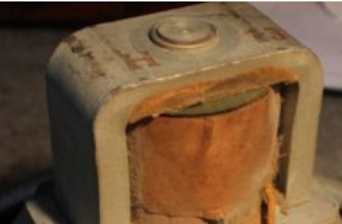

I bought a 650X at the Rose Bowl flea market (Pasadena) but it was missing the speaker.
I am NOT experienced in fixing old radios but I did study electrical theory at 'A' Level in England.
I discovered that the H-13 was the right speaker. I found one on eBay and bought it in a hurry because I'd been searching for 2 years. I may have been a little hasty. Perhaps one of you could advise?
The speaker has H-13 stamped clearly on the field coil area and per seller the parameters are as follows:
1/ 1.2K ohm field coil
2/ Center-Tapped transformer @ 309 ohms
3/ Voice coil resistance 0.7 ohms
Does this sound about right in your opinion?
Thanks,
Justin.
Reply
Hi Justin and welcome!
Here's everything you would ever want to know about Philco Spkrs.
http://philcoradio.com/phorum/showthread.php?tid=215
Zip file near bottom. Yes that is the spkr you are looking for.
