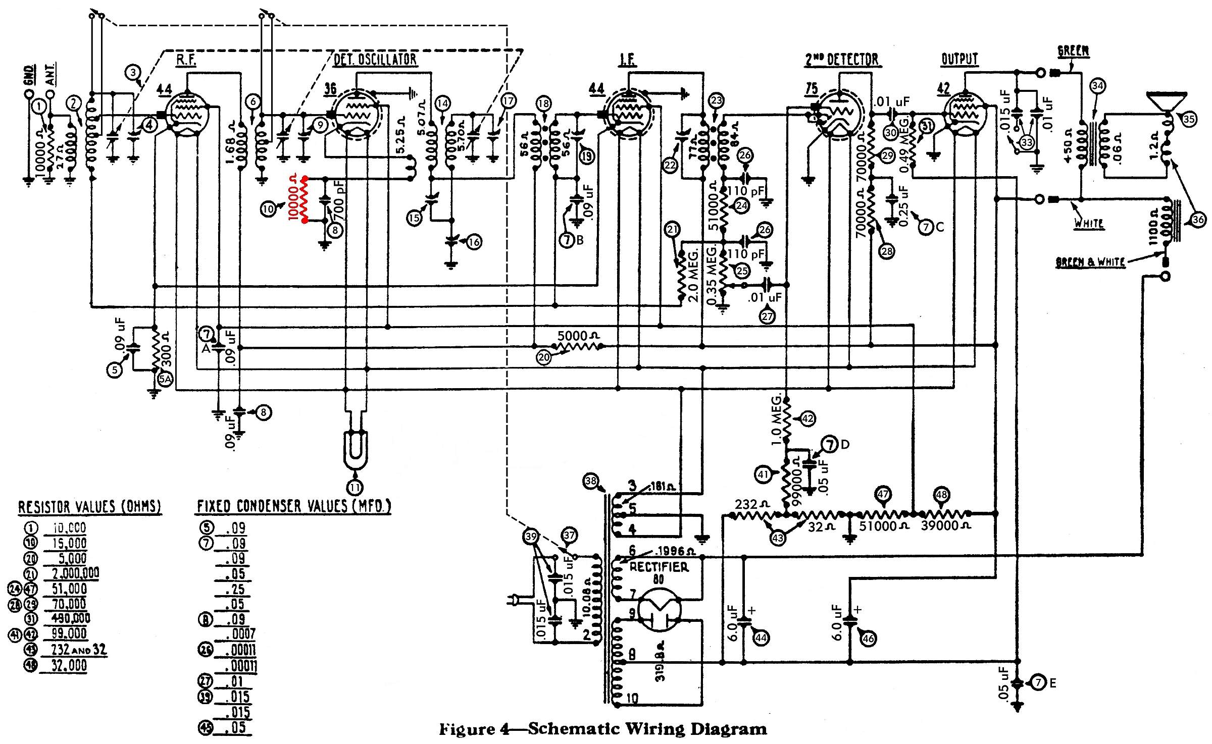

Hi Ron...whats the easiest way you know of to exactly pinpoint which production run this is...( part numbers than can easily be seen)..thanks Buzz
Make an educated guess based upon the facts available.
We know that this version of the 89B is a 1935 model, and it went into production between May and June of 1934. A radio's model year started in the very late spring of the previous calendar year when they were introduced first to the dealers, then to the general public.
We also know that since your 89 uses a 36 det-osc tube that it could not have been built after August 31, 1934 since the switch to type 77 was made on September 1, 1934 (run 14).
So...this means your 89 must be run 12 or 13. I would go by the run 13 schematic shown at this link. Even if your radio has a 15,000 ohm resistor at part (10), I would change it to 10,000 ohms or even 7.500 ohms for best possible performance from that finicky 36 tube.
Don't forget to bake that oscillator coil...and count on rewinding its tickler winding. Bake first, then rewind. Bake it at 200 degrees F for 30 minutes. Your coil will thank you for the opportunity to lose that residual moisture it has been collecting since 1934.

Hi Ron, Mine still has the 10K resistor..but has the newer 30-1053 tuner cap....Whats the story on the police band?..The dial scale only goes to 1500...isn't the police band in the 1700 and above? .....Buzz
If your radio has an original 10K resistor, part (10) but still uses a 36 tube, then it must be run 13.
Regarding the dial - There should be SW frequency numbers in the middle of the dial scale, numbering from 1.5 to 3.2 (mc).

Tell me Ron, what is a twin .09 ?.. I see only one .09 listed as #5 on schematic..............Buzz
(This post was last modified: 02-26-2017, 05:12 PM by Buzz.)
A twin .09 is a bakelite block with two .09 uF caps inside.
Go to this link:
http://philcoradio.com/phorum/showthread.php?tid=15002
and scroll down to post #4 - and then scroll down to the notes for December 1, 1933: Code 123, Run 9. The changes made in run #9 carried through to run #13.

Ron..I already saw that...but if there are two .09's in that Bakelite block, and I can see 1 is paralleled to the 300 ohm resistor, where is the other one? Where is that listed in the schematic?...
I don't own an 89-123 with a 36 tube, and I honestly don't remember...Terry?
