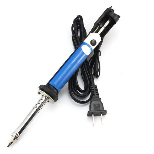

I found this on Ebay. Has anyone used this or something similar? I went to replace a solder sucker that shot across the room in about 3 different directions and found this. It looks it would work nice on our electronic repairs and restorations. Any thoughts either way?
https://www.ebay.com/p/US-Local-Ship-S-9...0005.m1851
Also found this smaller desoldering tool: https://www.ebay.com/itm/30W-Electric-Va...0005.m1851

I don't know what the heck that first dohickey is, but the second is a perfect way to ruin a PCB pad.
Reply
I could see it doing that. Normally I use solder wick on a PC board unless there is some big blob. The 1st is a pistol grip version, like a soldering gun vs a pencil iron. I was thinking it may be nice for those wads of solder we get into on some of these hand wired chassis.

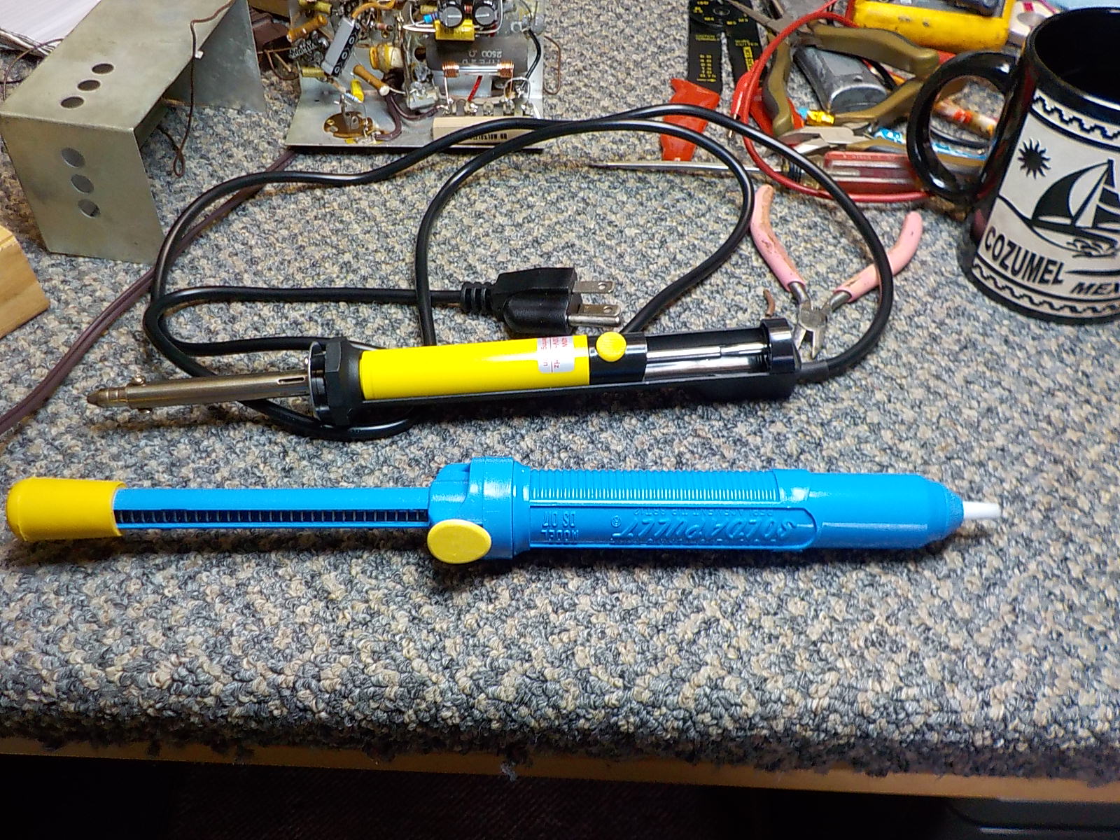

I decided to try a couple of different desoldering tools. I use the Soldapullit most, and the other one occasionally. I used to use an older version the the blue one when I had my shop years ago. Biggest drawback is like trying to unsolder with a telephone pole! It wants to hit stuff when I am working in tight quarters. I have an assortment of different size tips for the electric one. It seems to work ok, but I often have to apply a little fresh solder in order to get heat transfer sufficient to clean the joint. But sometimes I have to do the same with the others. The Soldapullit has a lot more force and works pretty well, but takes 2 hands where the electric one can be done with one hand. I may try something else when the desire hits me again. I have used solder wick, but to me, it works better on PC boards than hand wired connections. I think mine is old and doesn't seem to pick up very well.
