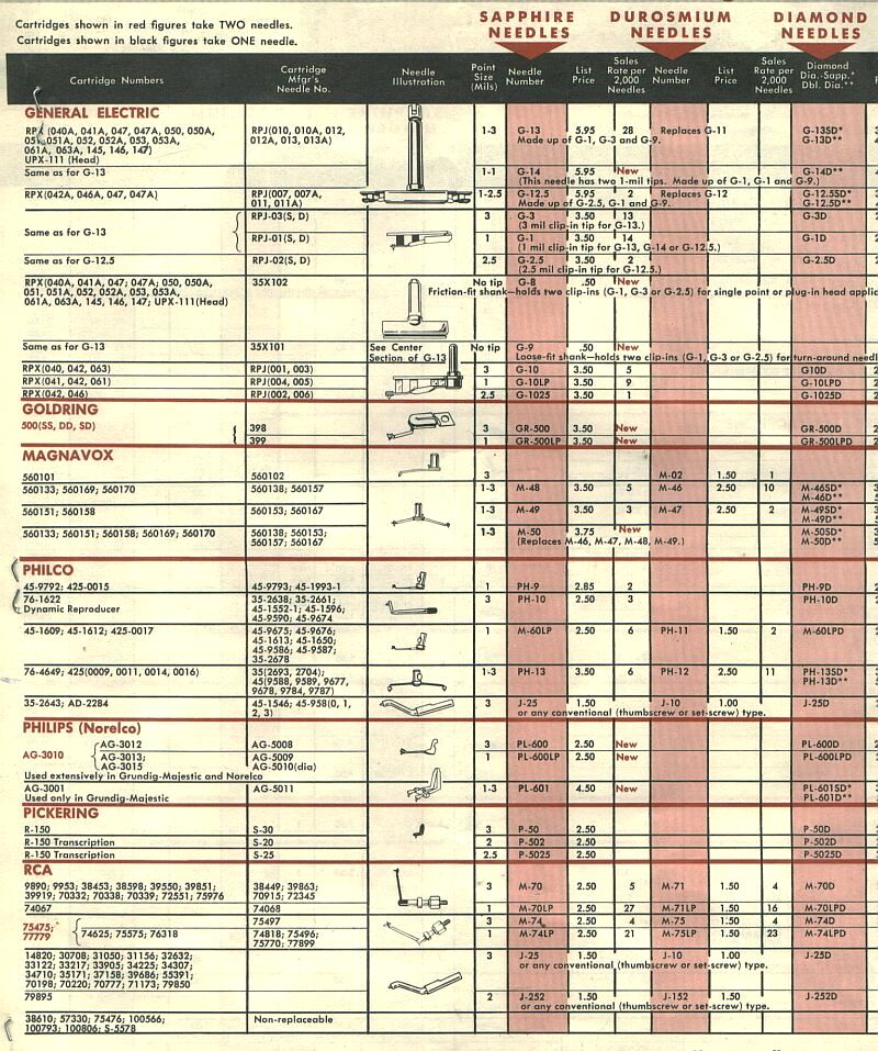

Not sure, but I think the record changer in this set uses the "dynamic" (magnetic) cartridge. If this is the case, and I suspect it is, DO NOT use a regular steel needle, else you may damage the cartridge!
The stylus is a press fit into the cartridge and, you're right, it is a pain to get to. Make a note of how the old stylus is fitted into the cartridge, then, pull the stylus out. Replace it by pushing the new one in so that it is in the same position as the old one.
You can get a replacement from, among others, West-Tech Services:
http://www.west-techservices.com/p5.htm
This picture, accessible if you scroll down that page, shows the very needle you need, for Philco Part No. 76-1622 Dynamic Reproducer.
http://www.west-techservices.com/images/ndldis8.jpg
