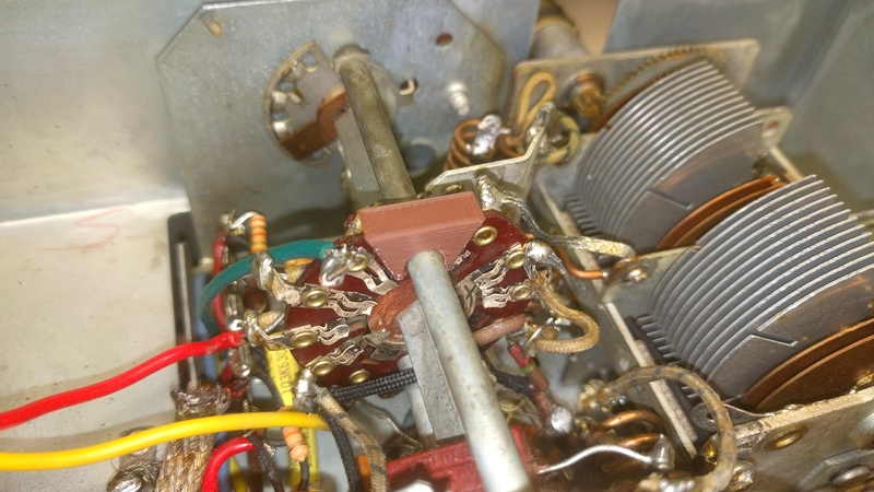

I think I've found a solution to the broken wafer on the function switch:
I designed and printed a reinforcement piece on my 3d printer. I plan to apply a small amount of epoxy to the inside surfaces of the 'legs' of the piece and slide it onto the wafer. I still want to come up with a way to apply a little side to side pressure to close the crack while the epoxy sets up.

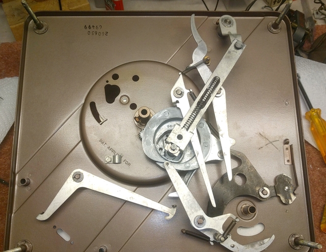

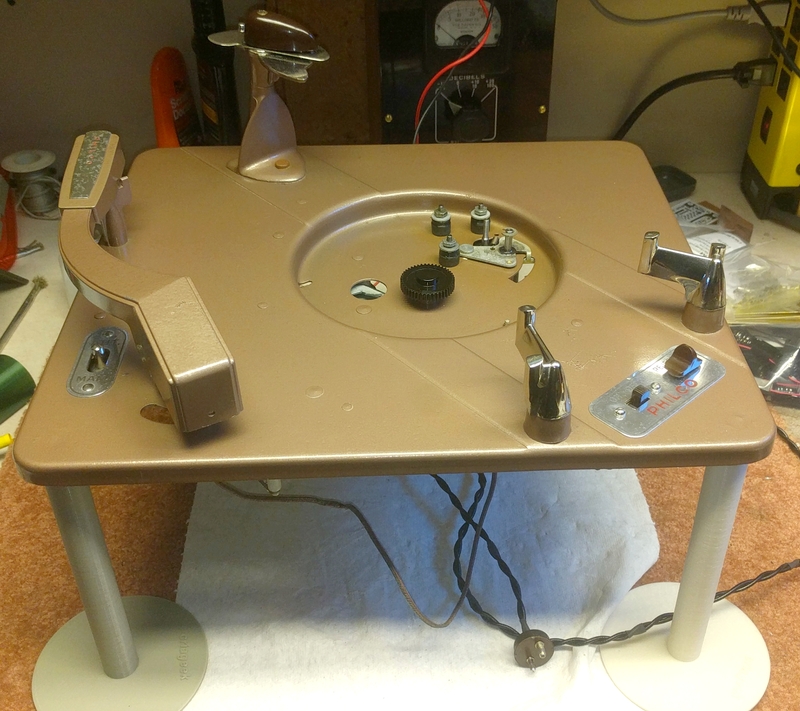

I set the chassis for my 47-1230 aside for awhile while I do some more research to see if I can figure out why the FM doesn't work. So I decided to clean and lubricate the phonograph. All of the grease had dried and hardened so it was necessary to completely remove everything for cleaning. That in itself was difficult...the cam gear and the separator post in particular were extremely difficult to remove. Just a note to others that might be considering doing this but are afraid to do it because it looks complex...it really isn't difficult at all. It's just a bunch of levers and springs. Take your time...take lots of pictures...and keep everything organized. That being said, I don't know how difficult it will be to make sure everything is adjusted correctly, but it doesn't look too tough.
Here are before and after shots. The 'before' picture really doesn't show how grungy it was.

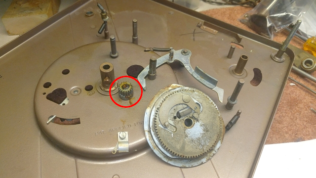

Now for my question. I don't see a way to lubricate the shaft for the pinion gear without taking the gear off. It's held in place on the shaft with a pin. How difficult is it to tap the pin out, remove the gear, lubricate the shaft, replace the gear, and tap the pin back in?

RE: D10A Record Changer Lubrication -
Mutantmoose - 12-20-2018
I've been getting ready to do this myself, and this series of videos (which I'm sure you've seen) really came in handy.
https://www.youtube.com/watch?v=xbC78xI_z5Y&list=PL2wdOqbc4SkuhCOo1t2PUOwOyzNZvIj9A&index=3
That top gear might be plastic, and I would be very reluctant to mess with that. You might just try to wick in some oil instead, and call it a day there. Pressed in pieces are not very forgiving.

criageek - 12-20-2018
Thanks Mutantmoose! Yes, I've followed Michael for a long time and watched that series when he posted it, and have reviewed it recently. He does some great work! But I didn't see anywhere in his series where he lubricated either the metal pinion gear (or the cam gear for that matter) or the shaft it's attached to. The plastic gear on top is connected to the same shaft and I have no intention of trying to take it off. But if the metal gear was removed, the plastic gear would come out with the shaft. I'm wondering how hard it is to remove the pin that holds the metal pinion gear on.

criageek - 12-21-2018

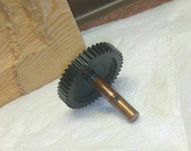

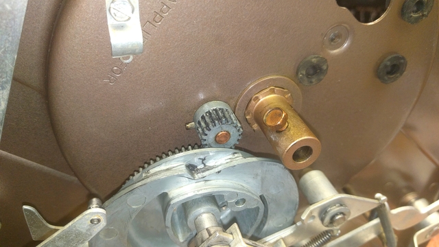

I get to answer my own question. The question was "how hard is it to remove the pin retaining the metal pinion gear"? The answer: NOT! I decided to give it a try so I got out a small punch and tapped on it a bit and was surprised that it moved. It took a good rap, but not excessively. Here it is with the pin part way out
And here is the plastic gear on the other end of the shaft
Now I have another question. Should I use oil on the shaft? Or should I use grease?
Rich
Squire - 12-23-2018
I would just good a good oil like Zoom Spout but you could use a bit of something like phonolube if you have it.
Arran - 12-23-2018
I would use grease on gears, but see if you can find the Philco service info on what to lube, and with what first.
criageek - 12-24-2018
Thanks guys! I know to use grease on gears. I'm wondering what to use on the shaft that the metal pinion gear is attached to. I would post pictures of grease I'm using but my cable and internet have been down since Saturday night and won't be back until Wednesday afternoon...I'm at my Mom's place now (how is it that cable/internet is easily my most expensive utility, yet they are the worst at customer support??). I know I'm using 3-In-1 household oil, but don't remember the brand of grease. Wait...I bought it on Amazon...here it is:
https://www.amazon.com/Sta-Lube-SL3141-Moly-Graph-Pressure-Multi-Purpose/dp/B000CPJMZ2/ref=sr_1_1?ie=UTF8&qid=1545671174&sr=8-1&keywords=Sta-Lube+SL3141
Rich
gregb - 12-24-2018
Anywhere there is a shaft and bushing you should use an oil. In the old days a lite motor oil like 10W or 20W was recommended. The problem with those oils is after many years they get thick and gooey and don't lubricate any more. I have gone with a lite synthetic that is not ever supposed to get gooey but time will be the test of that claim.
Gregb
