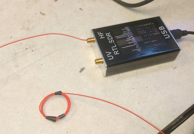

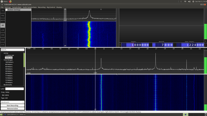

I've been working with my SDR (software defined radio) more and I'm getting more comfortable with it. I don't have the proper SMA adapters yet so I just created a small probe from a piece of wire and made a small coil at the end.
The software for these things allows you to use it as a spectrum analyzer. By inserting the coil near the local oscillator I can see it on the spectrum analyzer display. It works beautifully for AM. But for FM it changes the oscillator frequency when I place the coil near the FM local oscillator coil.
Still, I can see what I think is the local oscillator. It's about where I would expect it to be and moves when I tune the radio. But I also see a signal that's about the same strength as what I think is the local oscillator, but it moves in the opposite direction! So when I tune up the dial, this signal changes to a lower frequency...odd.
My thinking is that the local oscillator is running, but it's weak. I'll keep researching. Thanks for any and all help!

If you could show a picture of your computer screen with the results. I've never seen one of those and am interested in getting one if it would help with my troubleshooting. Lord knows I need it!!
RE: My 47-1230 Restoration -
criageek - 02-09-2019
Here you go:
The spike in the center spectrum display that is just under 1.7MHz is the AM local oscillator.

You can see that it starts at about 980kHz, which would mean the radio is tuned to 525kHz, and ends at about 2150kHz, which would mean the radio is tuned to 1695kHz.
I wanted to also record the FM local oscillator, but of course I couldn't get it to display on the SDR. I swear, this thing acts different every time I work on it!

Thank You Rich It obviously tells you the oscillator is working but what else does it tell you?

Hi Dick - Right now that's all it tells me...I'm just trying to learn myself! It tells me that it's running, and at what frequency it's running (assuming the SDR display is accurate). The SDR was not created for this purpose but I think it can be useful.
