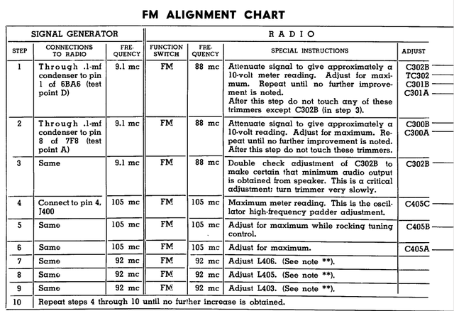

Your misalignment problem on FM may be caused by the IF frequency for FM being off. AM IF is 455KHZ, FM is 9.1MHZ. Use the chart on pages 19-83,84 of the Riders Manual for the set. Follow the directions EXACTLY. This should help with this problem. I own a 48-482, which has very similar circuitry.

Thanks mikethedruid - I did align it at 455kHz for AM and 9.1MHz for FM, so I don't think that's the problem. I've gotten quite good at installing and uninstalling the chassis from the cabinet, so perhaps I'll do it one more time just to be sure. Actually I think the problem may be steps 7, 8, and 9 of the FM alignment procedure, since they are performed at the lower end of the band.

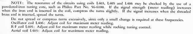

I don't have Philco #56-6100 so I don't know how to do these steps. I did fiddle with the oscillator coil a bit when I was troubleshooting so perhaps it is off, but I don't know how to do these steps without the proper tool.

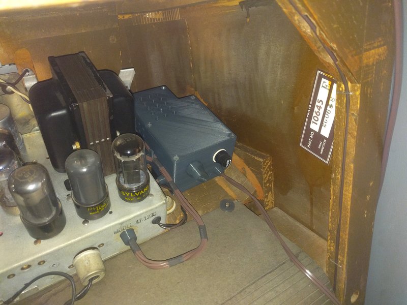

One thing I'll point out here is that the power transformer gets very hot in both that I did, so in both cases I installed an external bucking transformer with a switch on it to switch between full power, full power minus 8v, and full power minus 16v. I've got both set to minus 14v (106v in my case) and they play fine and the transformer doesn't get quite as hot. I printed the case for it using my 3D printer and found a way to mount it that didn't require any drilling. I'd be glad to pint one up for you if you want to do that. I wired both of mine so that the bucking transformer gets it's power from the radio's power switch so the wiring is a bit clumsy.

Hi Mars - Now that I give it more thought I realize the design of my bucking transformer is pretty specialized for my needs and probably wouldn't work as-is for someone else. That being said, if we can zero in on your requirements and parts to be used I can easily modify the design for your needs. For the 3 prong power cord I could design in an opening for one of these:
As for ideas to keep the transformer from warming when idle, I could only think of two other ideas:
1) Unplug the radio when not in use.
2) Install a switch in the bucking transformer case and use it as the power switch for the radio.
I didn't like either of these ideas so I went the route of going through the radio's power switch. But it would be easy enough to include a switch in the bucking transformer if you wanted to go that way.

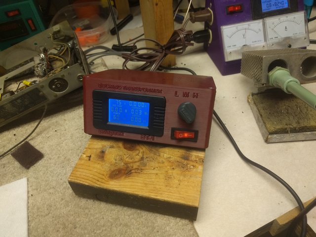

I love doing this kind of thing so don't hesitate if you want me to get one designed and printed. Here's one I built to use as a stand-alone unit. Some radios don't have room for either a bucking transformer or a voltage dropping resistor, so I can plug them into this (there is an outlet on the back) when I want to play them.
Rich

Rich, That external transformer looks pretty cool.
I think if I am to add a bucking transformer, I'd too want it to be used only when the radio is on. I don't know where I'd put a switch on the transformer that would still be handy...

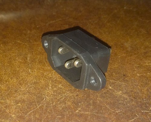

So... How did you do? You have two wires from the switch going to the enclosure, then the power cable going into the radio? Like, you completely bypass the original power cable?
Using this standardized connector would be a great addition IMHO.

I agree...adding a power switch to the bucking transformer would be easy enough, but you'd have to reach around and into the back of the cabinet to use it. Not too handy.

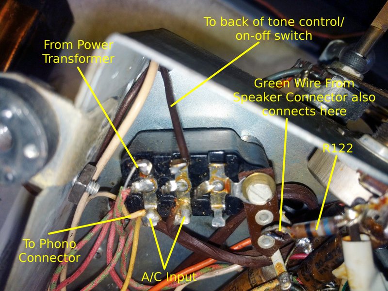

I attached a drawing of my wiring. I know it will be hard to follow so I'll try to explain it. The AC line comes into the bucking transformer (BT) (I'll use the term "bucking transformer" or "BT" to refer to the case containing the actual transformer, switch, fuse, and terminal strip). The hot lead goes through a fuse then out of the BT , through a connector (I installed a connector so I could remove the BT and the radio chassis separately...just easier to manage) and into the radio. It terminates at the center terminal of the bakelite capacitor. The other end of this terminal has a wire going to the power switch. The other wire on the switch originally went to pin 7 of the 5Y3 rectifier. I moved it to pin 3 of the 5Y3 which was unused. Then I added a wire to pin 3 of the 5Y3 that runs back out of the radio, back through the connector, and into the BT to provide switched power to the BT. Then the reduced voltage (both hot and neutral) from the BT is fed back out of the BT, through the connector and into the radio. The hot lead connects to pin 7 of the 5Y3 (which also has a wire to the power transformer on it), and the neutral lead goes to the other cap in the bakelite block.
If you wanted to use a 3 wire power cord, you'd have to run the 3rd wire (ground) from the BT and into the radio as well. So would have a total of 5 wires running between the BT and the radio. I printed the grommet for the wires going into the back of the radio chassis. It's sized for the particular wire I used so would have to be adjusted for not only the wire you use, but also for the 5th wire.
Make sense? Let me know if you have questions ;)

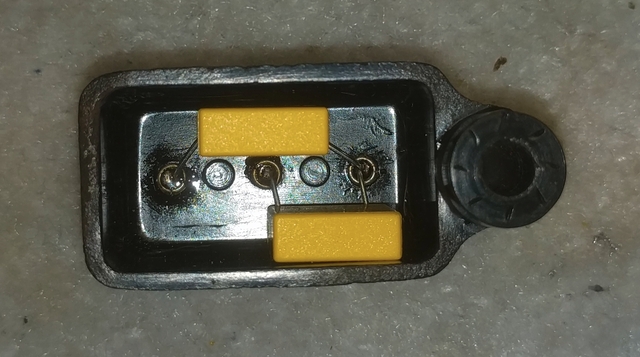

When you talk about the terminal strip of the bake lite capacitors, you're talking about C100 and C101?
Did you change those?
I got safety capacitors years ago but never did the change. It is deamed much safer and up to code to use that instead of 1940s line filter caps...

Yep, C100 and C101...I restuffed the bakelite block with safety caps:
