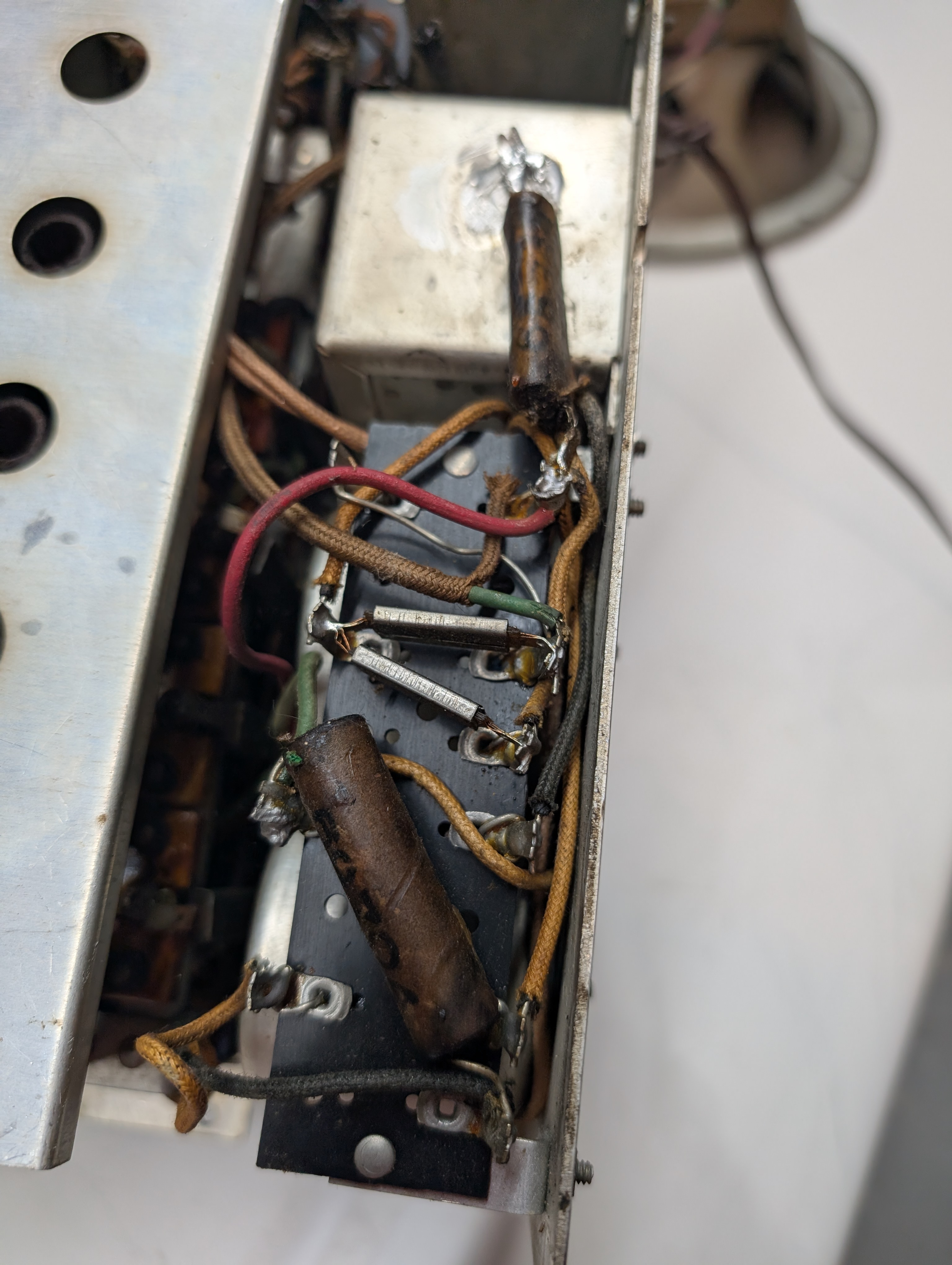

Plus the resistor board service. Or a resistor board. there ar e two. This is the one right over the IF cans, at the back wall of the chassis.
The 1M resistors being 1.2M, I am OK with it.
400 Ohm cathode resistor being 560 Ohm and 60k being 86K...I am not Ok with it. Since that much drift occurred over 90 years, I simply paralleled the resistors to bring it under compliance. Was not easy. Cut some wires, inverted the board.

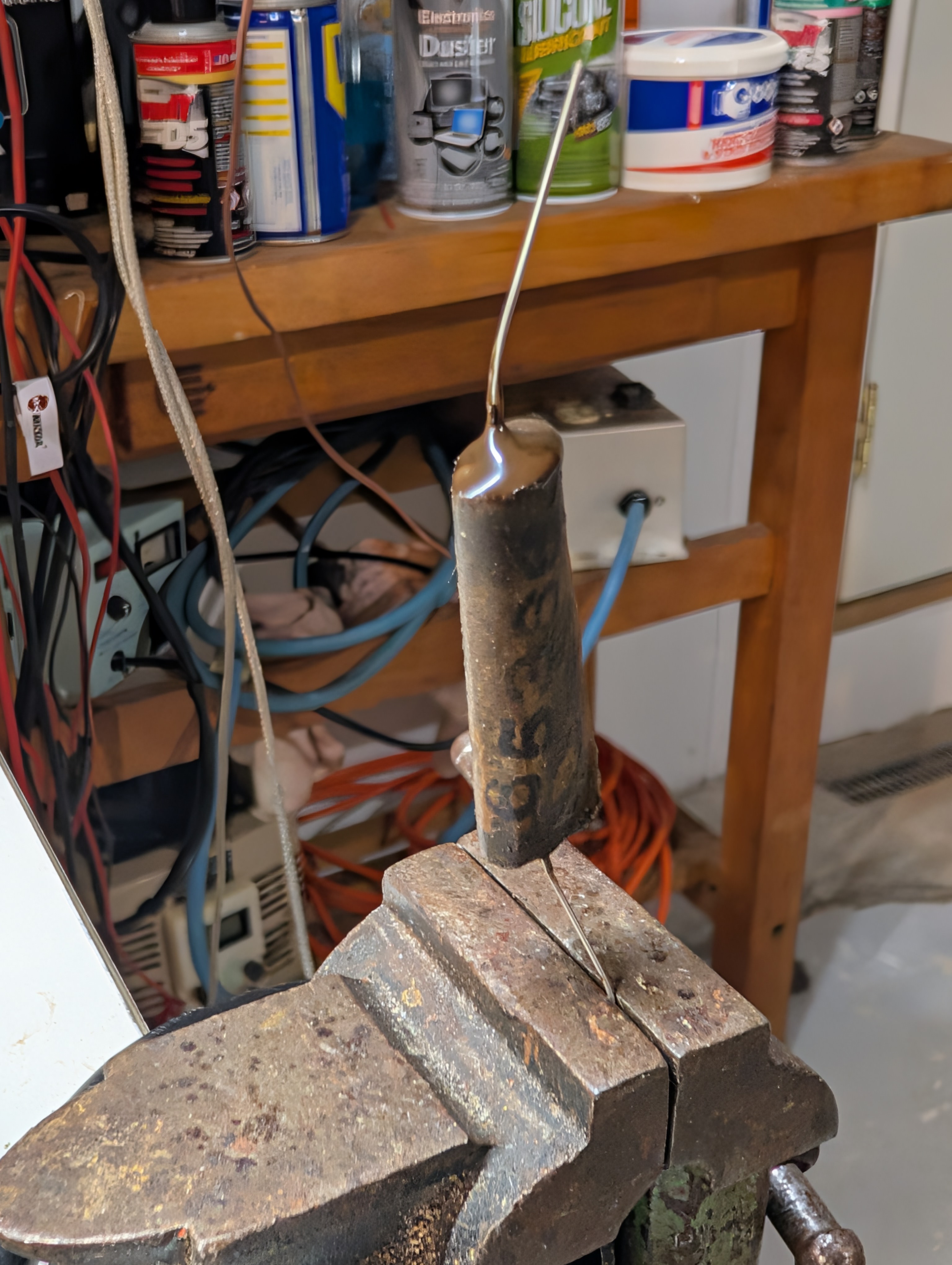

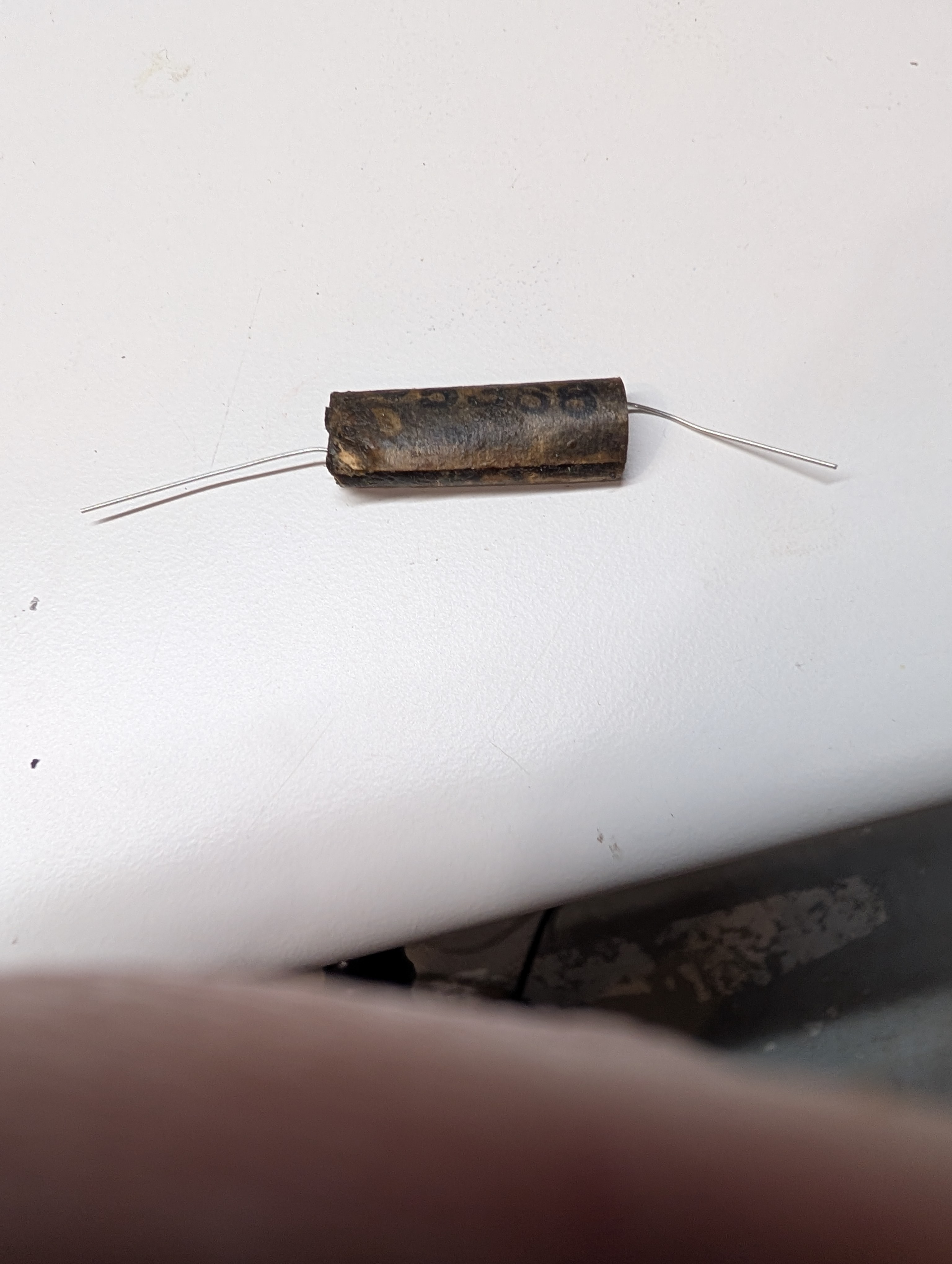

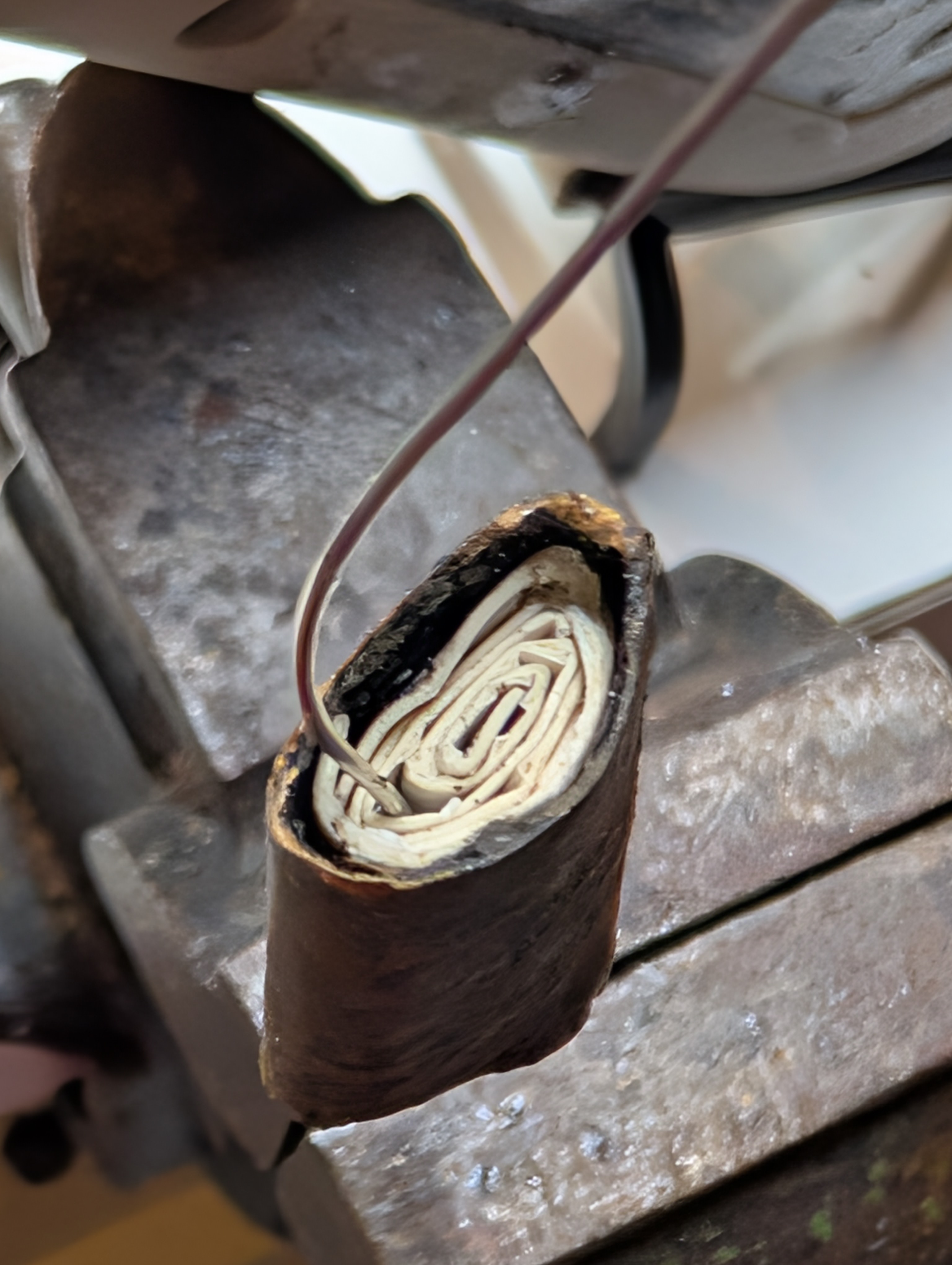

Then the caps. The caps are thin-shelled and the wax is actually tar.
The second cap was 2,400 uuF, and upon checking it was 2,600 uuF so I was tempted to leave it in. But then I desoldered the second lead (those were two foil strips) and the value rose to 4,200 uuF, so I ended up not breaking my own rules. This cap was literally one layer of paper wrapped around the tarred innards, plus it is a mishapen flat type, not the tubular.
I was able to gut it.

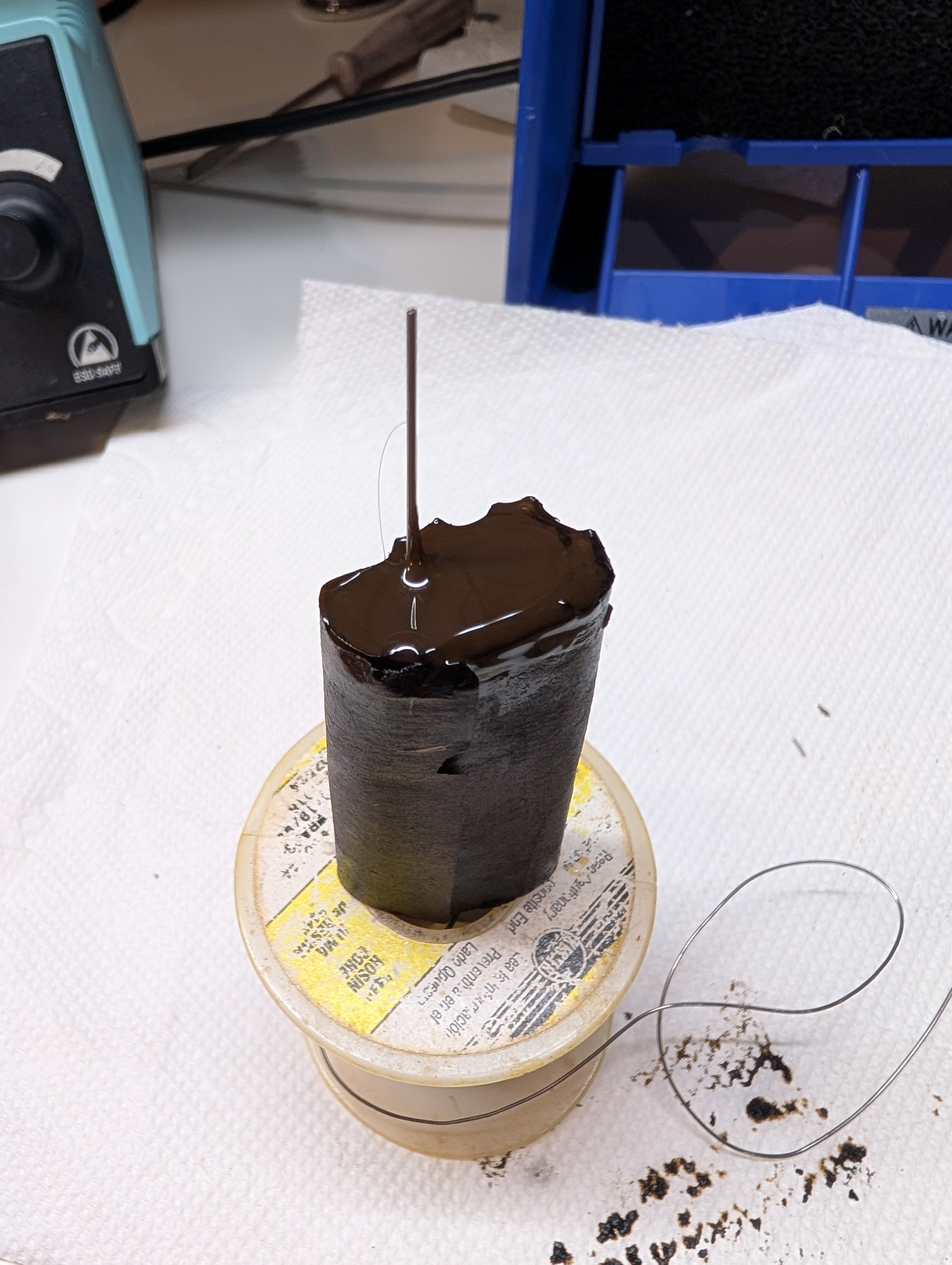

And then I had to fold the filler paper strip (the one I put between the hot glue and the cap) instead of simply rolling it. Like so.

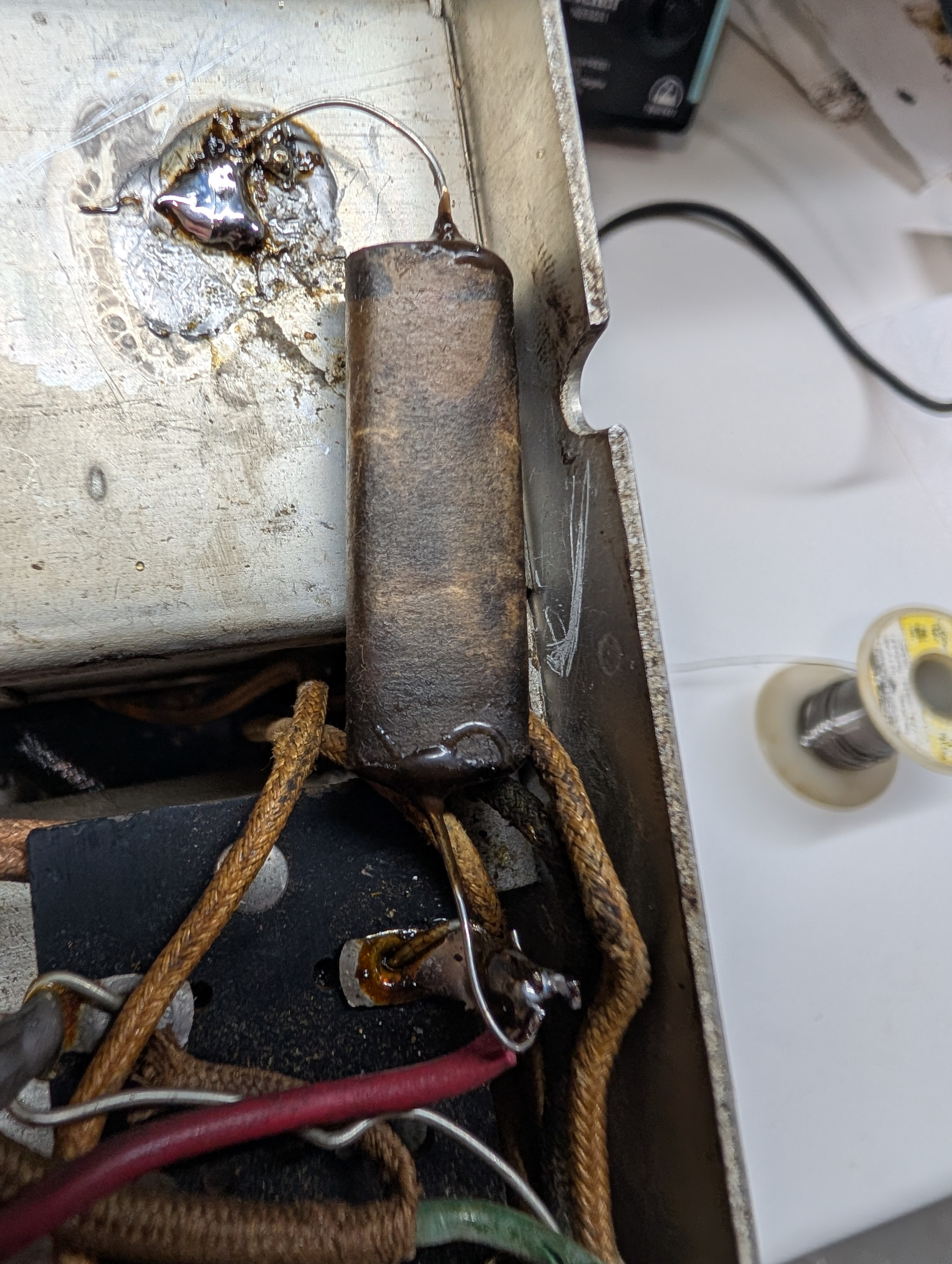

The result is this.
In citu

Wow, I’ve never seen a flat cardboard capacitor! Did you fill the ends with hot glue?
I melt beeswax and add color to it when I heat it up.
So, for the resistors, you paralleled some together to bring the value down to the correct level, right?
RE: Starting on an RCA140 - morzh - 05-30-2026
Rich
Yes. 560 ohm and 2.2K give about 440 ohm which is close to where I need to be (400 ohm).
86K and 200K give 60K which is what I need (I have a bunch of new carbon resistors, and their tolerance is all over the place, so on of the 220K bunch was 200K which was exactly what I wanted).
I hotglue my caps' ends with chockolate-brown glue. I used to re-use the wax, but it never gripped right. Hotglue grips well and seals well too.

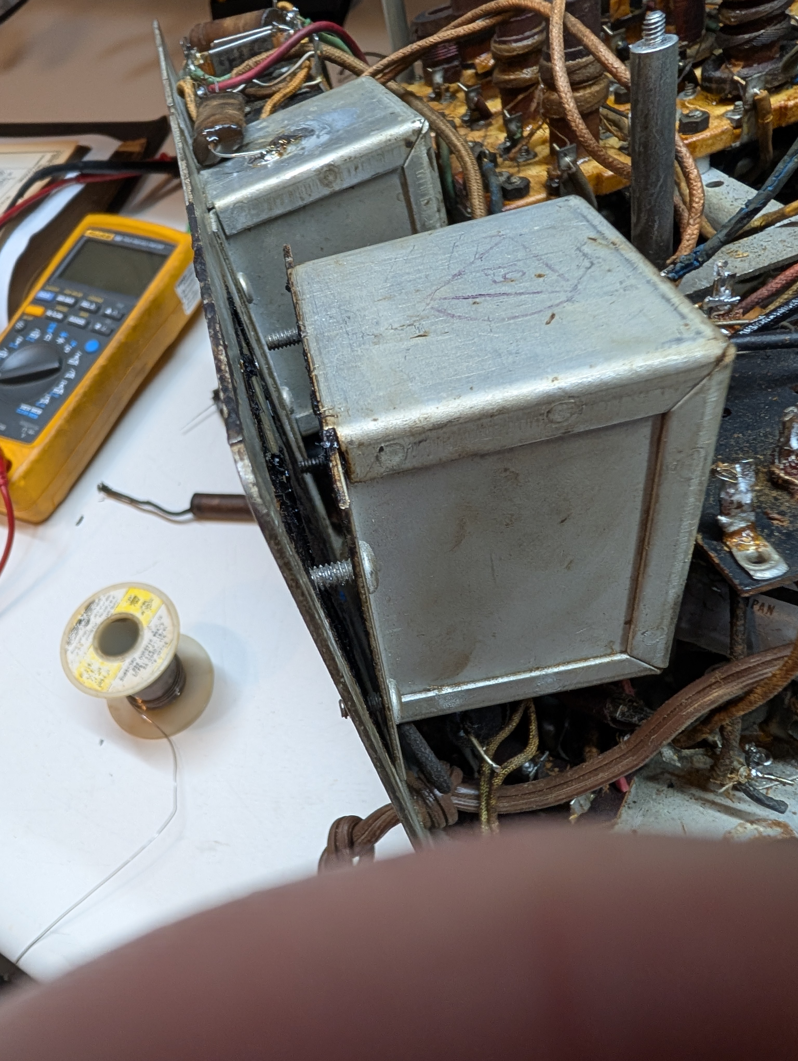

RE: Starting on an RCA140 - morzh - 05-31-2026

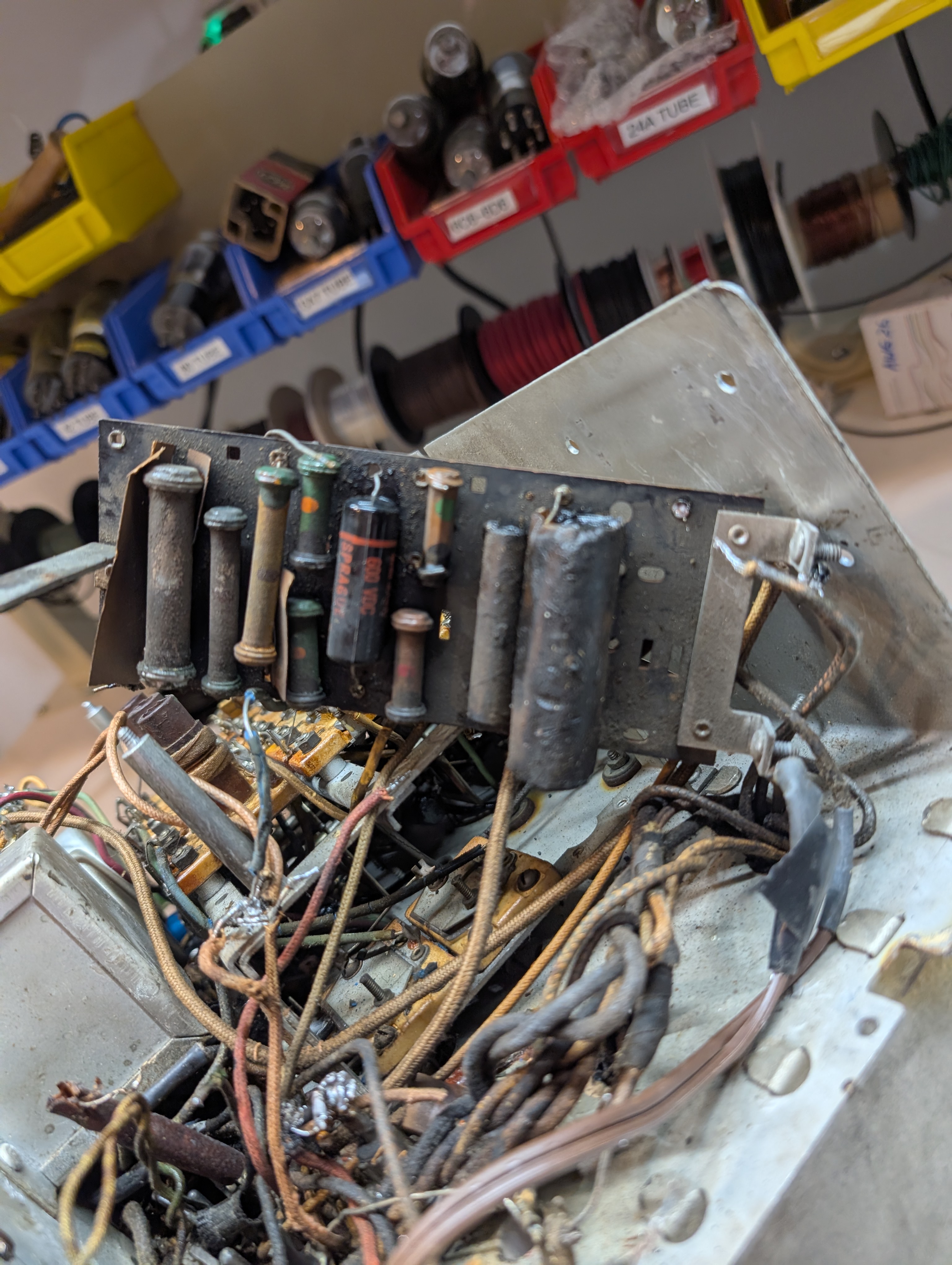

Continuing with the Resistor Board #2.
It has to be removed to be serviced.
It has three points of attachment, two at the front panel and one vertical.
Also many, many wires holdingit down.
Detached the wires, took tons of photos, though I do not see how those are going to work without tracing with the diagram.

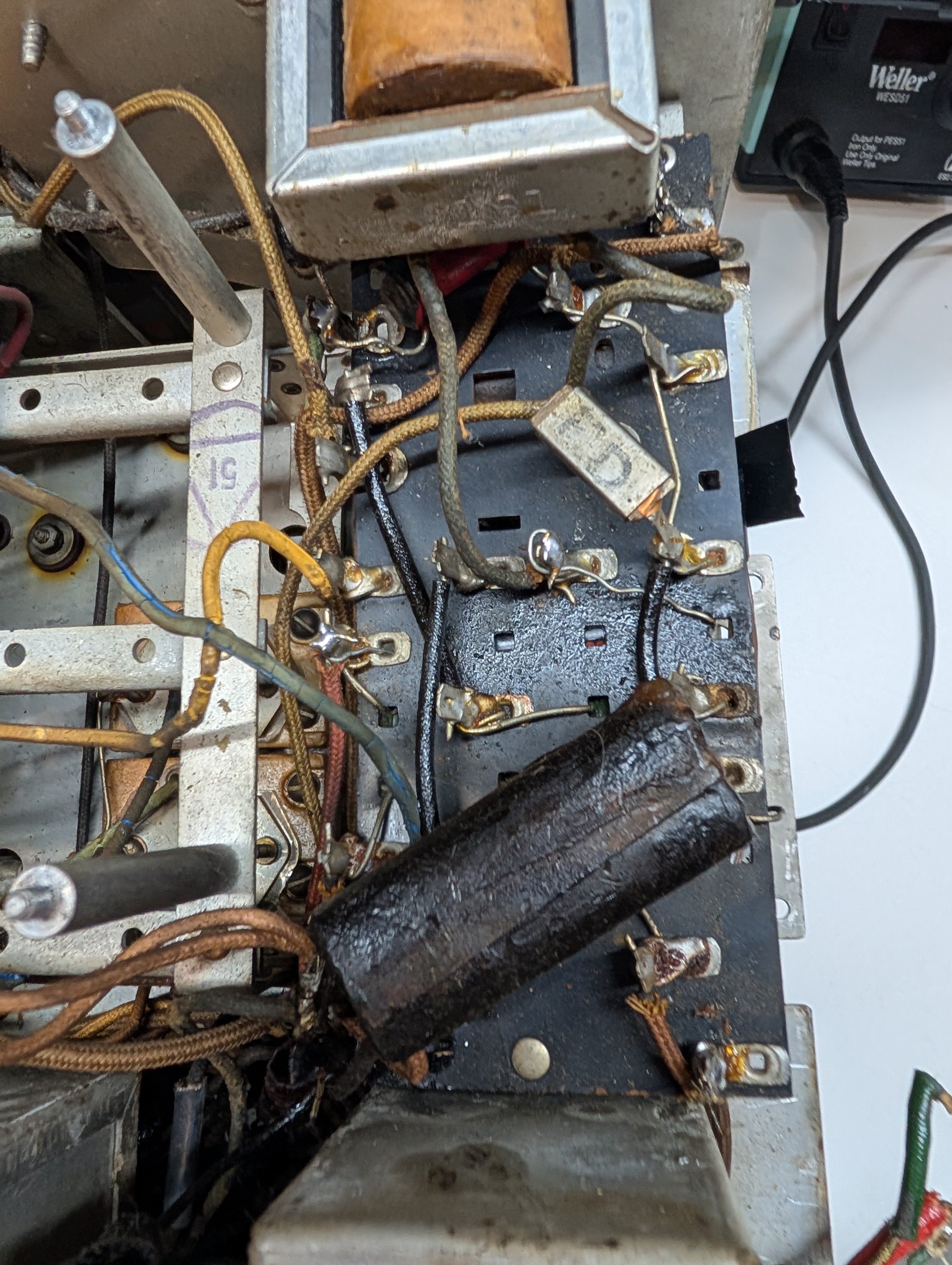

In order to remove the board I had to remove the filter choke that kept the board from moving. It in itself was an adventure, as the choke had to move forward towards the board, with the gap between them some like 1/16". I flexed the back wall to which it was attached, but the screws (4) always tried to get back in their respective holes, so I eventually pulled two of them and inserted a hacksaw blade under them, to stop from going into the holes.
Whew.
Eventually pulled out the board.

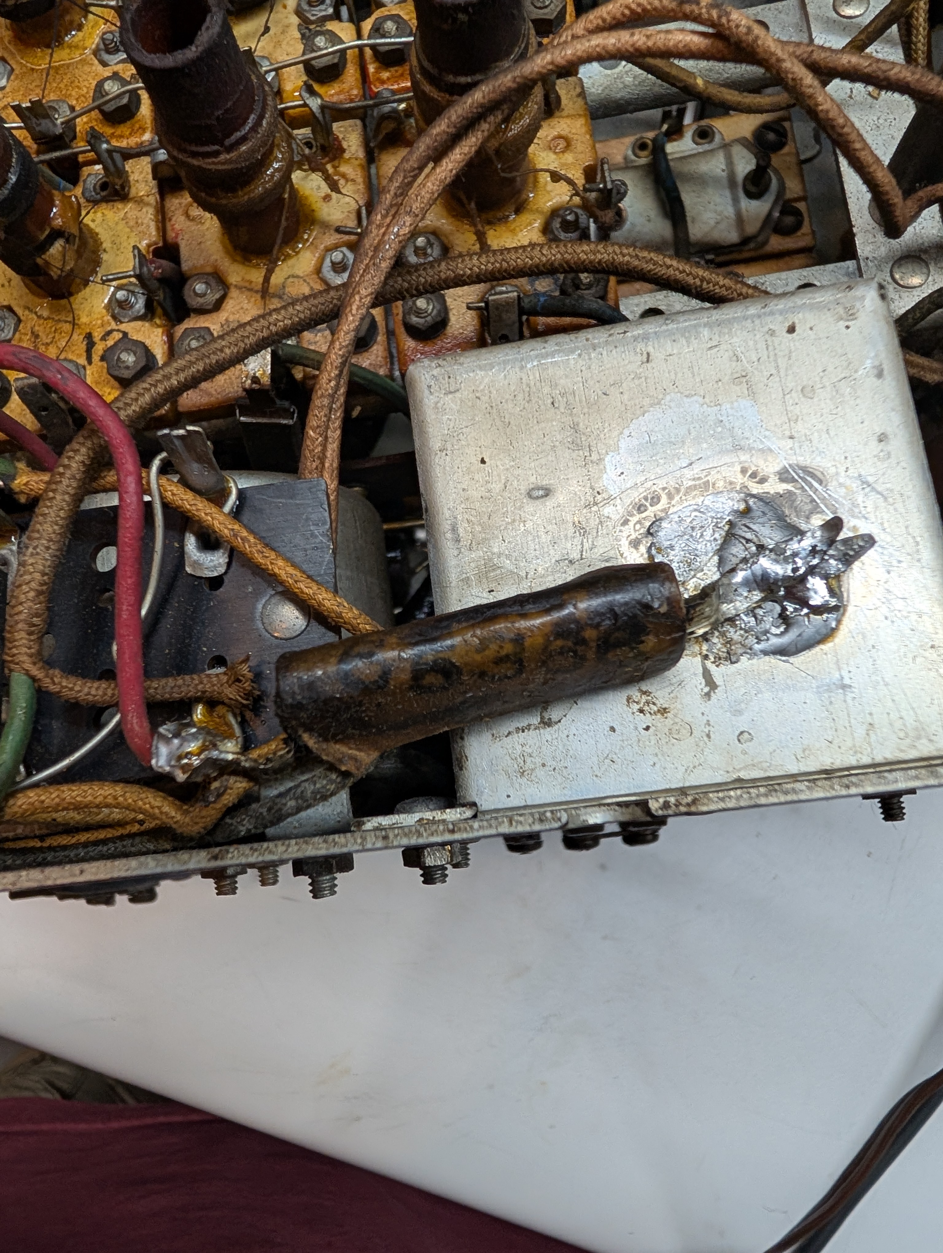

This is the mess under it.

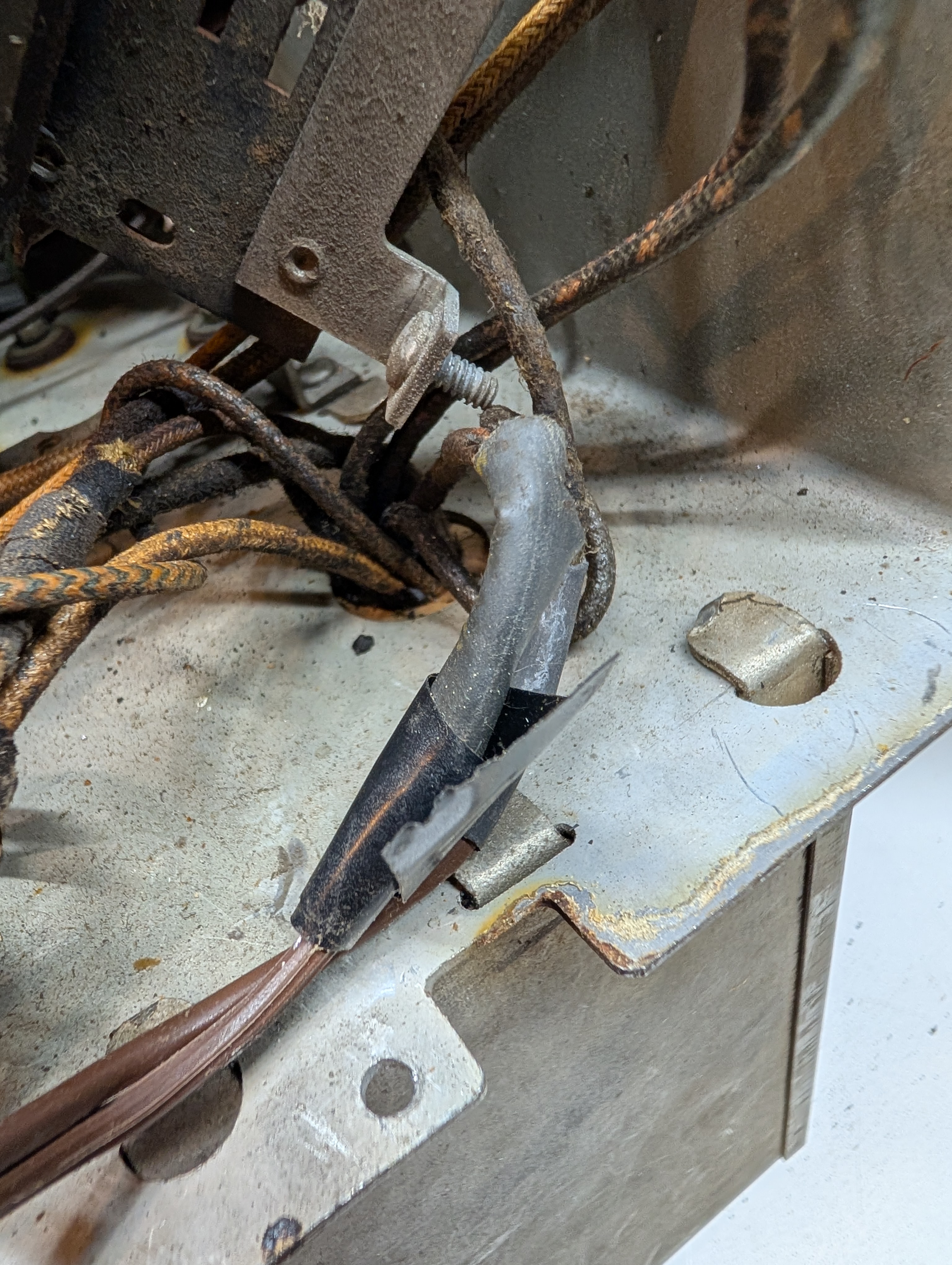

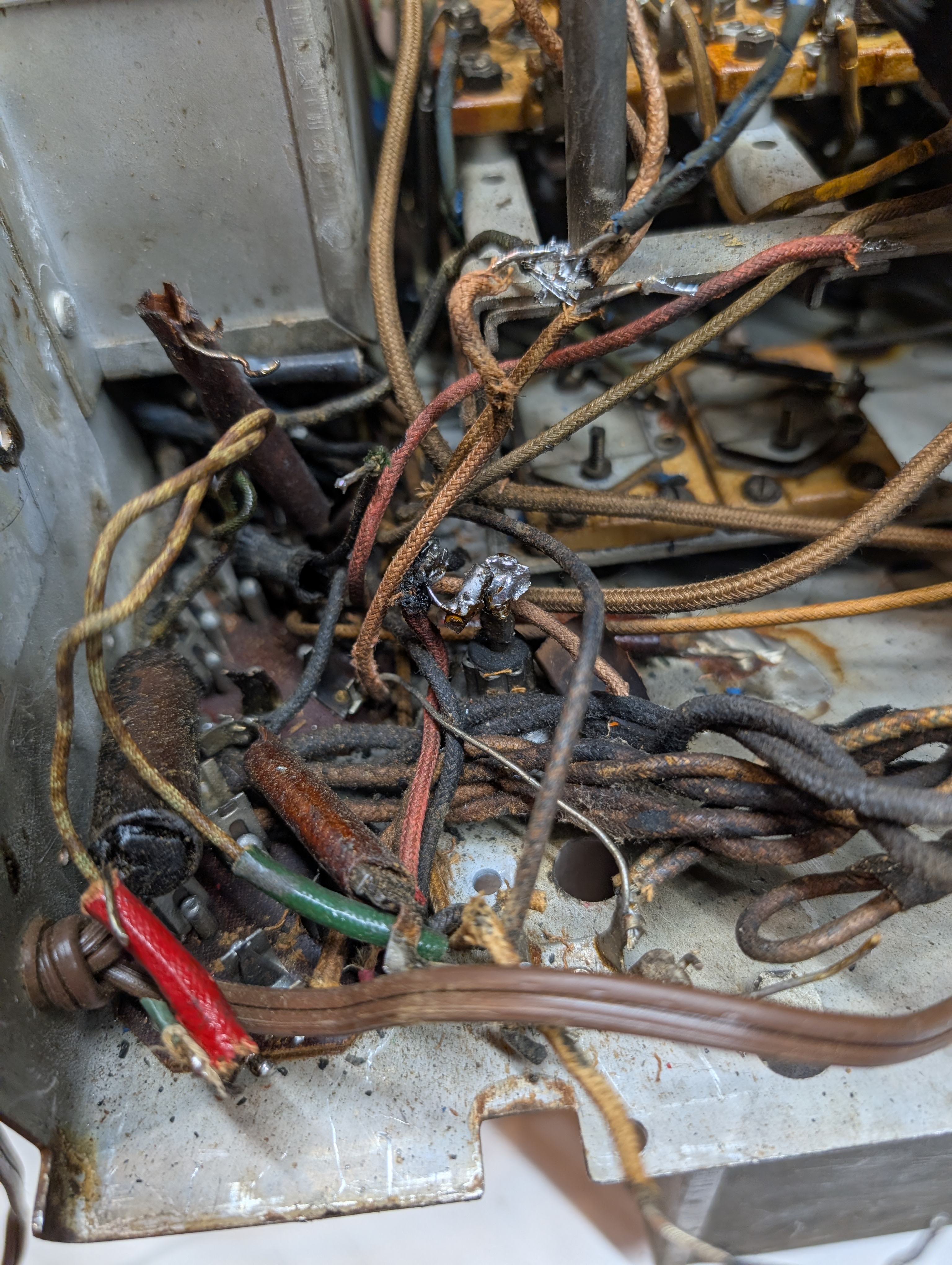

This is the way it was "repaired" before. Black tape etc.

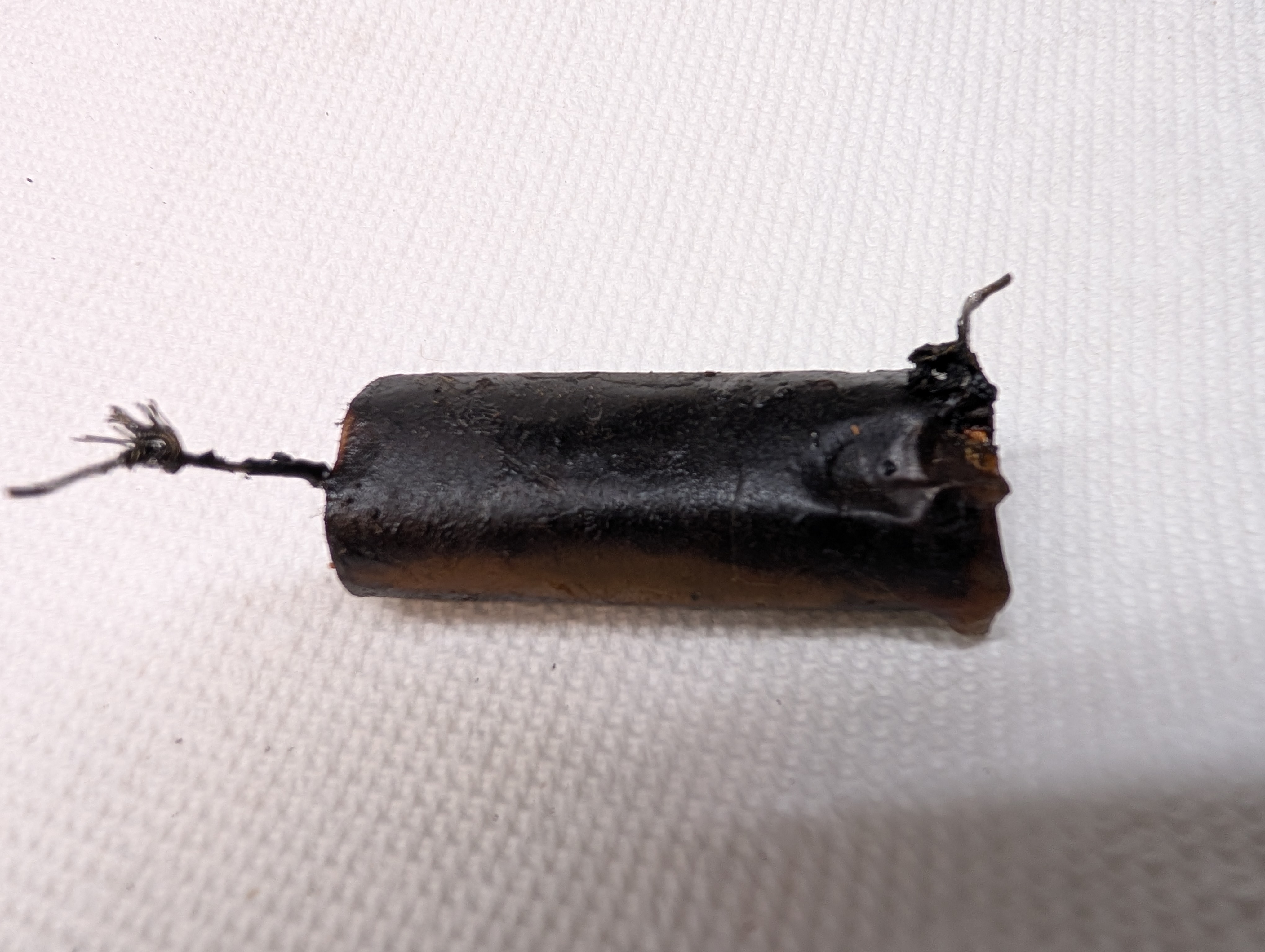

This is another "flat" cap restuffed.
A few (not many) wires have rubber insulation. A couple are shielded (yes, shielded rubber wire).
Will have to go.

RE: Starting on an RCA140 - Joe Rossi - 06-01-2026
Mike,  What a mess! Icon_crazy  Do you think that was the way RCA "engineered" the radio or the result of previous attempts to fix it?  Be strong!  Joe
RE: Starting on an RCA140 - morzh - 06-01-2026
Rich
Yes, got on Amazon. Plain brown hot glue.
Joe
I suspect at least part of it was RCA's doing. Some was the result of the previous person(s) attempts to repair, but you can see that the wires are originals, and the caps are mostly original (they replaced two electrolytics), and the cord was probably changed, so the extent of the repairs was not that ...extensive.
I'll be able to assess it more accurately when I get to the 2nd and 3rd radios I have (another 140 and GE K-85).
