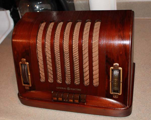

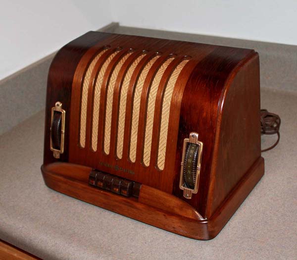

RE: Refinishing a Radio - Jamie - 09-18-2013
We started with this....and
Here it is... all finished. Grill cloth came today.. I think it looks a lot better now.
RE: Refinishing a Radio - Geoff - 09-18-2013
Wow, looks great! Excellent work!!!
- Geoff
RE: Refinishing a Radio - EricS - 09-18-2013
What a little beauty! I like the increased definition in the wood.
RE: Refinishing a Radio - KCMike - 09-18-2013
Great job! Another learning thread that gives me confidence to try cabinet restoration.
