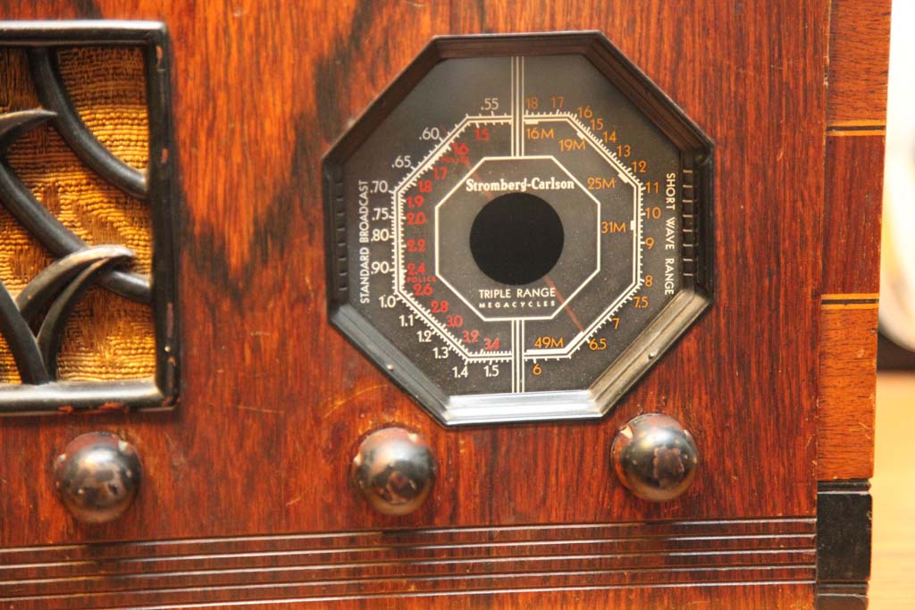

The only thing I do not get is this: once the tubes warm up and the dial lights get dimmer which they should, I stop seeing the arrow (which is the semi-transparent strip in otherwise black rotating disk. And the dial itself in not lighted too well, I can only see it in a total dark. And I am not sure why as the lamp sockets, they only fit one way and all three of them are installed and all three lamps are on. A minor thing......but I'd like to see the dial.

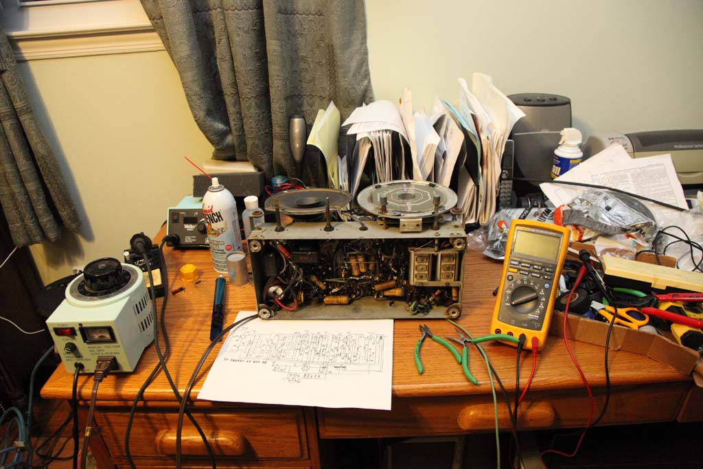

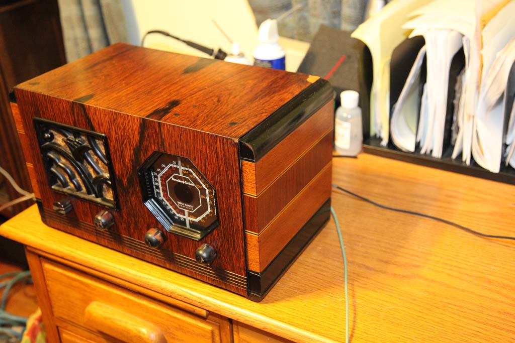

Some pics

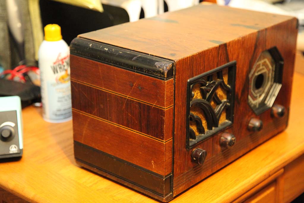

This is the way I got it.

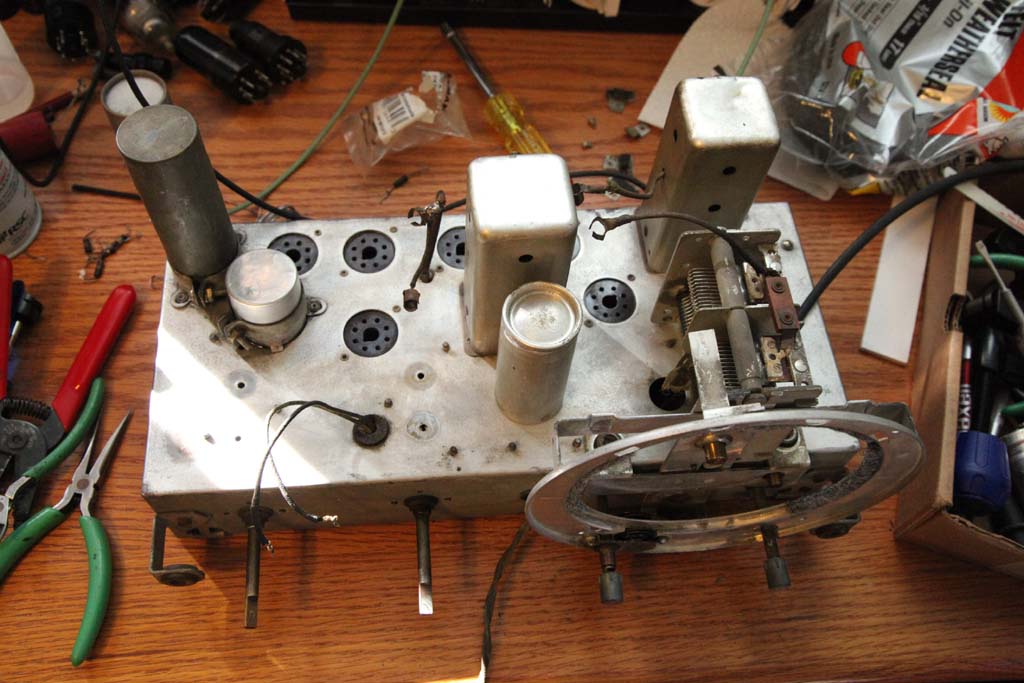

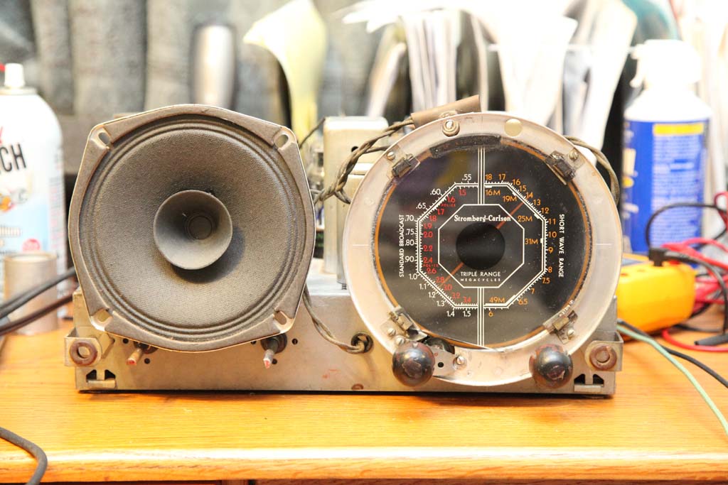

RE: Stromberg-Carlson 225-H - morzh - 11-23-2013

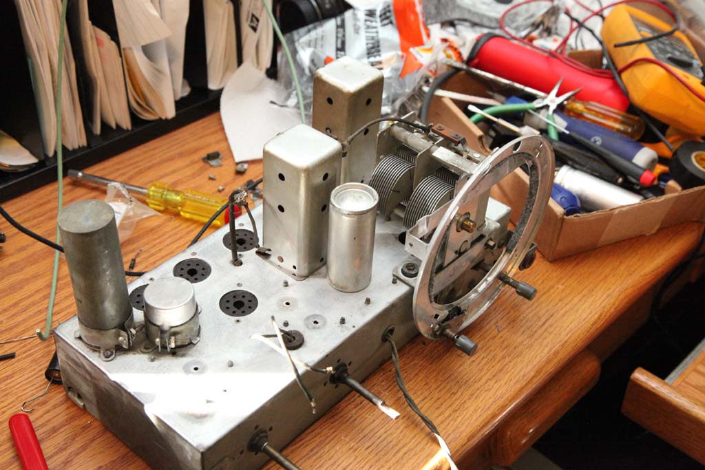

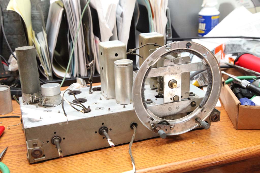

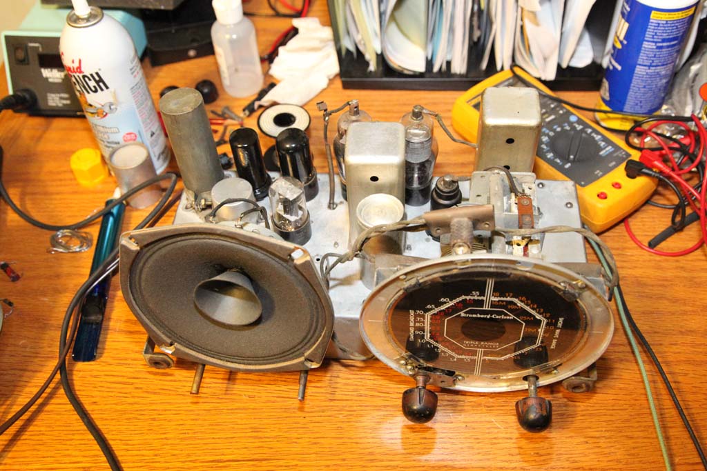

Now the chassis after some cleaning.

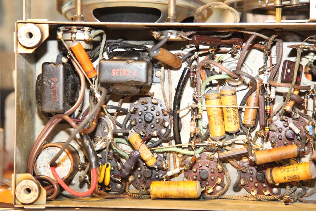

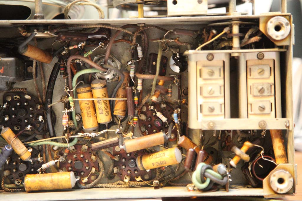

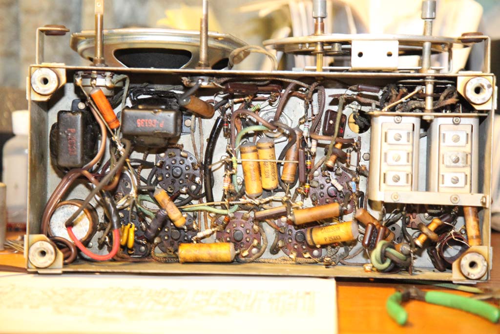

Underbelly.
With speaker.

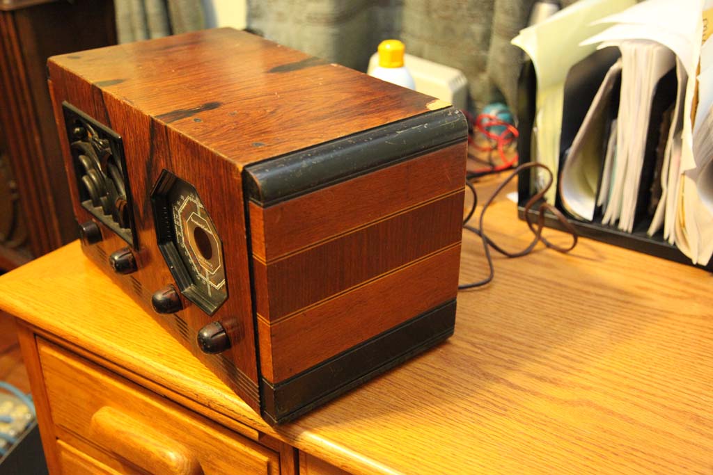

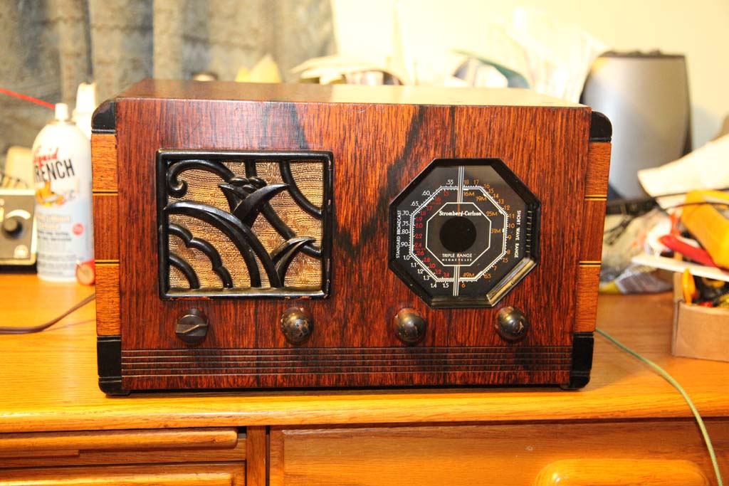

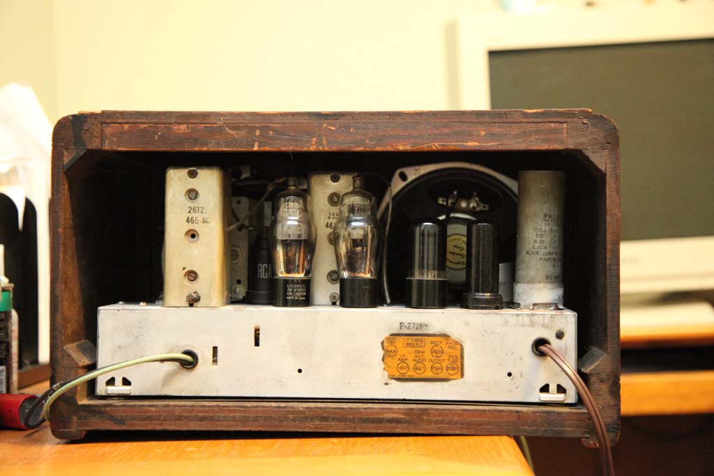

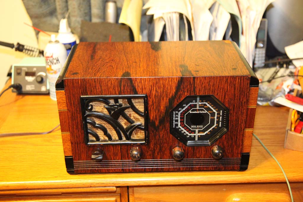

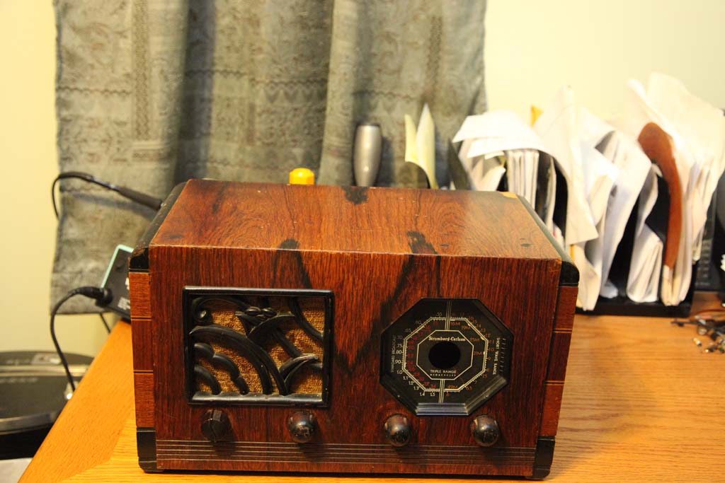

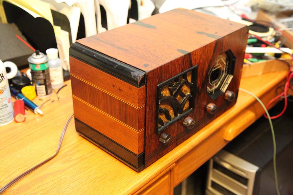

Assembled.
I used some GoJo, nothing else. Will need at some point to repair that missing piece of veneer on top.

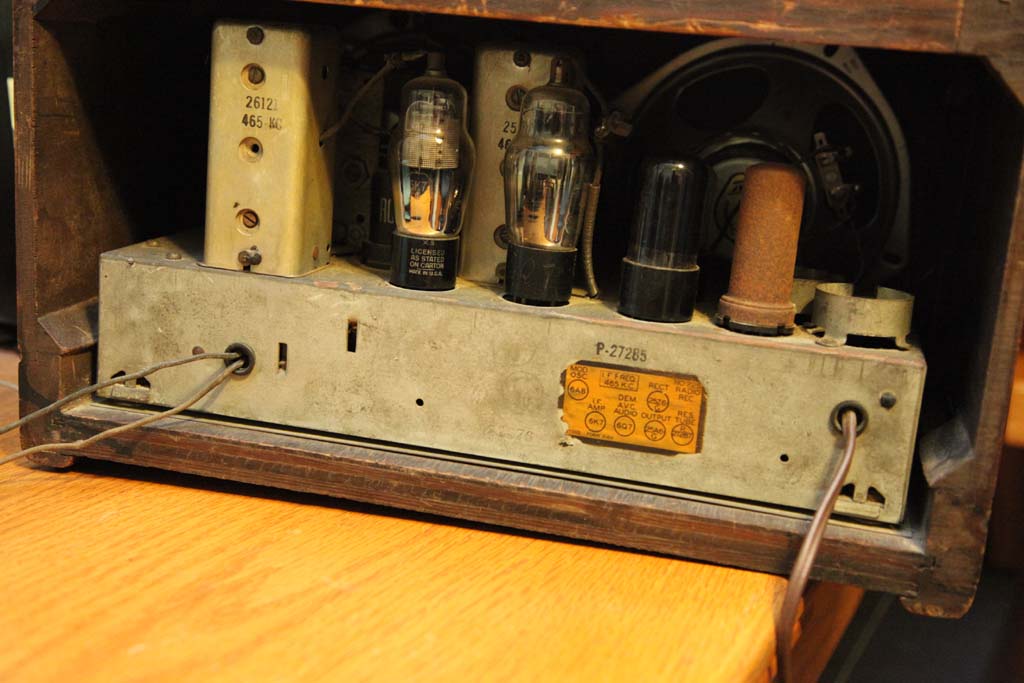

Just have noticed: need to rotate that cap on the right, otherwise it says "Philco".
Special thanks to PouhPow for the can caps.
RE: Stromberg-Carlson 225-H - jerryhawthorne - 11-23-2013
Mike a really nice job on that chassis top, looks like new.
Jerry
Thanks Jerry,
Naval Jelly did the trick. Windex only took off the loose part, but then there is that embedded part that even alcohol barely was able to take off and some pitting was still left, and while tending to the rusty spot I noticed how nice the metal around it looked when I rubbed it a little so I took a small portion of the Jelly and cleaned the parts where the other cleaners did not work. Then washed it with alcohol moistened paper towels.
Mike.
RE: Stromberg-Carlson 225-H - Arran - 11-27-2013
I think that the bulk of the cabinet, including the top, is covered with a species of Rosewood veneer, possibly Kingwood. I don't know where you would find a scrap of it to patch the chipped area though.
