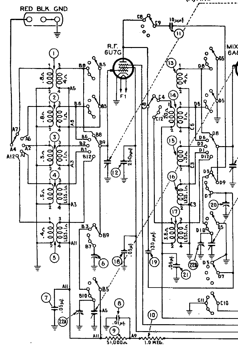

RGK20m3, You asked, "I don’t see how the 38-690 antenna input is balanced; although it has the 3 terminals (red, black, and ground), the black and ground are connected together and are connected to chassis ground. This is how my unit is wired, and is confirmed on the schematic." If you look at the schematic for these radios...
[Image:
https://64.media.tumblr.com/defa8727b5eeae20cbe42a6a4e6fff43/88aec1604f2039ea-55/s250x400/7f53c5824878009a24fa57d8fb86635d30a70b99.jpg]
You will notice that the connection between the black and ground is REMOVABLE. It is a metal link between the black and ground terminals on the terminal strip on the back of the chassis. This hook up is the way it is used for a single ended (long wire) type antenna. This is OPENED, detached from the black lead so that the dipole antenna goes to both ends of the primary winding of the first antenna coil when connecting to a dipole antenna. In this form, I believe the link is switched to between the ground terminal and the number 4 terminal which is connected to the center tap of the first antenna coil. Don't let the switches throw you. Look carefully at the schematic and you will see what I mean. This is a 2 band radio, so it uses two antenna coils, one for each band, and switches between them. So, YES, the dipole antenna IS balanced. There ARE unbalanced dipoles, where one leg is longer than the other to make them better at receiving on different frequencies, but this relates solely to the construction of the antenna itself, and is not what we see here.

On my 38-690, the link between the black and ground terminals is a soldered wire inside the chassis; I believe this to be factory, as it is a continuous cloth covered wire from the 2 lugs to the RF sub chassis tab. From the tab there is an identical wire bonding the RF sub chassis to the main chassis.
Of course, it could have been changed at any point in the last 85 years. I do see how the antenna coil could provide a balanced input, but seems would create an issue as there is no ground reference on the circuit. Most I have seen have the coil center tapped.
Per my above post, at least one of the Philco dipole kits has a “transformer” at the mid point, and the literature for that kit (Philco Library), instructs an additional ground to this transformer if there are interference issues. The photo link that I posted shows what appears to be a balun/ transformer included in the kit. Perhaps actually an balanced to balanced matching transformer?
Not trying to argue, just trying to understand. Incidentally, that schematic you provided does not match the 38-690 schematic.

Here is the front end of the 38-690 - the 38-116 Code 125 front end is identical:
The link Chas posted in post #25, page 2, this thread shows (about halfway down the page) one side of the dipoles being grounded. This would also be the case with the 38-690 and 38-116 Code 125. In fact, if you study many of the
schematics of 1938 Philco models, you will find that models 38-1, 38-2, 38-3, 38-4, 38-7, 38-8, 38-9, and 38-10 have similar front ends, all of which were advertised as being "designed for the Philco High Efficiency Aerial".

Looking at the schematic posted, using a dipole on this circuit, with the black terminal permanently connected to CHASSIS ground, would only make sense if, when using a dipole, the chassis was NOT EARTH grounded, but allowed to float, in which case the antenna would be balanced. If earth ground were also connected to the GND terminal, it would defeat the whole purpose of 1/2 the dipole and turn it into a long wire half the length of the whole antenna. Perhaps careful study and reading from the various parts of an actual antenna would help answer these questions.

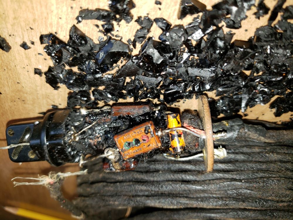

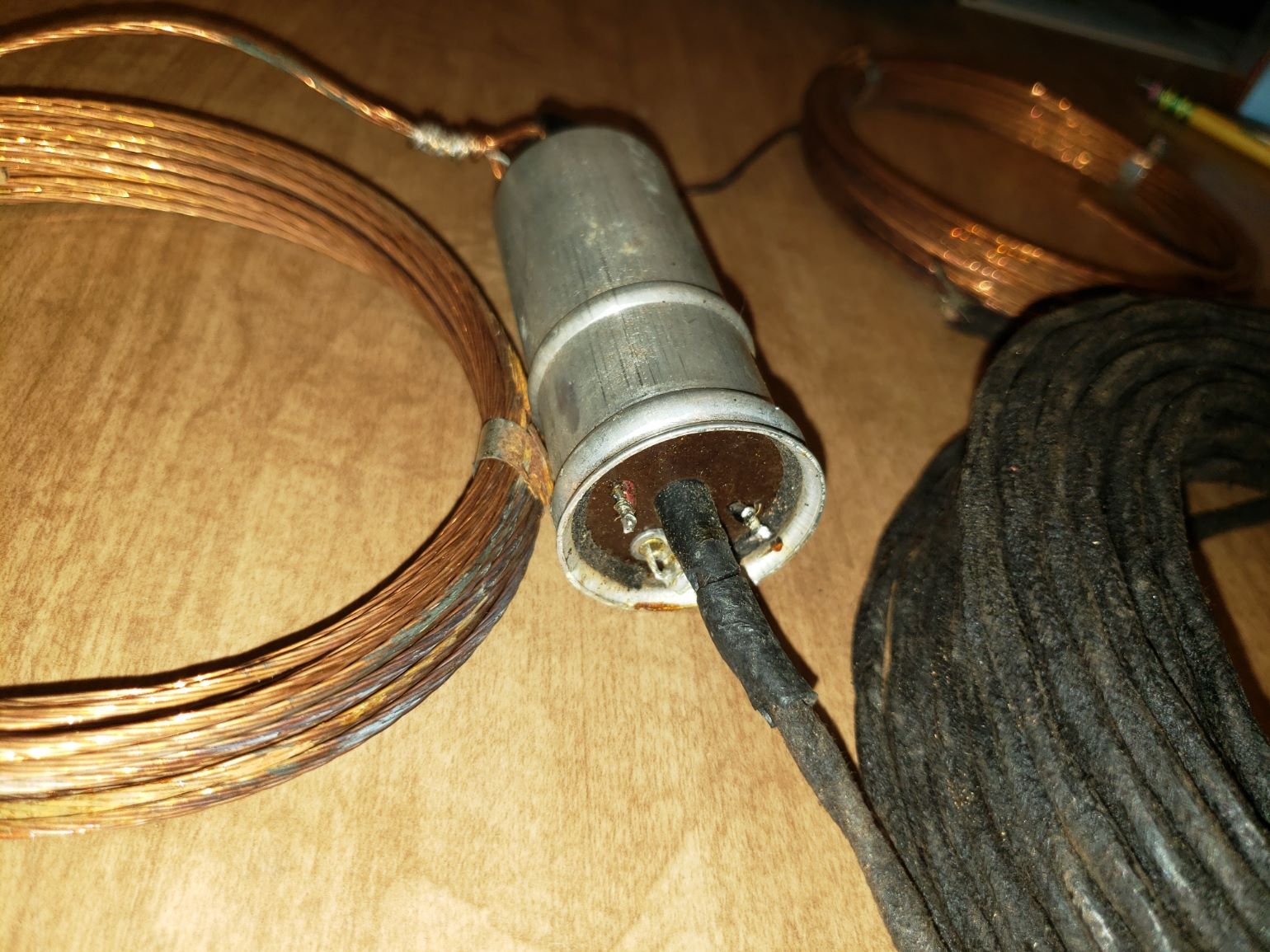

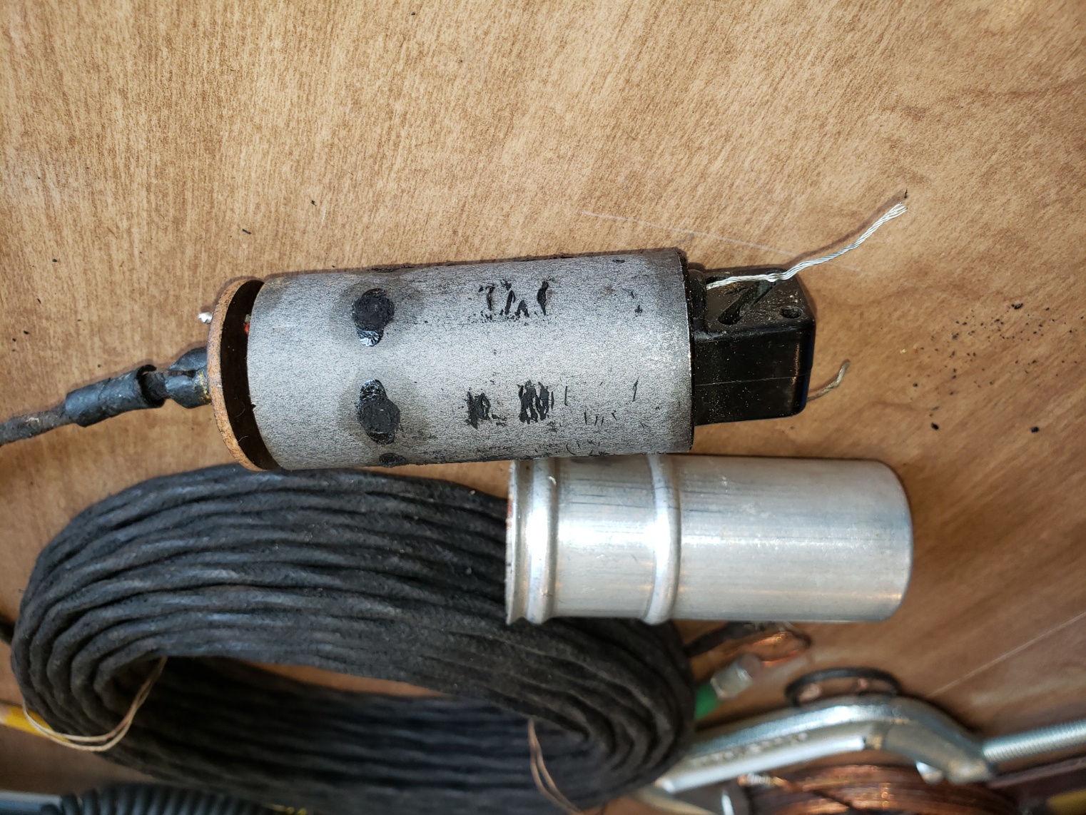

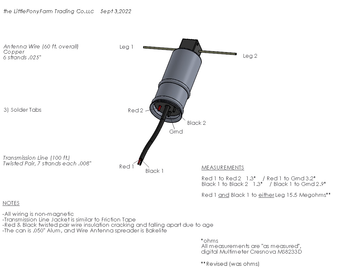

Sorry been busy here lately, but the Antenna Kit came Thursday, the 4th.
First impressions are that someone started to install it and quit, as one of the porcelain tubes looked used, while the other is still wrapped in paper. Also, one of the eggs look to have been dropped, as there is a chip (but is still usable).
The weight of each Leg seems to be slightly different; Leg 1 coil was .40 lbs. while Leg 2 coil was .48 lbs.
I measured the coils one at a time on a digital scale, first one side then the other while holding off the rest of the mess.
I’ve also taken some basic measurements as you can see on my print.
So, this unit will be disassembled. I can’t help myself; I must take things apart!
Regards,
Simon
RE: BCB Antenna Ideas -
David - 08-05-2022
Glad you got it, nice find. David

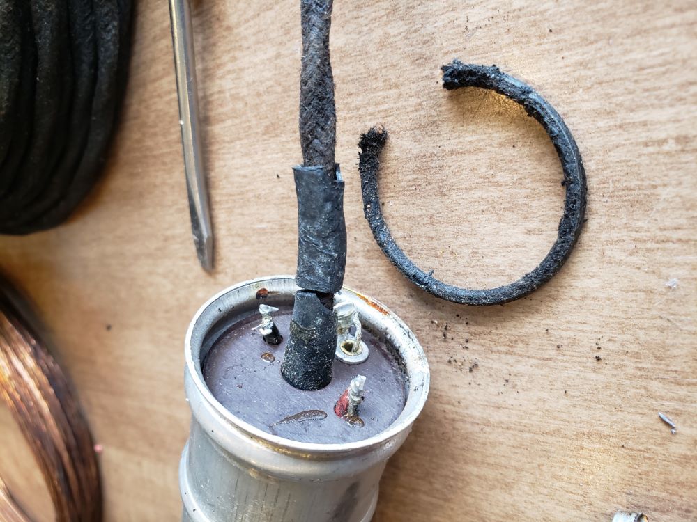

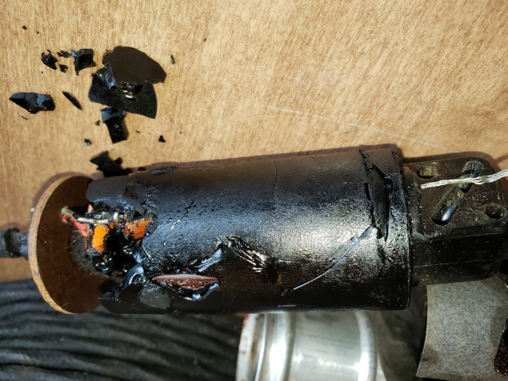

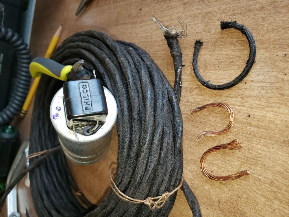

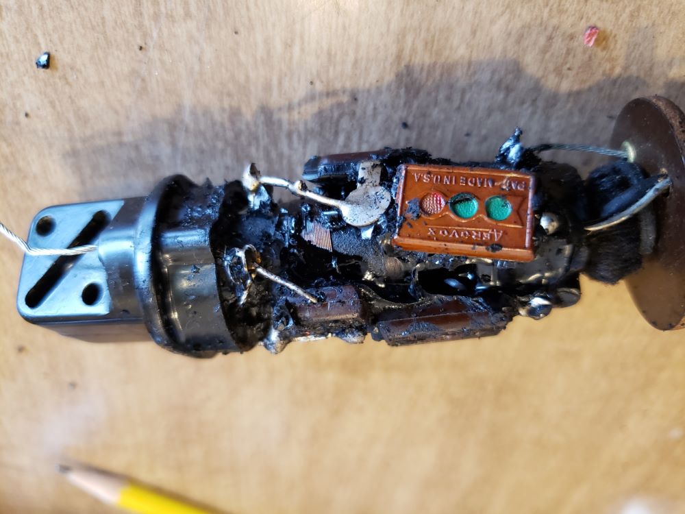

Simon Wa3uay - 08-06-2022
Thanks David;

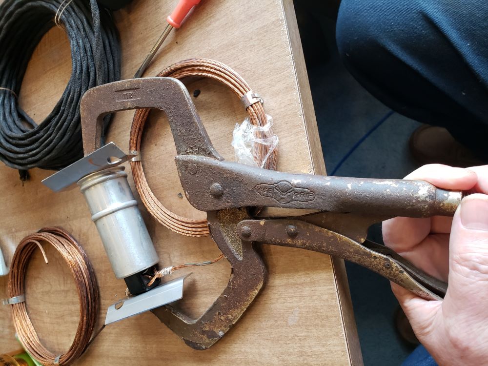

Well I took it apart. There is a coated wire circle clip that comes off first, but I find pushing it out requires the heat gun, and a pair of eagle beaks.
I tried unraveling the soldered antenna leg connections, but wanted to get this done before Christmas, so I snipped them off.
The legs can be reattached, loosing about 4" from each side.
Surprise Surprise! There's tar under that paper!
Chipping away, we find 1 resister and 5 capacitors surrounding what might be 2 coils wrapped on the same form
I would like to, at this time thank the OP RGK20m3 for getting me into this mess, see now what you have done!
Now that the legs (ant wires) are removed, I check with the ohm meter Red 1 to Leg 1, and I get 15Meg ohm sinking to about 5Meg ohm which means the capacitors are charging. This holds true for Red 1 to Leg 2, Black 1 to Leg 1, and Black 1 to Leg 2.
And now I realize that I made a mistake on my diagram, the reference to
either Leg should have been Meg ohms, not "ohms". I need a digital multi-meter with large font! Can I go back and fix that?
Next up: mapping out the circuit

Simon Wa3uay - 08-08-2022
radio1,
what I'm seeing so far is that it's not a Balun (Balanced to Unbalanced), as the lead-in is twisted wire and the antenna is a dipole that MAY be fed slightly off center. There seems to be a fixed tuning circuit for each leg, but it's going to take me a while to pick this tar-baby apart. The tuning coils are made from the same stuff the RF and IF coils are made of, so they break easy!
-Simon
Yes, I think lightning would take this out quickly.
