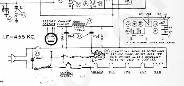

The radio plays good and broadcast and shortwave stations came through, but the line voltage is still high. I tried to wire the heater circuit with the lamp wired to 7c6 as shown in the schematic but it burned up the tube so I’m back to the beginning where I’m confused about the lamp wiring into the heater string. I have a 7b6 and it worked for a quick test for reception and that checked ok. It won’t do for regular use though. I’ve ordered another tube but could really use more help in the wiring. I know the circuit as I’ve wired it pretty well and can draw my wiring but am still confused and continue tracing. The resistors that are out of specs are 1/2 watt so I can’t replace them today. Aside from the resistors being replaced I’m wondering if the heater wiring could be causing the higher B+ and that’s how I burned the 7c6 tube. Trouble reading the way the lamp drops in between 50L6 and 7C6 which are pins 2 and 8. Any suggestions?

1. I suggest you do not change the wiring of the filaments, especially considering you do not fully understand what is happening. Lest you be buying more tubes.
2. There was a suggestion you draw the exact wiring of the filaments.
3. By the "Line voltage high" do you mean you have 125VAC and not 115VAC? If yes, go to #4
4. Once you reinstate the wiring that worked, put out the drawing. My suggestion is, use a capacitor in series with the filaments. The capacitor will drop the extra voltage WITHOUT dissipating extra power.
If you put out the accurate drawing, AND provide the accurate AC voltage as measured in your outlet, I will calculate the capacitance for you. Warning: no, simply using a capacitor for the same value of it capacitive impedance that would be equal to a resistance required won't work: there is a phase shift.

Please note that on the Code 122 version of this set, that there is no indicator bulb tap on a 35Z3, which is your rectifier.  Please note that your set uses a 120V indicator lamp. Best place to put it is between the unswitched leg of the power supply (pins 1 and 2 of the 35Z3) and the "load side" of the switch (B-, negative leads of electrolytic caps, a filament pin of the XXD, etc.).  In other words, the indicator lamp is NOT part f the filament string.  The original was likely a 3 Watt or 7 Watt indicator light with a base similar to that used in nightlights, old school Christmas lights and chandeliers.
Refer to the drawing attached and my horribly drawn indicator lamp.  This is the same diagram that I sent to you to troubleshoot the filament wiring. to cut down on heat, you can use an LED version of a C7 bulb. Note that on the published version of the schematic, the dotted lines indicate the indicator lamp for the Code 122 version. The Xs indicate to the Tech to ignore what is between the Xs. Unfortunately, this made the diagram both difficult to read and incorrect (not showing where a 35Z3 filament goes to instead of the 35Z5 filament.
