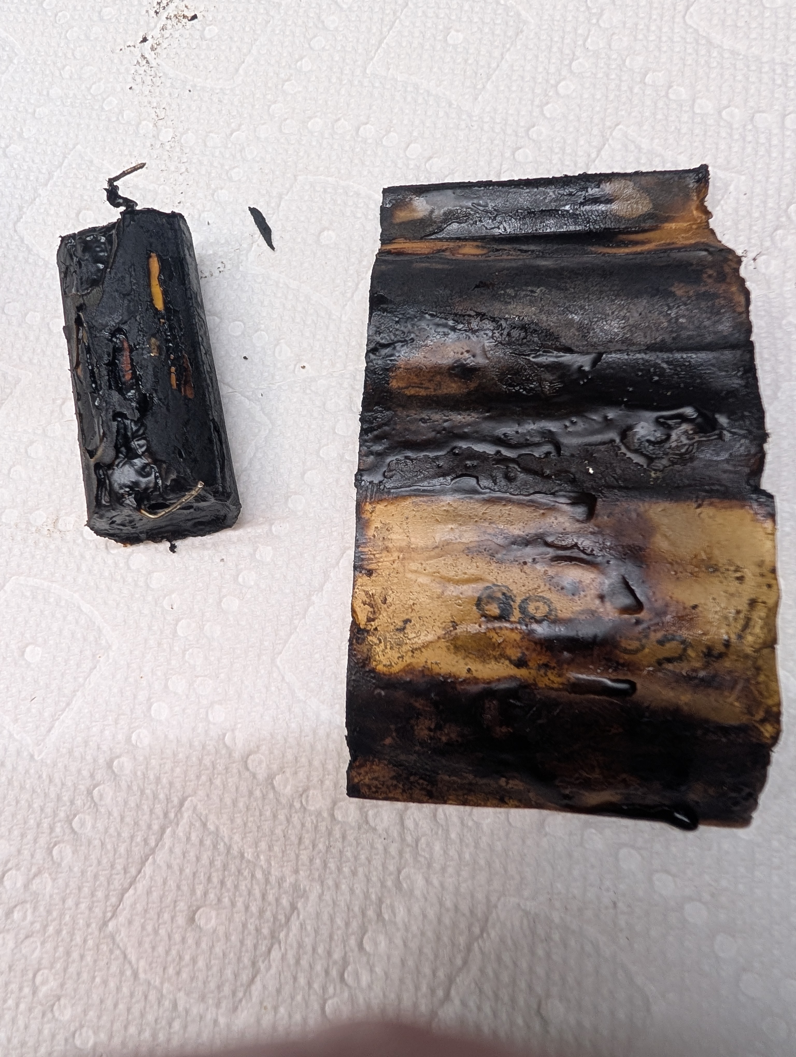

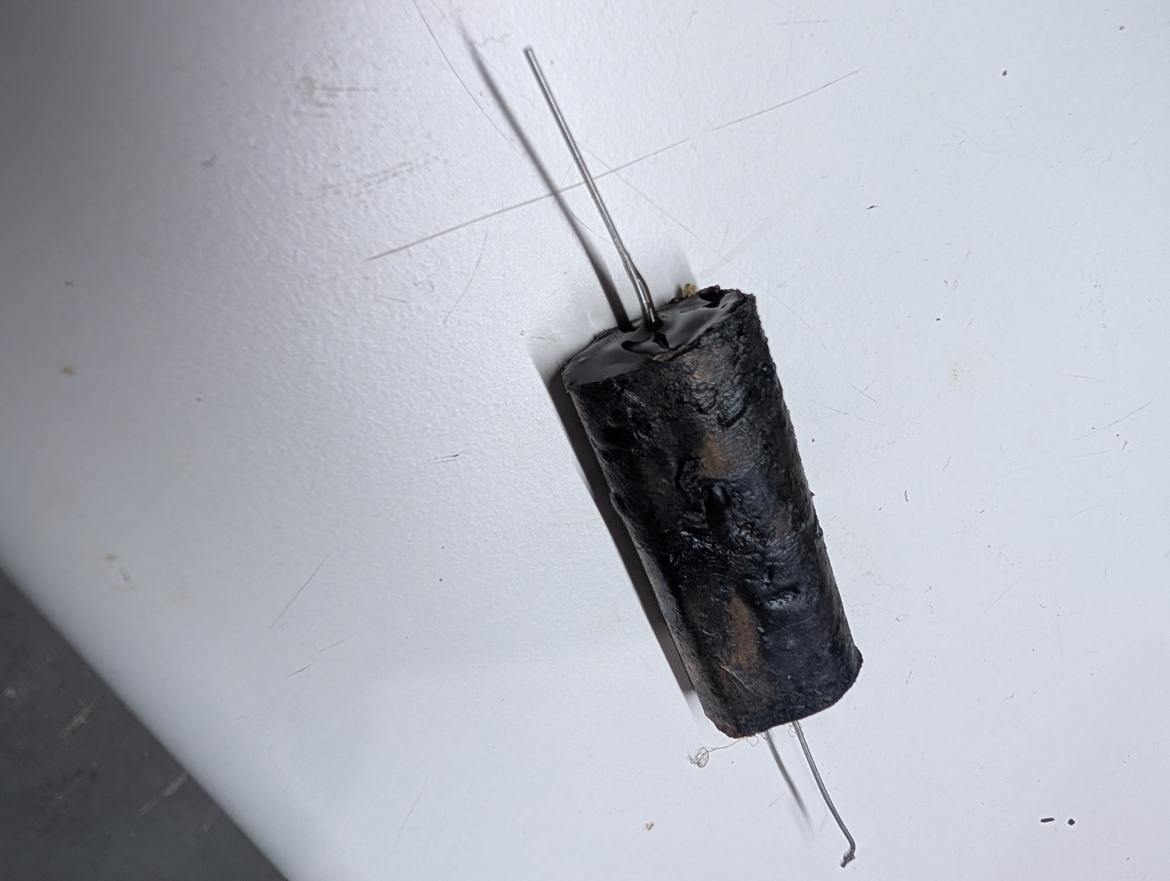

RE: Starting on an RCA140 - morzh - 06-03-2026
Just  to illustrate the way they made the caps.
For instance, this is a 0.5uF cap.
Upon heating it, there is no need to yank the leads. The cap is simply warmed up a bit and then the paper is simply unwrapped.
Then I had a 0.47uF 600V cap of pretty much the same size and also oval, not round, so I simply wrapped it, potted it, and warmed up to self-glue the paper back on itself.
RE: Starting on an RCA140 - radiorich - 06-04-2026
Hello mike,
Nice job !
RE: Starting on an RCA140 - morzh - 06-04-2026
Well, considering the grime and tar, looks pretty darn close to the original Icon_lol
