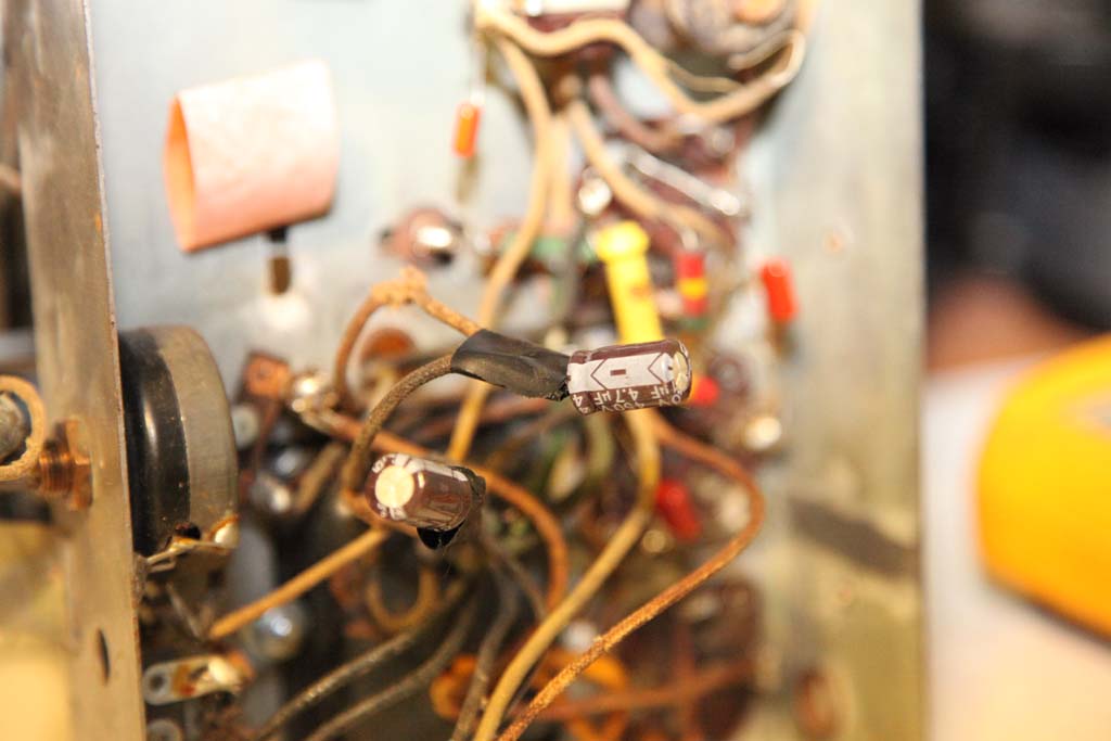

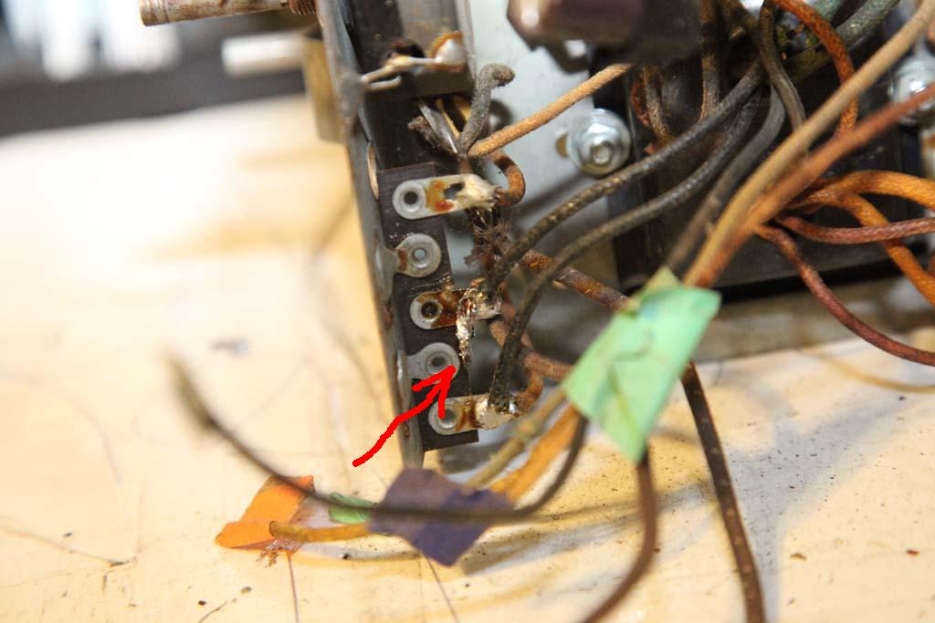

RE: Silvertone 45 chassis - morzh - 02-14-2015
Well, these are trifles....
El. caps.....
The wire's insulation is all broken.....
A wire soldered very close to the GND lug....
The wire is one of Mains 110V power ones.
Icon_mrgreen
Well, compared to the rats' having feast on the coils, this is nothing really.....

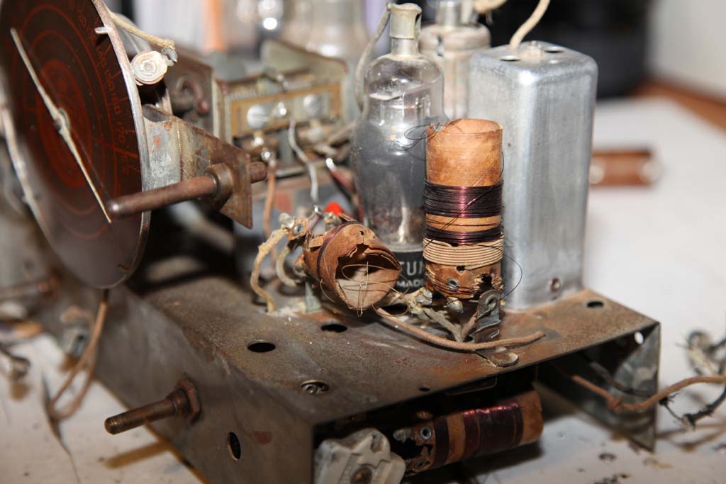

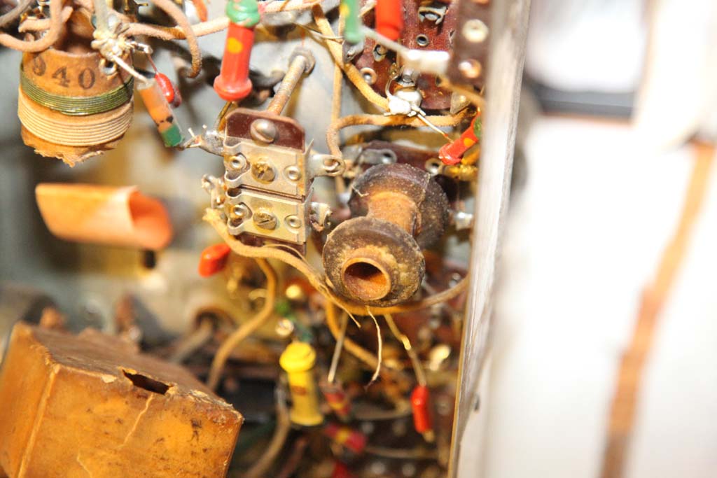

Illustration to yesterday's post
This is the open wire from IF coil.
This is the rat's dinner leftovers....
