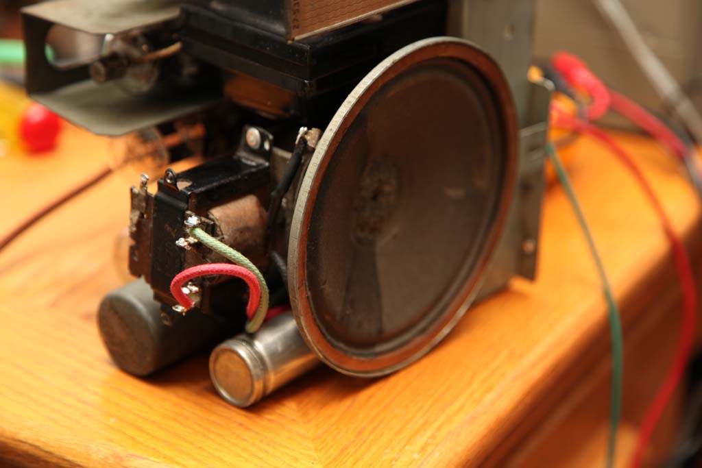

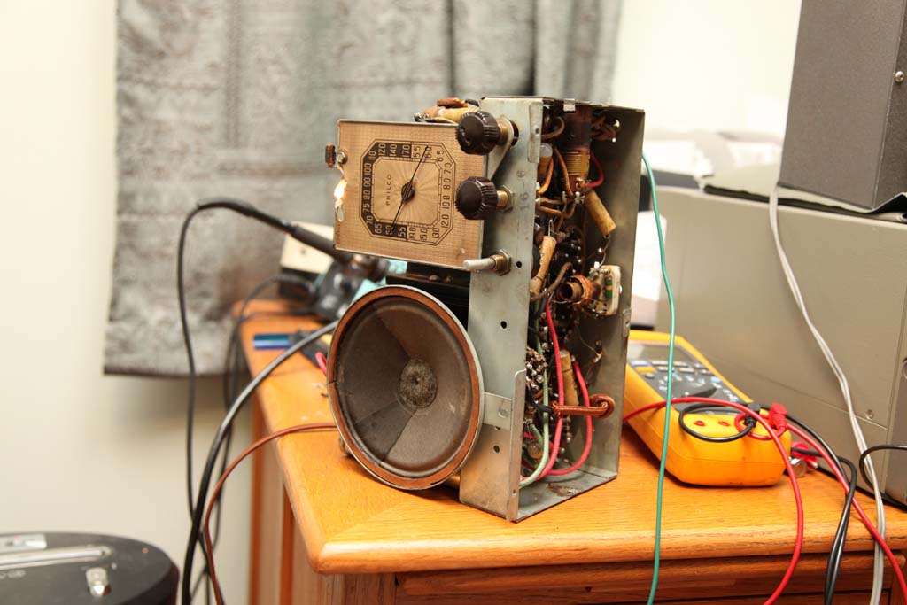

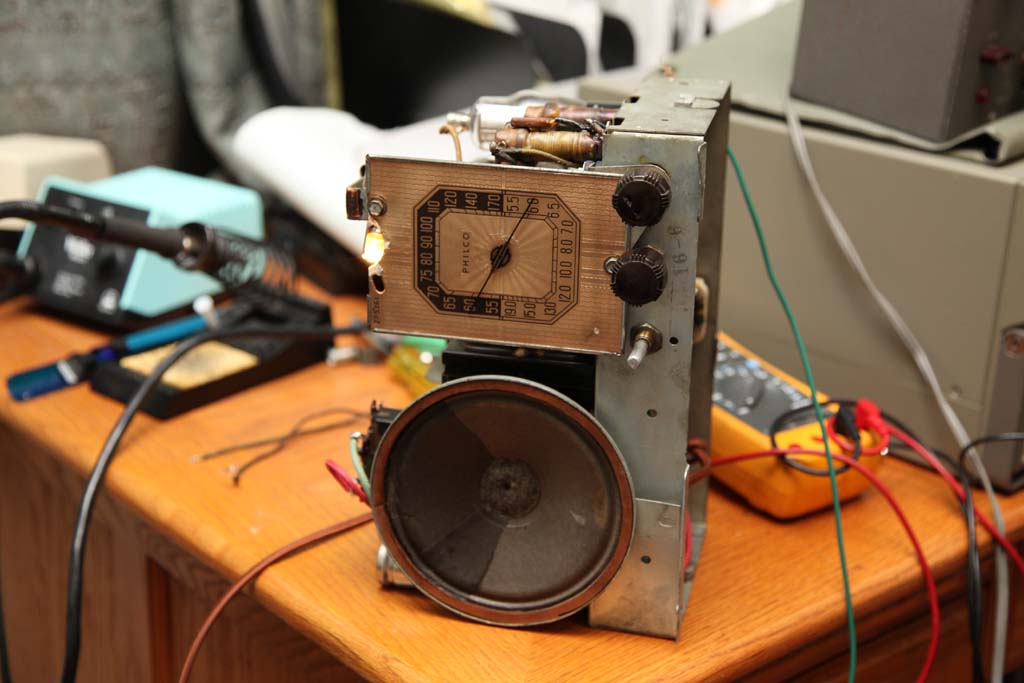

There were two problems: 1) height of the output transformer and 2) height of the 12uF/10uF electrolytic cap.
The height of the transformer I was able to reduce by removing the rivet I used on the speaker's right side, as it held the extension that then the transformer was riveted to. The head of the rivet added that 1.5mm I was sorely in need for.
Now the transformer is riveted by just one rivet and another ear is bent around the speaker's transformer holding plate - does not let it pivot. At some point I will epoxy it, but it holds the way it is.
Once I fixed the transformer problem (it still touching the top but not really propping it up) and tried to slide the chassis in the cabinet, I realized that I was having another nasty - the electrolytic cap. First I couldn't get it, why - it was its own cap. Then I recalled that instead of sawing off the bottom I opened it as I would a can, and then stuffed an potted it. The opened flange added the height.
I desoldered the cap, took it out, took the hacksaw blade, round-cut the flange, reducing it by about 3mm, then nipped off the excess of the potted plastic, smoothed it with a heatgun and put it back into the chassis.
Now all fits! Squeaking by, but fits.
Here it is.
The speaker's cone patched and the speaker installed.
Same.
Transformer view.
