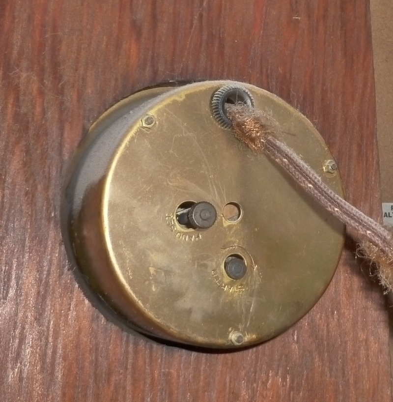

RE: Philco 570 Gramps Clock - Eliot Ness - 04-09-2020
Mike, here is a picture of the clock in my 570 (and it does have a second hand):

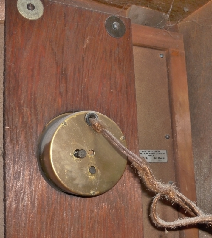

RE: Philco 570 Gramps Clock - Eliot Ness - 04-10-2020
Mike, I do not see a nut behind the hands attaching it to the face.  I'm pretty sure it is an original clock.  I think the clock is attached to a piece of wood and that is bolted up behind the face as shown (but I've never removed it):
I think your idea of having yours repaired is a good one.  Even if it isn't original it is still an older electric movement and you know it will fit.
