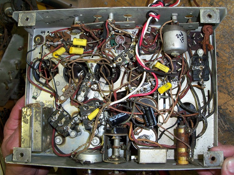

What would be really helpful is if someone with a working set that took a picture of the bottom of the chassis before they put it back in the cabinet could post it here. It would at least give me something to compare connections on.

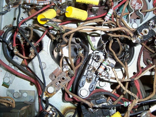

Here is a pic of the bottom of my chassis. It was a total mess when I got it... there was hardly anything connected where it should be and so many extra components added I had to literally go wire by wire on the schematic to trace it out. The schematic I'm going off of is also below. I'm at a loss as to how to get rid of the shortwave and get local stations on the dial. If there was a pulling one's hair out icon I'd post it here!

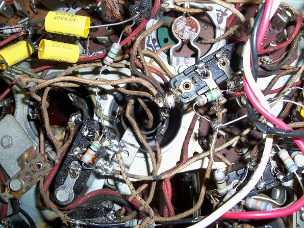

Can you take a close up photo of the wiring to the osc coil under the chassis? Maybe I can compare it to how the coil in my 89 is wired.
RE: Model 89 Cathedral - NostalgiaRadioTime - 03-05-2014
Thanks, Mondial. Let me sleep on it. Will take a close up pic after work tomorrow. You don't by any chance have your notes on rewinding the osc tickler do you? That's the only thing I rewound on it. BUT... this coil came off my parts chassis which uses the #77 tube instead of the #36. I wonder if that might be the problem... that the coil used for the model with the #77 tube is wound differently from the coil for the #36 tube model?
Mondial, Fresh from the toils of work, I came home and snapped a couple of close up pics of the RF and OSC coils showing the wiring. Not sure you can make out where they're going, but I'm certainly grateful for all of your help and would very much enjoy hearing your thoughts on what may be causing the short wave signal instead of hearing local stations. I suspect one or the other or both coils is either wired incorrectly, or wound incorrectly. Could there be a difference between these two coils in the early models with the 36 tube to the later versions with the 77 tube? Or the fact that I used 32 guage wire instead of 34? Thanks!
RE: Model 89 Cathedral - Mondial - 03-06-2014
Ok Greg, I took a look at the photos and my 89. Its really hard to tell, but I don't notice anything obviously wrong with the osc coil wiring. I did trace out the wires to my coil so you can compare with what you have. I am starting from the lower left of the coil referenced to your photo and counting clockwise from there.
