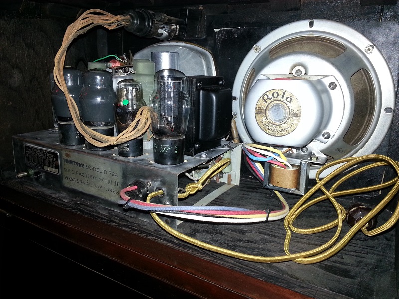

I remember looking at the model last year or so.
Two versions: One made by Belmont with oval dial
One made by Detrola with same dial type we see on a D-724 and others.
http://www.radiodaze.com/truetone-d696-d724-727-3950/
Matter of fact the same chassis (147) and same 8" Rola speaker as well.
From what Ive observed the speakers can be found with abit of luck or reconed easily.
The Belmont version will be stamped like this on chassis and have oval dial
http://www.antiqueradios.com/forums/download/file.php?id=93342
Detrola version will look like this but obviously speaker relocated
http://www.philcoradio.com/phorum/attachment.php?aid=8683
