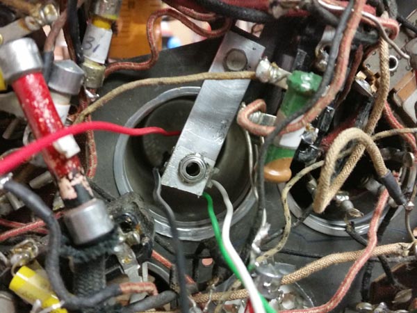

I attached colored wires to the pins and mounted the coil on a piece of aluminum up inside the oscillator coil can. The color choices were mine, and you can refer to the pin numbers to identify the actual connections.
After wiring it up carefully, I got nothing. It took an hour or so of troubleshooting to determine that the band switch decided to become intermittent. After some fiddling, the radio came to life. The dial was a bit off, but I found the strongest station on the band, and adjusted the slug inside the PSC-70-OSC coil to move the received station down to its correct place. Tracking is pretty good across the band.
