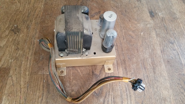

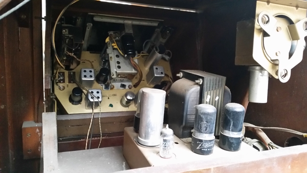

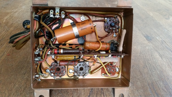

Here is a selection of pictures, . The cap situation in the power supply/audio output chassis doesn't look too desperate, in contrast to the tuner... at least the whole thing is original and unmolested.
RE: Zenith 12H090 - Electrothaumaturgist - 05-30-2018
That's about as fresh as they come. I like it when the undersides are untouched like that. The wires look quite nice, also. Are you keeping those "as they are?"

PS. Very clean looking underchassis. If you could hollow that capacitor without destroying it (it is pretty much a paper shell and lots of very hard epoxy to take out) it'd be great but then it might be a bit onerous.
