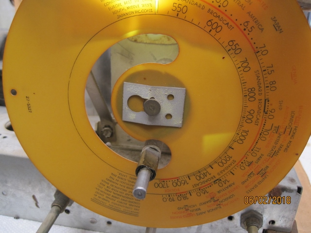

I'm now continuing working on this Philco 38-9 for a friend.
I need to safely remove the plastic dial from the tuning shaft before I accidently damage it!
What is the best safest way to remove this very fragile part from the tuning shaft?
Thanks    G.

RE: Help with 38-9 Plastic Dial - NostalgiaRadioTime - 06-02-2018
It takes a bit of finesse to remove the dial scale. I've done it with a duckbill needle nose pliers but you need to be very careful.
All that needs to happen is to slide that metal clip to the right so the hole in it is over the shaft. Then just take the clip off and remove the dial.
Perhaps with a dot of oil on the shaft you may even be able to slide it over with your fingers.
RE: Help with 38-9 Plastic Dial - philconerd - 06-02-2018
Larry
Greg
Thanks for your suggestions.  I was successful fixing both problems.
The lamp socket was blocked by the rubber insulation on the wires.  Using the heat gun, the rubber softened enough to fall apart and I could push the lamp out of the socket.
A spot or two of oil and a large pair of pliers to pry off the clip did the job on the plastic dial and no damage.
I am a happy camper and can proceed with cleaning and repairing the chassis.
