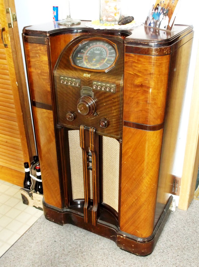

Here's an original finish (below) The only thing on this that is not original is the grille cloth.
I've had quite a few that were original, with (as Ron says) some battle damage from five/six/seven decades of life, but certainly nothing to scoff at.
