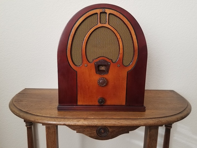

First radio restoration in years.
Over 45 years ago went to the dump with a neighbor, saw a Philco cathedral radio sitting there on a pile of old electronics parts, took it home and with the help of my uncle who worked on radios in the 30's/ 40's, got it up and running.
Recently saw this model 80jr radio on craigslist and thought it would be fun to get back into this hobby, didnt realize what I was getting into LOL!

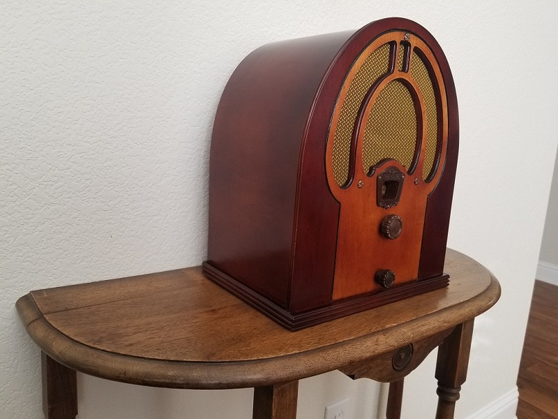

For this cabinet I used the following Mohawk lacquers:
Heavy Body Sanding Sealer M102-0491
Ultra Classic Toner Medium Brown Walnut M100-0207 for the main cabinet
Ultra Classic Toner Light Walnut/ Colonial Maple M100-0352 for the face inner section
Tamiya Spray Black #TS-14 for the line between the light and medium walnut on the front face.
Tone Finish Clear Semi-Gloss M102-0419 for the final clear finish.
I had read on this forum to use the Ultra Classic Toner Perfect Brown for the main cabinet and Medium Brown Walnut M100-0207 for the front face light section, but I found this was too dark for the front light section. So I sanded it off, and used Ultra Classic Toner Light Walnut/ Colonial Maple M100-0352 for the face inner section, but left the sides that meet the grill cloth Medium Brown Walnut, makes for a nice 3d effect that maches the main cabinet color of Medium Brown Walnut.

RE: Philco 80jr, Calling it done! - rfeenstra - 11-03-2018
Is that the original grill cloth? If not, where did you get it?
RE: Philco 80jr, Calling it done! - klondike98 - 11-03-2018
I get mine at https://www.richmonddesignsinc.com/
RE: Philco 80jr, Calling it done! - Phlogiston - 11-03-2018
That grill cloth is a good match to that used in the Majestic 90 console and the Westinghouse Columnair.
But we cant be picky now-days. Lot better than somebody's spandex - yes this was common in the 80's.
RE: Philco 80jr, Calling it done! - Lewiss - 11-03-2018
Thanks guys,
Got the Herringbone grill cloth off of ebay.
https://www.ebay.com/itm/Antique-Radio-Speaker-Grille-Cloth-S-Herringbone-18x24-Holiday-Sale/183505434880?hash=item2ab9c6b900:g:GNEAAOSwtAlbwB2e:rk:2:pf:0
It looks a lot like the original that was on the radio.
Lewis
