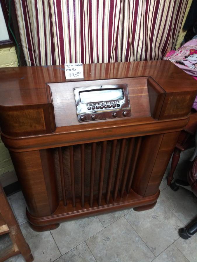

I finished the chassis on this radio several months ago and decided it was time for it to find its home in the cabinet.  So, cabinet restoration begins.  this cabinet had been stripped before I got it so I have no idea of its original colors except for a bit of toner that was left on the back side of the louvers.  Quite dark and brown.  Do these photos give a good indication of the original finish?

Anything you see in back of the cabinet is the typical flat, darkish brown Philco used inside all of their cabinets. You know, like Zenith used blue, and some 1937 RCA sets used silver. It is not an indicator of how the outside of the cabinet should look.
If using rattle cans (as I do), I think I would use Mohawk Medium Walnut overall.
RE: Philco 41-295 - rfeenstra - 10-09-2019
Thanks Ron.  I do use rattle cans for the toner.  I hate it when they spit, though!  I may mix up toner for this project.  A lot of area to cover.  So the really dark brown is probably from spraying the inside of the cabinet.  Good to know!  Are the 2 pics I included a reasonable example of what to shoot for?  I saw one photo of a cabinet that had been converted to a guitar speaker.  They claimed it was original finish.  It was photographed  in the sun and was really red.  Far more red than anything I've seen except when I use a flash!

rfeenstra Wrote:Are the 2 pics I included a reasonable example of what to shoot for?
Yes. As long as you don't go overboard with the Medium Walnut, it should turn out the same color as that, or very close to it.

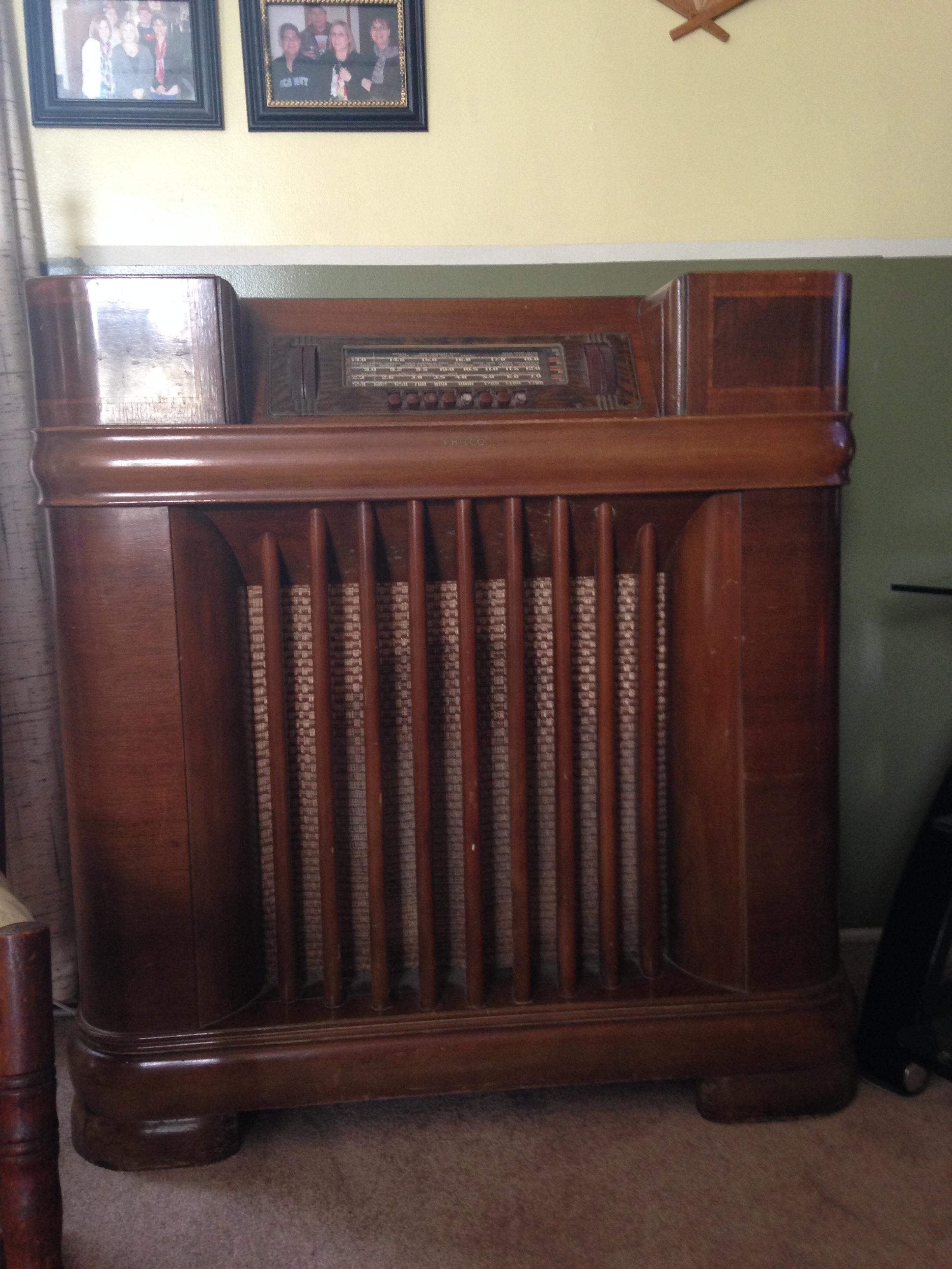

RE: Philco 41-295 - nortonz - 10-10-2019
I have this model I restored last year, turned out well
[attachment=20342][attachment=20343]
I’m still working on the chassis, I’ve replaced all the caps, now trying to find a tube tester to finish.
RE: Philco 41-295 - rfeenstra - 10-10-2019
Thank you! It looks like you opted to leave the wood natural. I have enough damage to need to tone the white wood darker to hide the repairs.

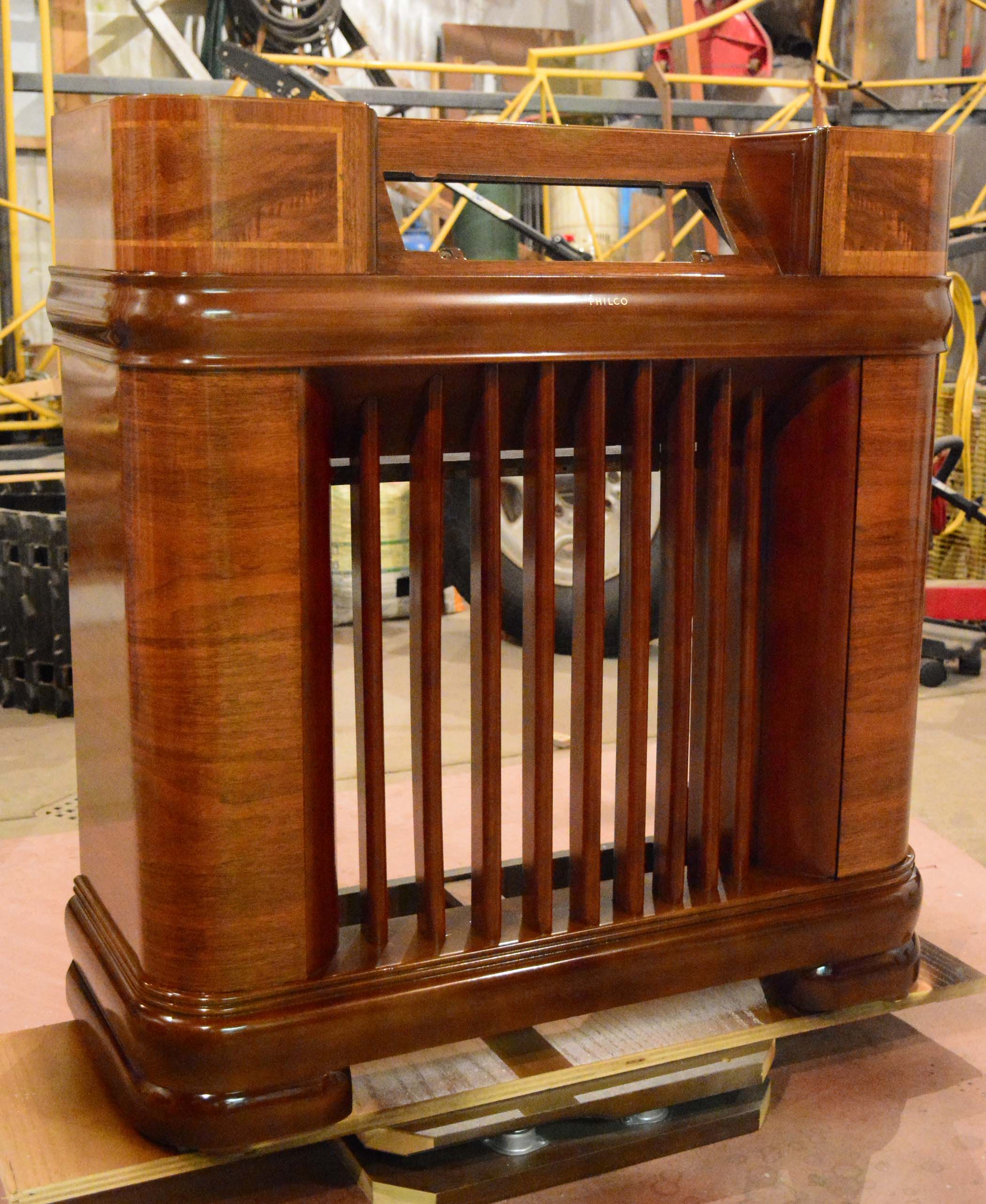

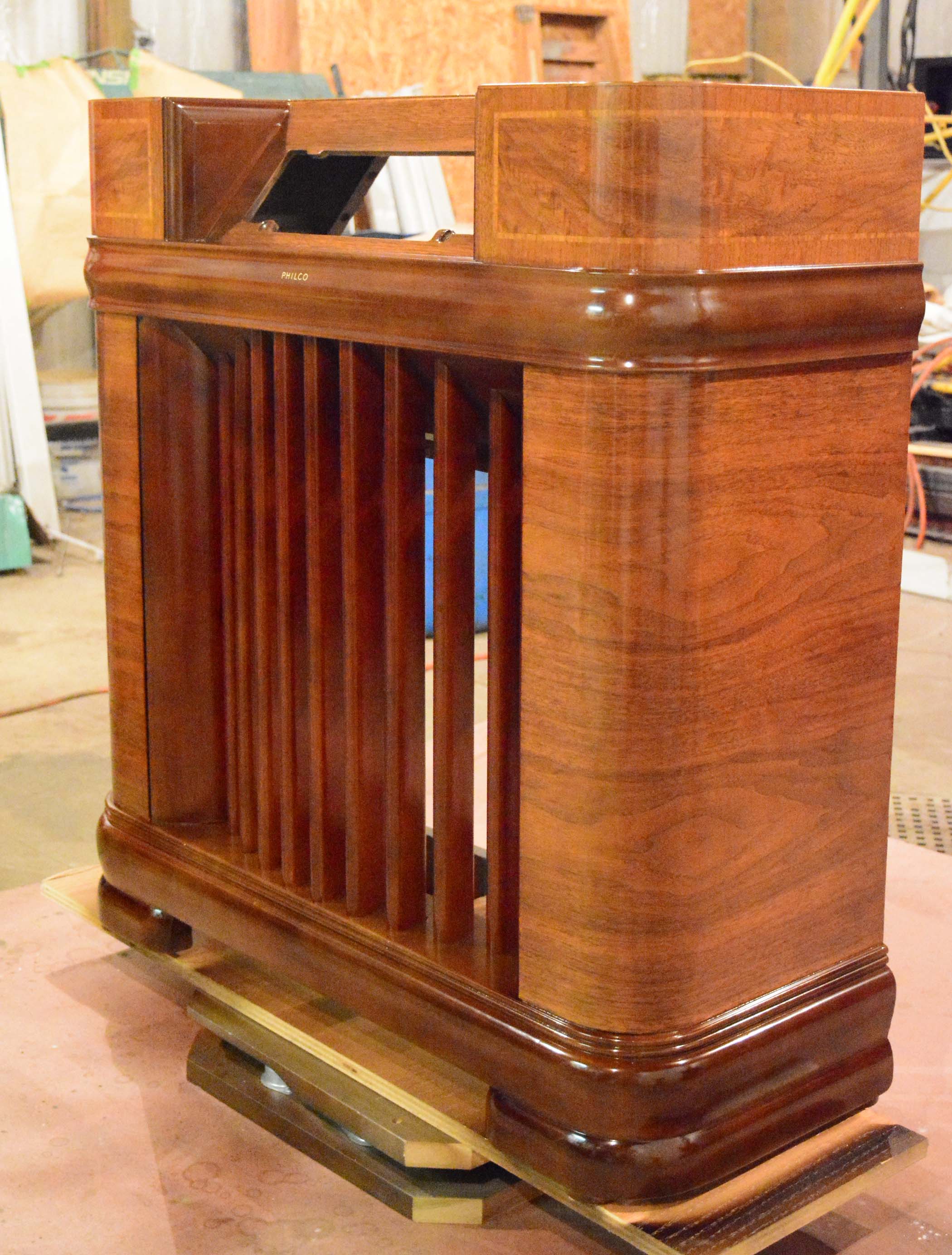

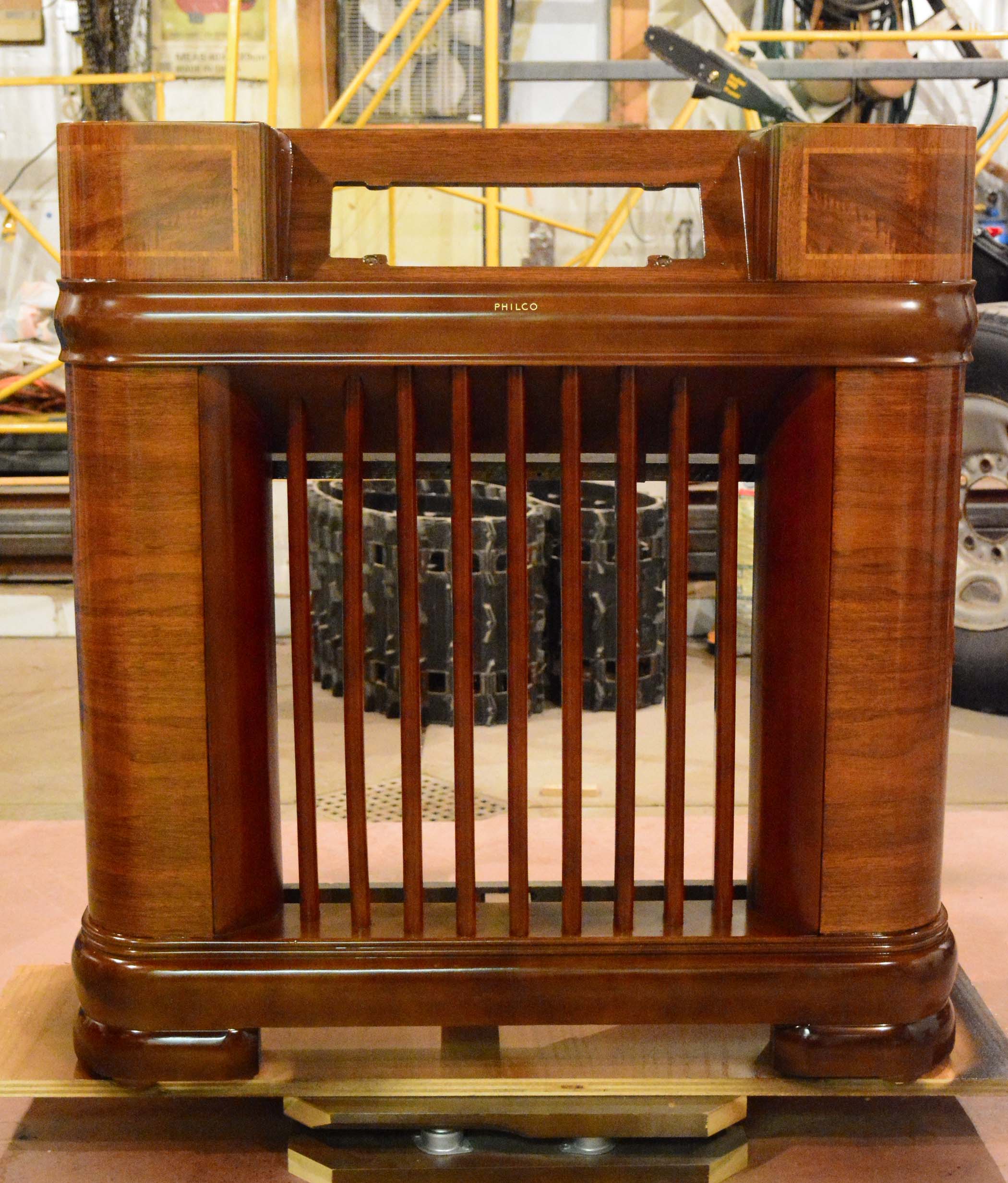

So here's where I'm at.  final coats of lacquer have been applied.  I'll wait a few weeks for it to completely dry and cure (using pre-cat lacquer).  I have a couple of small runs to sand out and then finish sand with wet 400, 600, 1200, and maybe 2000 grit paper.  Then rub out with polishing compound.  A freakin lot of work!
The white wood has lots of filler to fill dents so it was toned with a light color, opaque toner to hide the repairs, then toned with Medium Brown Walnut and VanDyke brown.  It may be a bit darker than original but all my less than professional repairs are hidden.  Grain filler was Mohawk walnut sealed with EZvinyl sealer.  Then mohawk sanding sealer. Then semi-gloss pre-cat lacquer.  The walnut top and sides have only a very tiny bit of medium walnut toner, otherwise it is the color of the wood after the grain filler was applied after a wash coat of sealer.  The diffusers are easy to remove so they were finished separately from the cabinet.
I have a really hard time with the rattle cans of toner.  I can't get an even color.  This cabinet is practice for an EH Scott I need to refinish so I've learned that I may need to mix my own toner and spray with a gun for a more even color.
