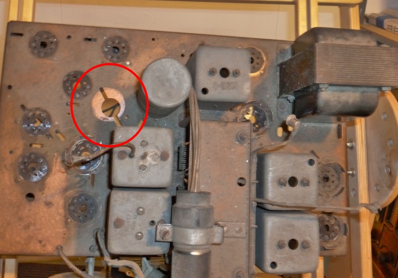

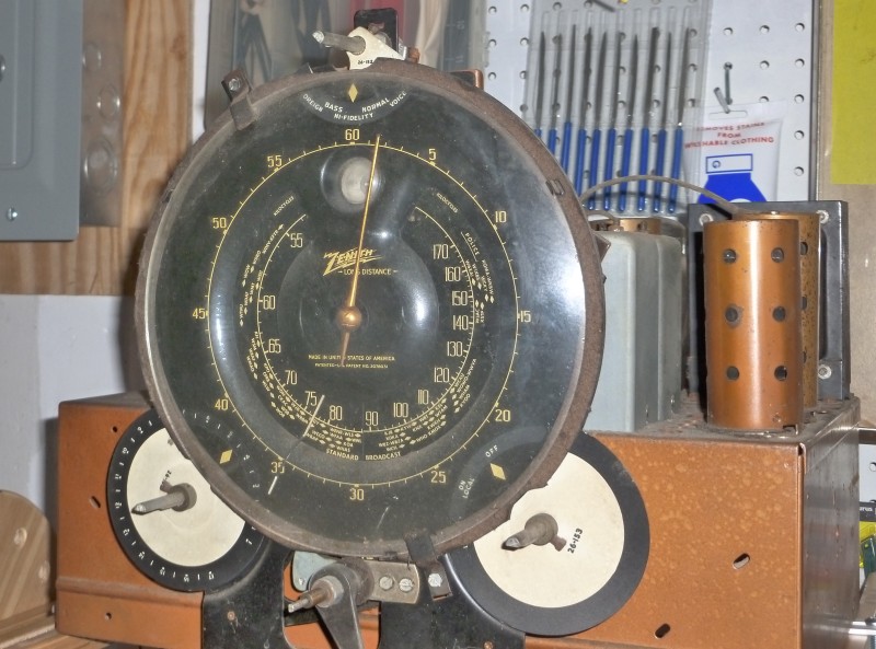

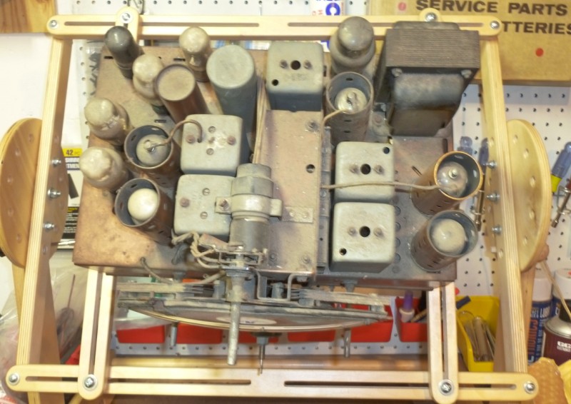

Here are a few pictures of it on my chassis holder.... very dirty from years of storage but if you look carefully at the eye tube you'll see it is the elusive 6T5 that was only used in this year (1938) Zenith. Even if it still has life in it I'll probably replace it with a 6U5 or 6G5 and save it for special occasions.
This probably won't be a fast moving moving restore since I have some other competing projects I've been putting off. I am looking forward to digging into this chassis because the '38 Zeniths are one of my favorite chassis to restore, and this one doesn't seem too butchered up, so below is what I'll be working on:

6T5.....1) the 1M resistor is likely open (a popular problem). You could do the mod I did without opening the socket. 2) you could put the plate switch in and so save 6T5 life, making it glow for the aforementioned special occasions.
Candohm.....possible problems. Both my 11K sections were open.
The rest was easy....oh... 1st RF coil was open. The radio worked fine. Except SW wasn't sensitive.

Very nice, John. At what probably was the last radio swap meet in the country before the stay at home's began (the WARCI meet March 15), I had a friend from the ARCI club bring me a 1938 Zenith 12 S chassis and matching speaker from a chairside set. I installed them in my 7S258 cabinet, replacing the 7S chassis and speaker. A perfect fit with no modifications (other than the tuning / motorized tuning knobs and bandswitch lever needing to be changed). It's the best of both worlds, a nice small console cabinet and 12 tube sound. So I just worked on one of these chassis myself. The nice thing about these is, except for the eye tube socket there is no crumbling wire and the chassis is nice and open (albeit a bit deep). I too have a 6T5 tube that has about 75% brightness left. I put a 6E5 in the set instead, like you saving the ultra rare 6T5.

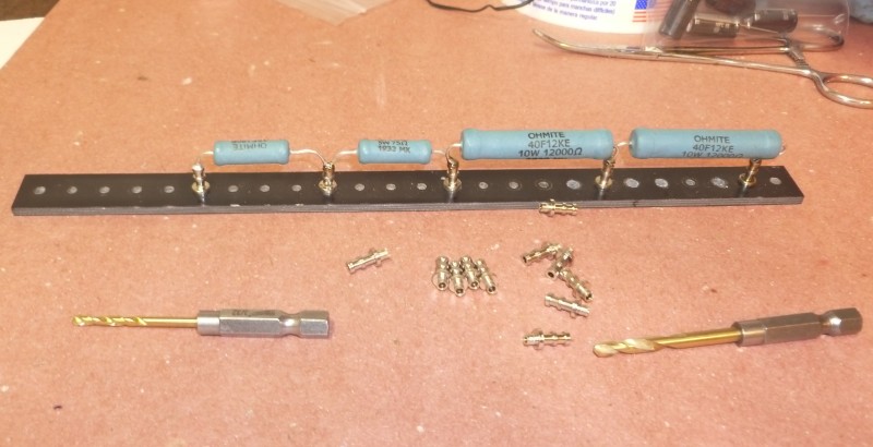

I took the turret strip and power resistors and made my preliminary candohm replacement. I still have to cutoff the excess length, but the finished strip will be almost identical in length to the original candohm, which has at least two bad sections.
A few notes: I used 10 & 5 watt resistors per the recommendation of John Goller (K9UWA).
I decided to remove the unused turrets and found the easiest way was to use a 9/64 drill bit on the bottom and just lightly remove the small lip on the bottom of the turret.
To get two resistor leads to fit in the turret I had to gently enlarge them slightly with a 3/32 drill bit. There are ways around this but it would not be as neat. If you do this drill slowly and practice on a couple of the unused turrets because the first two I tried did not go well. As you can see I wound up with several extra turrets that I could glue back if needed, or if I found a similar piece of base material drill it and make a custom turret strip for a candohm replacement.
All-in-all I'm pleased with how it turned out and my connections to the candohm can just be wrapped around the applicable turret and soldered.

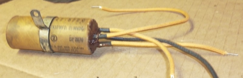

OK, I've been working on the electrolytic capacitors which consist of seven capacitors in three different style enclosures.

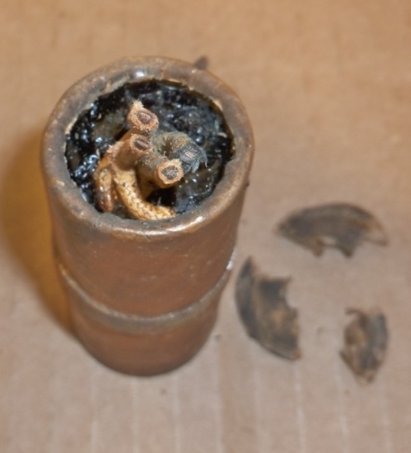

The first is a wax cap under the chassis that contains three 10 MFD caps @25 volts. I replaced these with 50 volt caps. I cut the top of the cap into 4 sections with a utility knife so I could remove it without doing too much damage to the rolled lip of the capacitor:

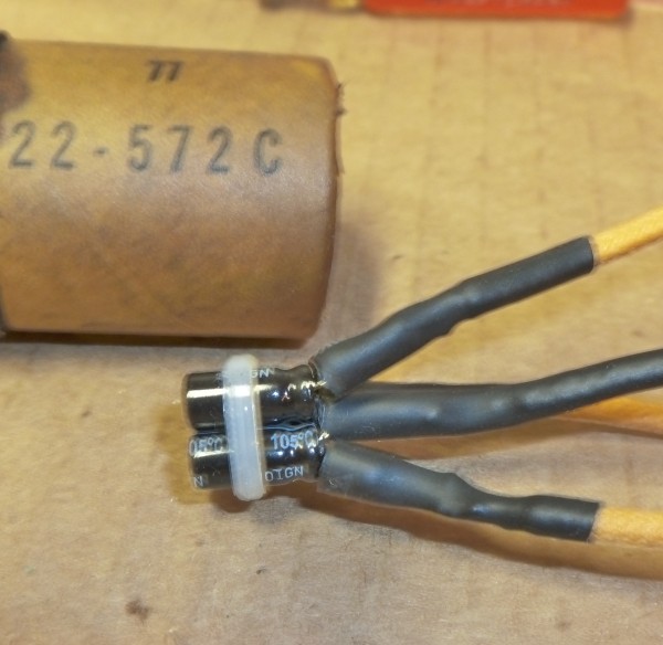

I was then presented with a very hard black tar. I heated it with my heat gun on low to prevent scorching the cardboard sleeve of the capacitor. Unfortunately the tar never got soft enough to pull out, but since the replacement caps are so small I just dug out a little cavity big enough for them:
I set them in hot glue to hold them in place and then finished with brown hot glue, and have since trimmed off the excess heat shrink with an Xacto knife:

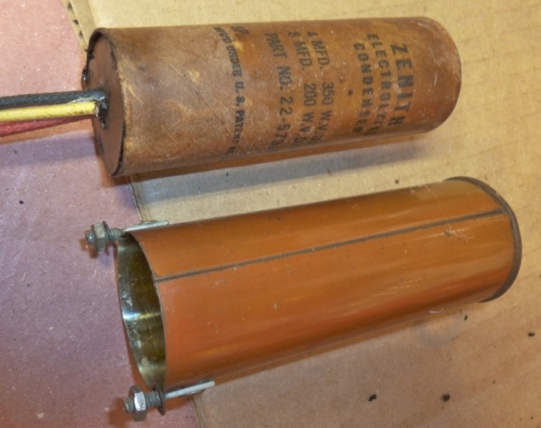

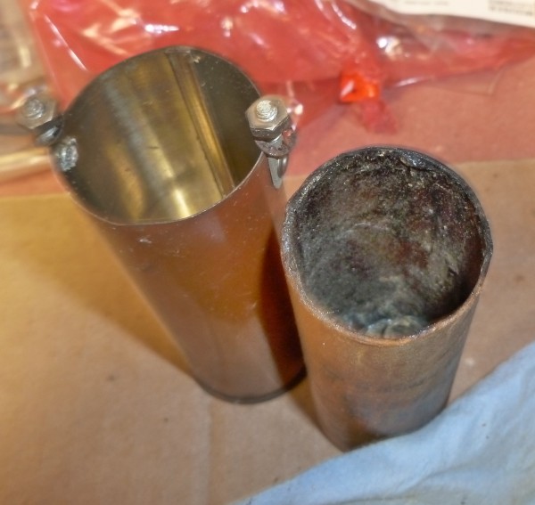

The next electrolytic consisted of a 4 and 8 MFD mounted above the chassis. When I removed this capacitor it became apparent just how filthy this chassis is

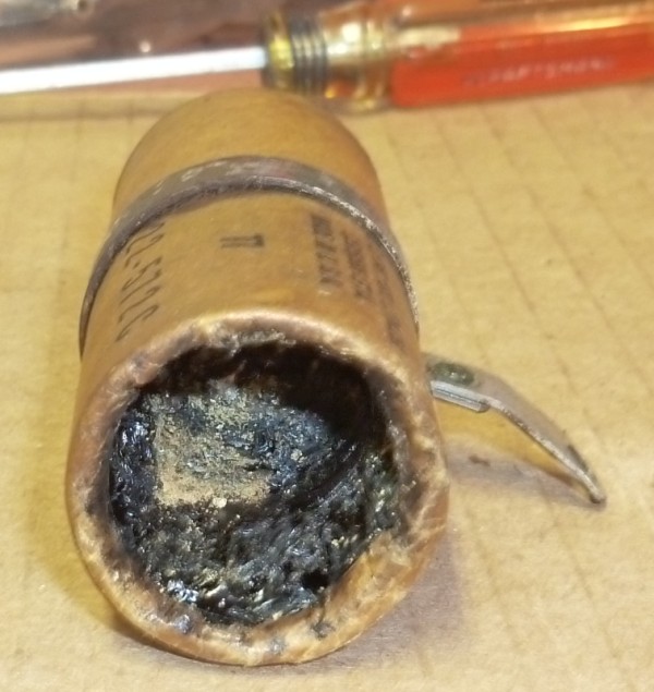

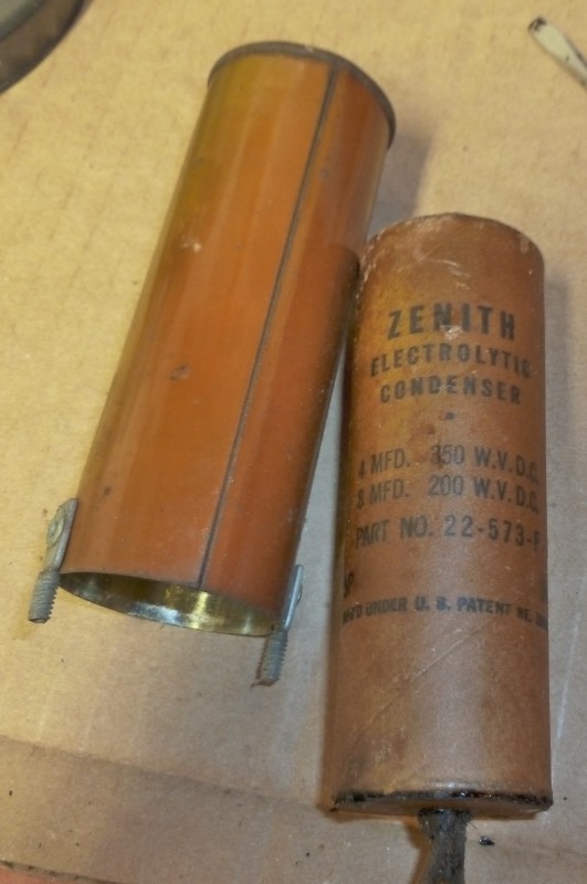

This dual section cap was just a cardboard tube that slid inside the Zenith orange can that mounted on the chassis:

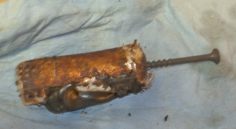

Presented with that same hard black tar I decided to take a different approach and stuck it in the freezer overnight. I then wrapped it in a shop towel and smacked it with a hammer (several times) and all the black tar eventually cracked and fell out. I did have to sink a drywall screw into the actual capacitor to yank it out:

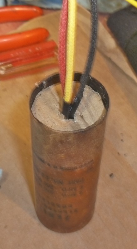

I put some filler in the tube to take up space, shot in some hot glue to anchor the capacitors in place. I then made another cardboard disk to keep from having to use so much glue as filler:

Continued: With the dummy cardboard top in place I filled it with hot glue and put the original cover in place and it's ready to be inserted back into the metal can:

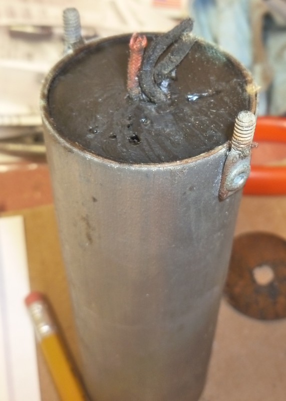

I then removed the final electrolytic that is a 12 and 20 MFD. Unfortunately it has that same hard black tar so into the freezer it goes
