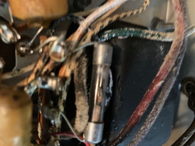

I recently received an H1916. Beautiful cabinet with a few nicks. Includes the 2 electrostatic speakers and an RT400 stereo receiver. No rusting anywhere except some very slight surface on one of the electrostatic grids in one area (but it shouldn't impede function.) The previous owners said it never turned on for them and they had it about a decade. Upon inspection I found that the soldered fuse was toast. I am hoping the fuse did its job well enough and protected the components after it. It also came with schematics, manual, and other info. The turntable is missing, but I'll worry about that later.

The fuse imprinting appears to be 250 70LT but I can't find anything with this number. The fuse was in rough shape so the imprinting may be marred. Would would be a good replacement fuse for this?

The fuse is likely 250V, my guess is 1-1/2A.

Fuses do not protect components. They protect the wires from going on fire due to faulty components, so look for the reason it burned. Bad tube, bad electrolytic cap etc.
Else you wil expend another fuse for no good reason.

Since you are going to replace the fuse anyway, perhaps you should look into installing a fuse holder if the room is available. I agree with Mike. Murphy's law says that a pricey component will expend itself in the effort to save a 29 cent fuse! Take care and BE HEALTHY! Gary
