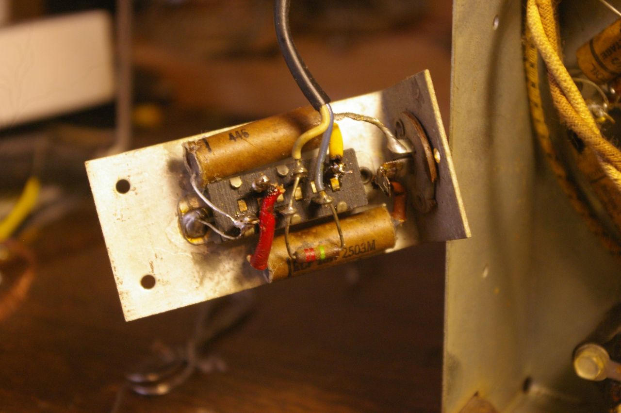

At first I thought it might be a quickie replacement for the on-off switch, but I was wrong. Turns out it is a phono input added long ago, probably no later than the 1950s from the look of the condensers used.
[Image: https://64.media.tumblr.com/09f9c694f502f336fae21d9649b5000c/277e7aed8d472ec1-42/s1280x1920/a2226f4ea2168fc99f798bd70da3a04d545bd9b2.jpg]
I will certainly keep that input, since it forms a pert of the radio's history, and is also useful. I will actually re=stuff the condensers since they will be above the chassis this time and may be partially visible if someone looks from an angle. Beyond that, I pulled the chassis. The radio is mostly virgin. Beyond the phono input the only obvious repairs are the replacement of the filter condensers. These are also a long ago repair, one of them is labelled "Olson", and the other is labeled with just the initials G and a backwards L, which I don't recognize. Some of you, like me, will fondly remember the Olson Electronics catalogs.

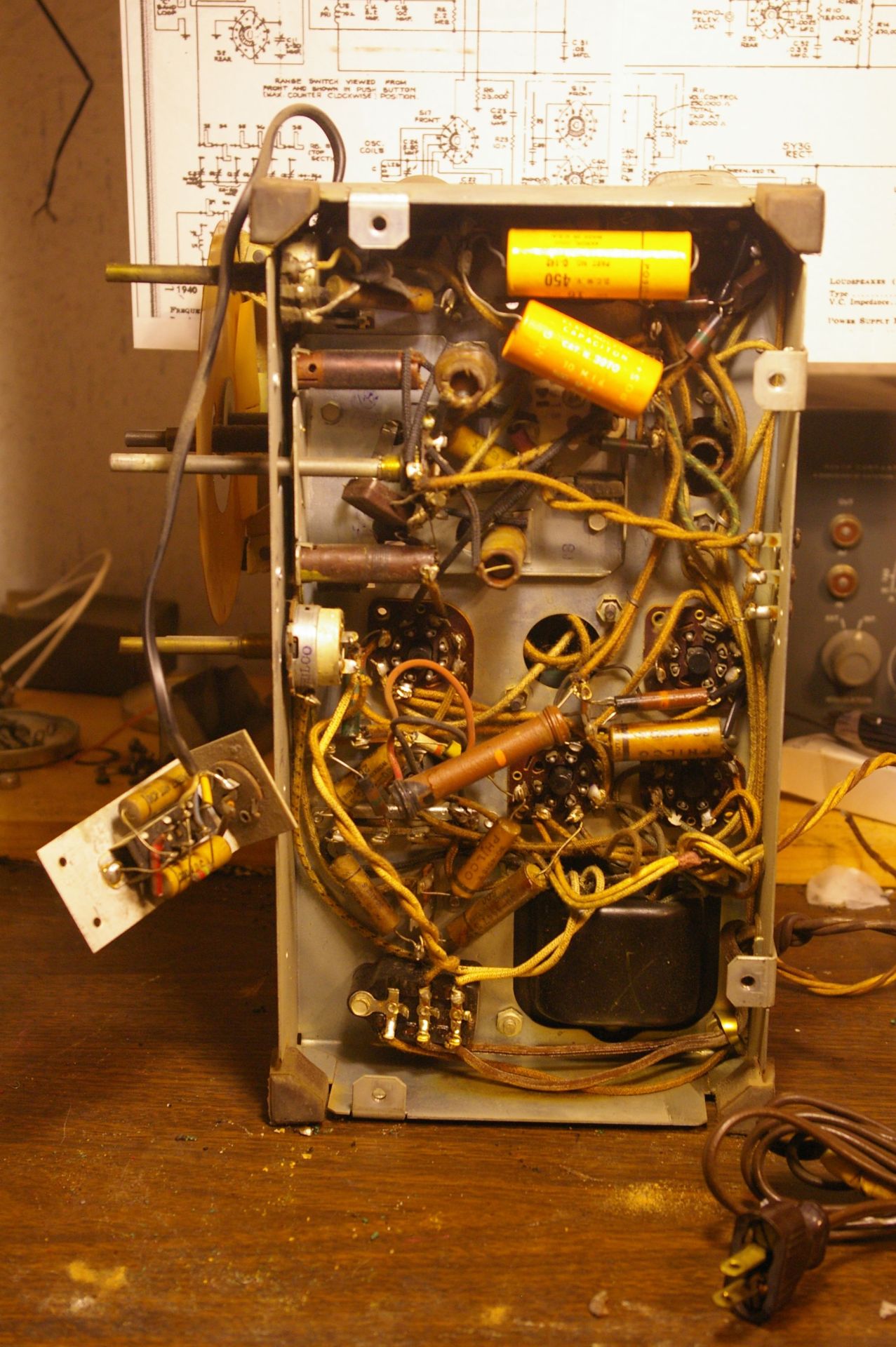

Today I completed the work on the chassis, all paper condensers are replaced. The electrolytics are replaced with the ones I made for this radio. All resistors which were out of spec, or nearly out of spec have been replaced. The line input condensers in the bakelite block have been replaced with safety caps, a new line cord has been fitted and a new wiring loom to the speaker has been made and installed. Next will come attaching the speaker, then testing, and if all goes well, alignment.
[Image: https://64.media.tumblr.com/216a7eb51f5d0d00bb3b4965f0eea0bc/199c5f9cbc5cc98c-16/s1280x1920/38e109c3282a282cbbc4344143618aa49695ff26.jpg]
RE: Philco 38-10 - mikethedruid - 03-25-2021
Last night I connected the speaker to the new wiring harness I made for it, and gave the radio a test. The dial light didn't work, I removed it completely from the radio, de-soldered the wire where it connected to a tube socket inside, and rebuilt the socket. The rubber part inside had deteriorated badly and was stuck do one could not remove the bulb. I finally got the bulb base out after breaking the bulb itself. I made pseudo micarta board by gluing three thicknesses of card stock together with epoxy glue. When it was dry I drilled a little hole through the fake micarta, just big enough to pass the conductor of a new cloth covered 20 gauge wire. I passed that through the little hole, and made a little circle of the wire flat to the board. I then soldered the little circle quickly so as not to burn the board. I then carefully clipped away at the board surrounding the conductor until it was a circle just small enough to easily slip into the metal socket housing. Next I took some heat shrink and ran it right up the wire to the board and shrank it in place. I put back the spring on the wire, slipped the wire into the housing and drew it back, and inserted a new bulb. I connected the wire back to the terminal on the tube socket, and then tested the radio again. The bulb flashed and blew out ! Needless to say the air turned blue for a few minutes, being the old sailor that I am. I then removed the wire again and fired up the radio and checked the voltage. I was read 7 volts, not enough to blow a bulb like that, so I re-installed the wire and socket with a new bulb and tried it again. What do you know, it now worked fine!

RE: Philco 38-10 - mikethedruid - 03-26-2021
Well, the radio is back on the bench and out of the cabinet. I found one problem, a partial short in the wiring around the 6Q7 tube between the hot filament line and the plate ! The routed the wire around the plate terminal, and somehow it must have eventually worn through the insulation. I can see the blackening from the arcing. That would also explain why the dial lamp blew out, and the funky voltage on the filament line.Things still aren't right so I have more chasing down to do.

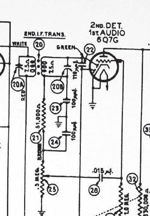

NOTE TO ANY POOR SOUL WORKING ON A 38-10: Part no. 21, the 51K resistor, is INSIDE the IF transformer can. When you take readings for the secondary winding of the second IF transformer, they will always be the actual winding value, in this case about 8.2 ohms, PLUS the 51K resistor! This threw me, and I wondered if my transformer was bad, until I took it apart and saw the resistor inside, and measured across the actual windings, which were both good. I wondered if part no. 21 might be in there, and now I know. Note well anybody who works on these radios; if you get a weird reading on an IF transformer, look inside the can before you freak out. Philco may have hidden something inside. OH ! and that brown paper is held by a resin or wax that melts with heat. Just warm it up gently, and it will peel open, and then warm it back up to seal it back closed.

I have been hunting down the problems which sprang up with this 38-10. If I inject an audio signal at the grid of the 6F6 it comes booming in loud and clear. If I inject it at either the wiper of the volume pot, or the terminal fed from the 2nd IF transformer, I get a lower signal which can be controlled by the volume pot. I believe this means the audio signal is getting through the 6Q7 triode section. Between the side of C22 which is shown connected to the green wire and the high fed terminal of the volume pot, I read a bout 51K, which is what the schematic shows it should be.Here are two pictures of the schematic, the first the full schematic, the second a close up of the area being discussed...

I have checked C22 with my capacitance checker, which shows it well within tolerance, at least at low voltage. Yesterday I took apart the 2nd IF, removed the can to ring out the windings, and found R21 lurking inside. R21 checked out to be approximately correct for 51K. The windings also rang out a little less than 10 ohms, and seemed about right. I didn't check C23 or C24. I am getting no feed through of a modulated IF signal when I inject it at the antenna input, or even if I inject it at the green wire side of C22, or the other diode plate for that matter. It is not demodulating it and converting it to audio. I wonder, could the problem be with C22, C23, or C24? Any ideas? Yes, I have even swapped out the 6Q7G just to be sure it wasn't the tube. Any help or suggestions will be appreciated.
RE: Philco 38-10 - mikethedruid - 03-30-2021
This evening I again took apart the can of the 2nd IF transformer. I didn't remember seeing any capacitors inside there, although at the time I was busy checking the winding continuity. Again. the windings were fine, the resistor R21 was fine; but, as I remembered, there were NO OTHER CAPACITORS in there besides the two variable caps on the top of the porcelain cap. There is a green and yellow wire attached to a lug on the top porcelain with the two variable caps, which I surmise should be the central grounding wire between caps 23 and 24, but there is NO SIGN of caps 23 or 24! I know the radio DID work when I first tested it, so it was working without these capacitors. What purpose do they serve? Why would they have been left out of my radio? Did Philco often make undocumented changes? This must be fairly early production because R11 was still a 70K resistor, and that was changed to a 40K later in production to improve oscillator production. (I have made the change) This is a very curious radio !
