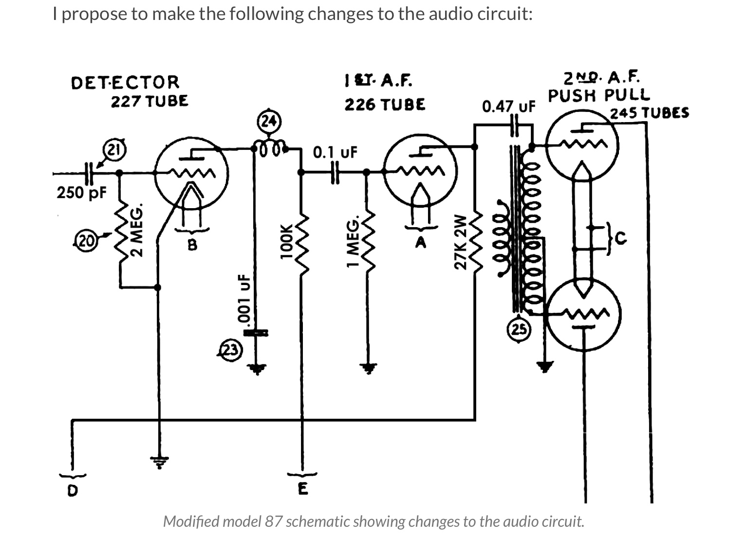

Thanks for the info! In doing some more measurements, I found that I missed something obvious…. No plate voltage on the 1st A.F. 26 tube. Could have sworn I checked all my transformers but I missed an open primary on the push-pull input transformer. Would this have that much of an effect on the rest of the voltages?
Next question….. Can I use the same workaround I saw used on an Philco 87 driving a pair of 45’s on Ron’s Radio website?

If the secondary of the interstage transformer is good, Ron's "bridging technique" should work great. I have a Philco 20 with a good transformer, but I am going to attempt to RC couple that one.

RodB - 02-07-2023
Should that coupling cap be .047mfd?
RE: Philco 86 Voltages -
Ron Ramirez - 02-07-2023
No.
0.47 uF is correct. You might get by with 0.22 uF with some loss of fidelity.
Tiddat33 - Thank you, I'm glad someone is actually reading my blog site!
![Icon_biggrin Icon_biggrin](https://philcoradio.com/phorum/images/smilies/icon_biggrin.gif)
And, yes, you may use the audio transformer workaround if you need to.

RodB - 02-07-2023
Thanks for clarification, Ron. I had read the post some time ago but the value seemed high.

The faint volume, is that with the open interstage transformer primary or have you "bridged" it using the Ramirez Technique? If low because the xformer is open, then replacing it or "bridging it" will resolve.

I have to say that my Philco 87 with "bridged" audio transformers (i.e. converted to resistance-capacitance coupling) has plenty of volume, no problems. Yes, conventional transformer coupling will give you a bit more volume, but in an otherwise properly restored radio, you won't miss the extra "oomph" of an interstage transformer with resistance-capacitance coupling.

The faint sound is with the transformer primary open…. Still waiting on the parts for the RC coupling.
