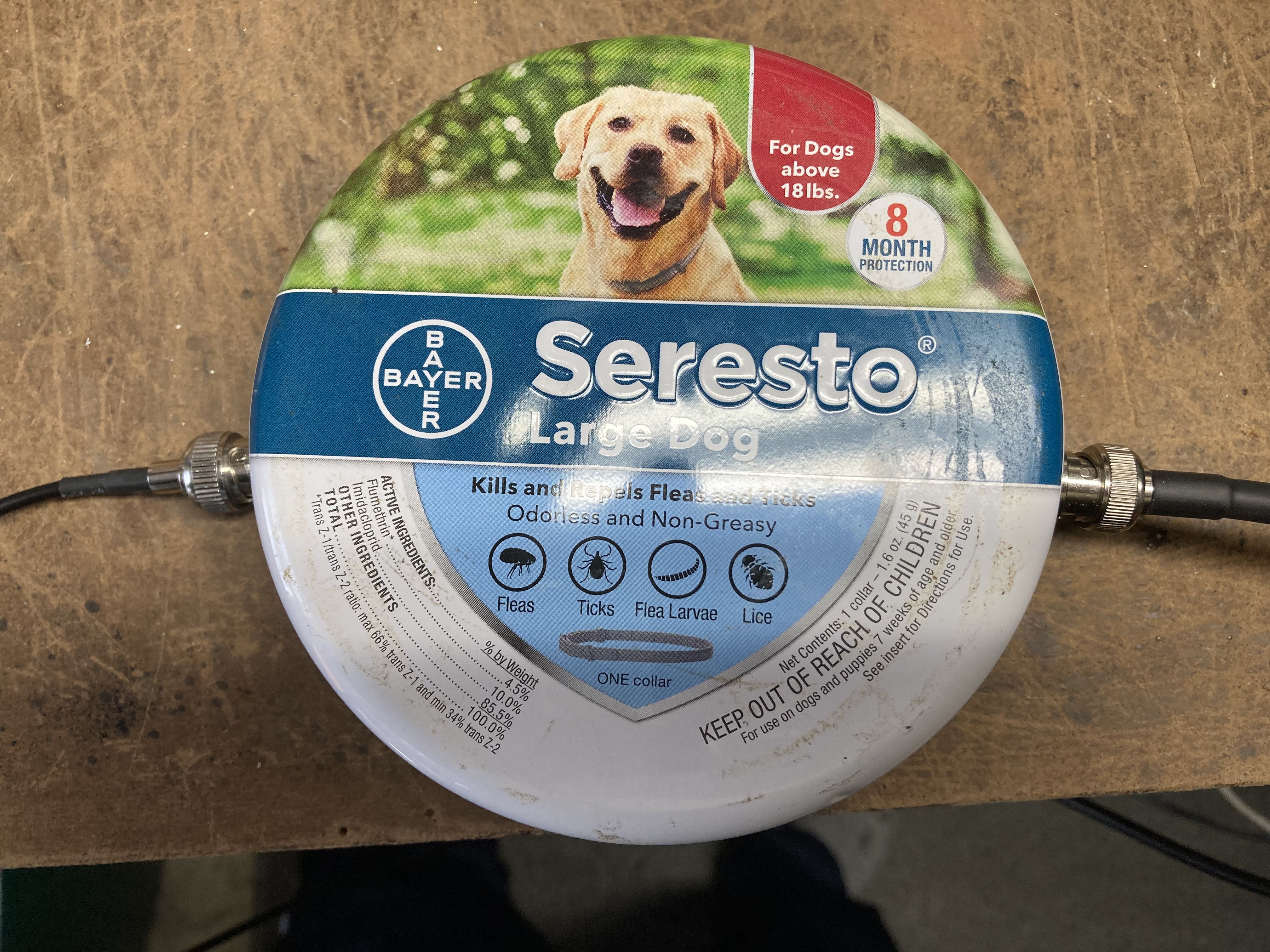

Getting back finally to my Heathkit sweep marker generator which appears to have a bad increductor. So I have since bought a Eico 368 generator. Part of the setup requires making what they call is broad band detector. It should be in a shielded box so I improvised with what I have.  Icon_lol
Ron
