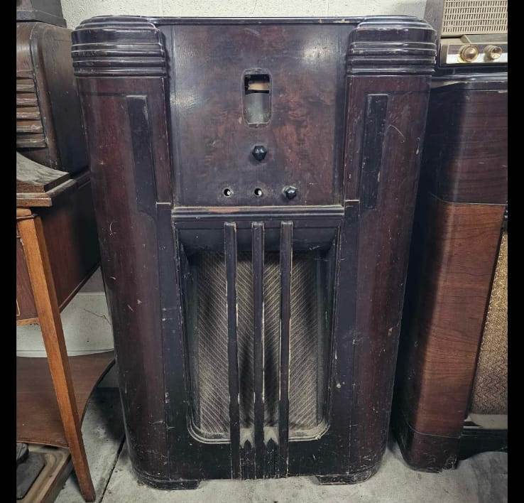

I'm preparing an old Philco 16X radio console from 1934 for restoration, which unfortunately is in pretty bad condition, but the worst thing is that I need to find a lot of spare parts. Two control knobs are missing, the scale escutcheon is missing, the scale itself is in very poor condition, the output pentodes of type 42 also have weak emission... But the biggest problem is the field coil on the speaker is broken.

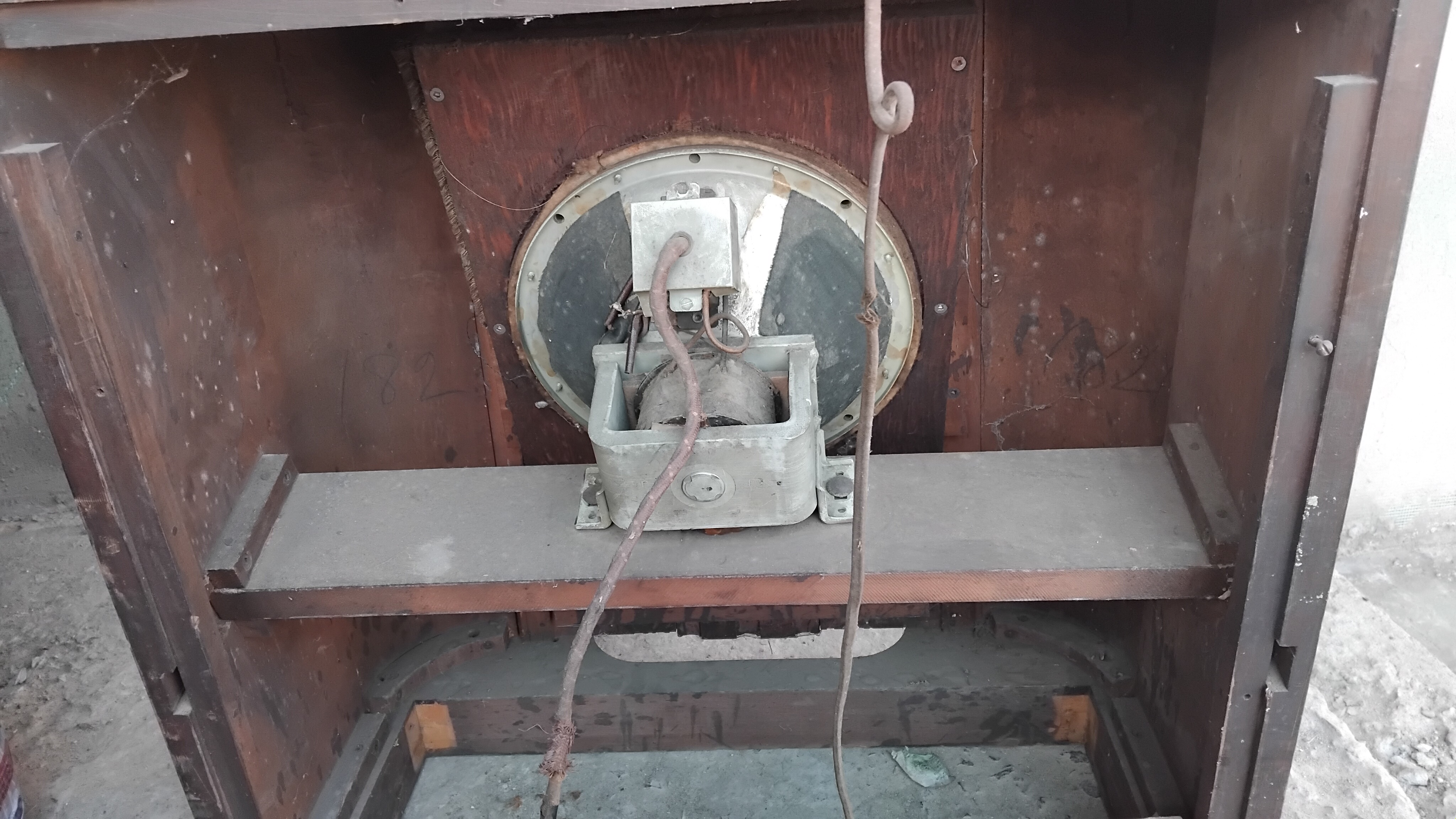

Arran - 06-05-2025
Peter;
I believe that the "A" suffix means that it has as 25 cycle power transformer, not all Canadian sets had those but many did. It should not be a problem operating it from a 50 cps power line though, I would guess that you are using a step down transformer, or autotransformer to drop the 230-240VAC down to 120 VAC since you have a number of North American radios in your collection already? I have to do the opposite with a British Kolster Brandes set, it's 200-250 VAC input, so I'm going to use a ballast from a metal halide lamp to step up the 120 to 240 VAC, I just wish I could find a BS 1362 outlet so I can use the original power plug with it.
That speaker looks like it should be rebuildable, the cone is held on with a metal band that is screwed onto the basket, so it should not be too difficult to remove. A bit of acetone around the rim will take care of any cement or paint holding it in. Then it's a matter of getting the pole piece out of the rear bracket. Hopefully it's just a broken wire and isn't burned out, or corroded.

RadioSvit - 06-27-2025

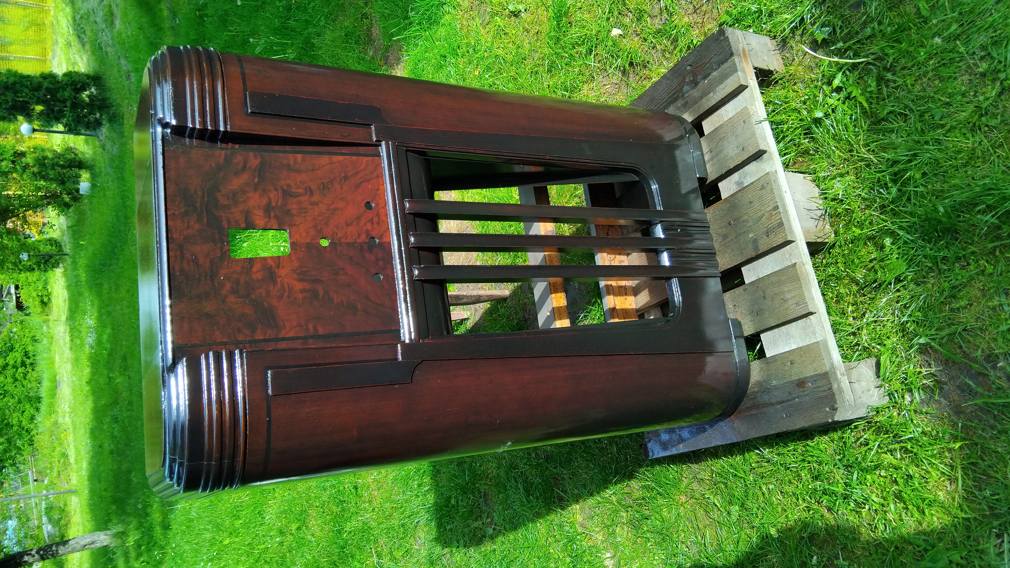

Do we rejoice in our mistakes? I'm sure we'll all say "No", when we make them we always get upset... But I don't remember being so glad when I realized - I was wrong! Yes, I was wrong when I rejected the field coil of the speaker on the Filco 16 X, it turned out to be intact.
But the primary winding of the output transformer is broken
, but this problem is much easier to solve. Well, I can start repairing the chassis when I have free time.

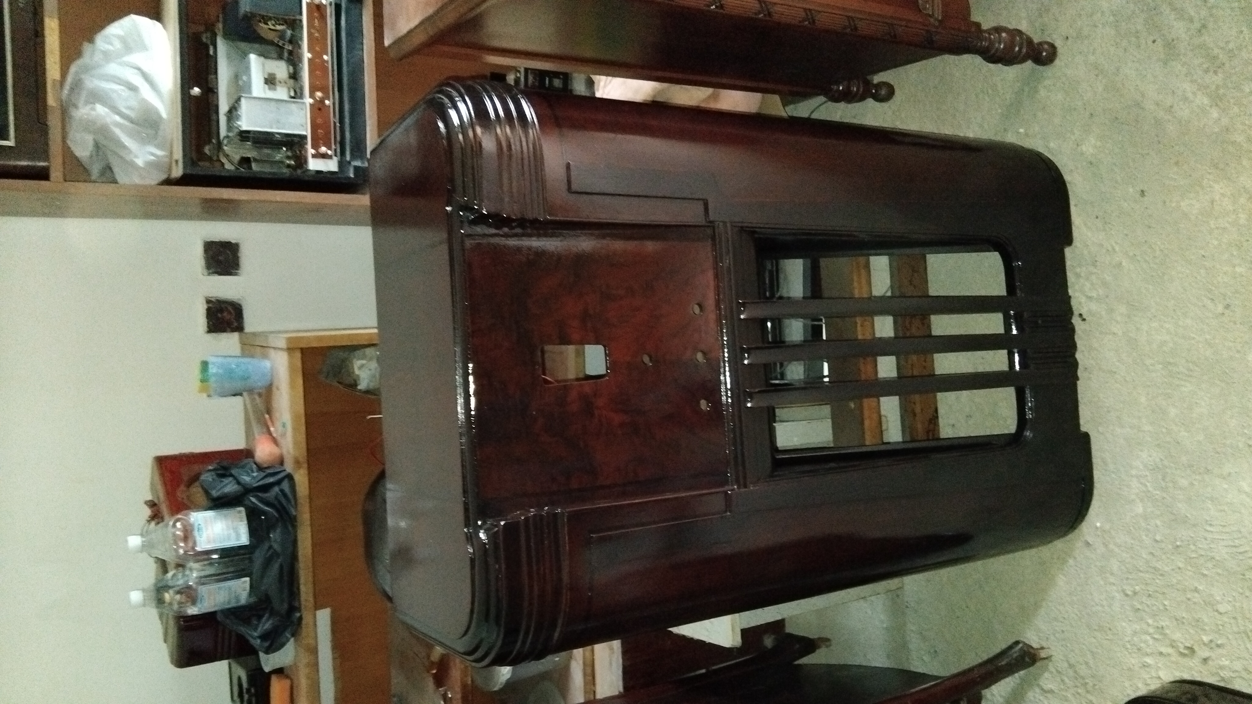

By the way, - I've already restored the case...
PS. Special thanks and apologies to Terry, it seems that I don't need another speaker anymore. Sorry, Terry.

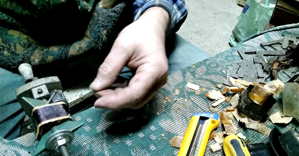

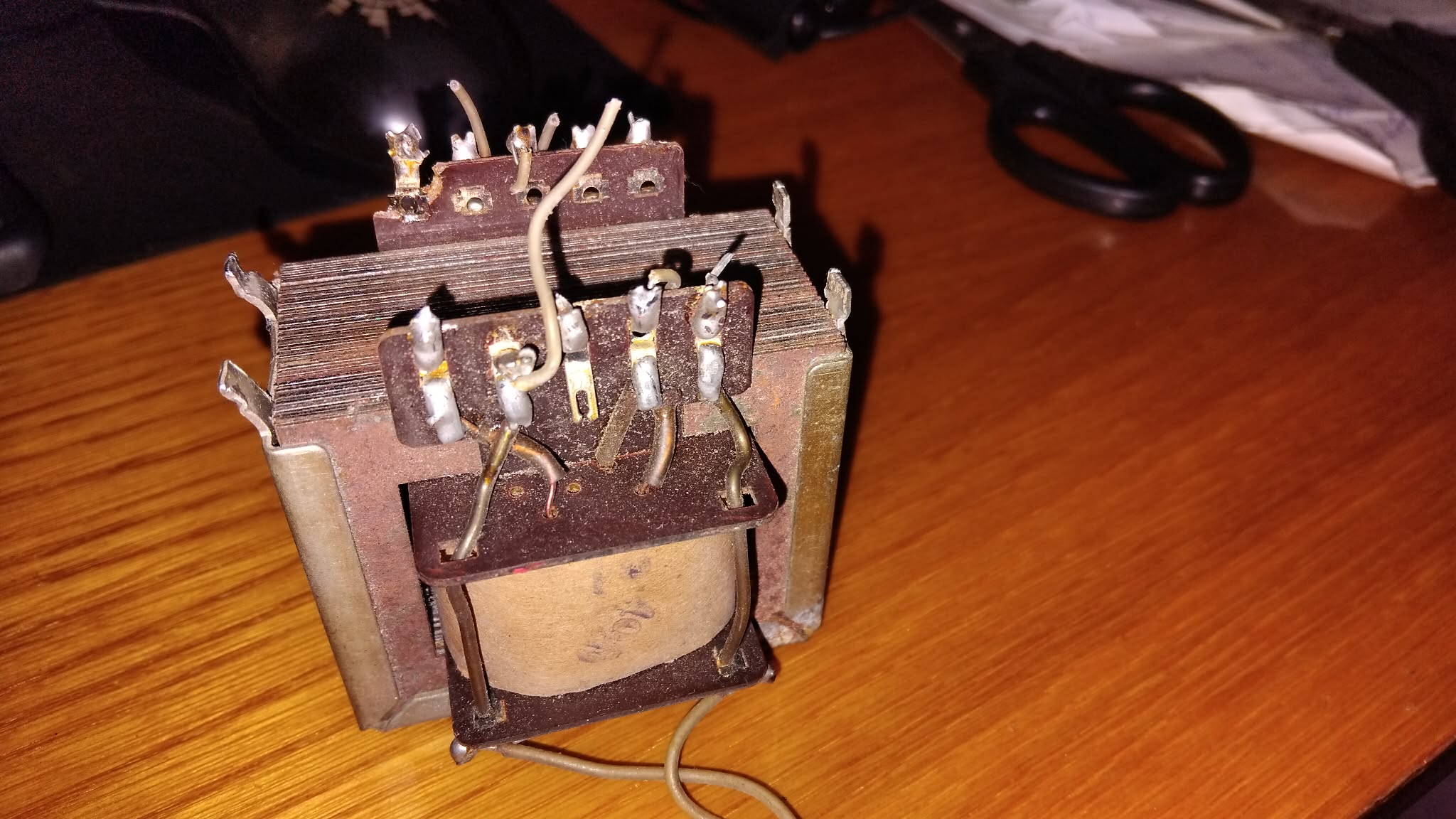

Hello everyone. I haven't been active in this topic for six months, but during this time I have been quite actively engaged in the restoration of this Philco. In the winter I solved the problem with the worn anode winding of the output transformer. I simply disassembled this transformer and using a simple device with a counter, I unwound and counted the number of turns of the secondary and primary anode coils of the transformer.
The anode primary winding has 2800 turns of wire with a diameter of 0.16 mm or 0.064 inches. The secondary winding has 55 turns with a diameter of 1.0 mm or 0.4 inches. Thus, I calculated the transformation coefficient, which is equal to 50.9.
Over the years of repairing and restoring tube radio equipment, I have accumulated a lot of output transformers from Soviet radios and I was surprised when one of the transformers turned out to have exactly these characteristics, and its ferromagnetic core has even greater thickness and volume, and therefore better inductance and hysteresis characteristics. Therefore, I will probably use this transformer, and not wind the transformer from Philco. Well, at least temporarily, because I don’t have the 0,16 mm thick wire I need right now.
And finally, this winter I made a video on the restoration of this Philco cabinet. Six months after the restoration itself was completed
[Video:
https://www.youtube.com/watch?v=vdnVphG-HO4&t=1234s]

morzh - 03-08-2026
From the photo, the winding looks like it sustained some real high temp event. Is this it or is it just the lighting?
RE: I'm starting to restore a Philco 16X, I need spare parts. Please, help me find it -
RadioSvit - 03-08-2026
That's right, Michael. The winding must have been very hot because not only the varnish but also the wire itself was very brittle due to overheating.
morzh - 03-08-2026
Could be the output tube short. Not sure what else would result in this.
