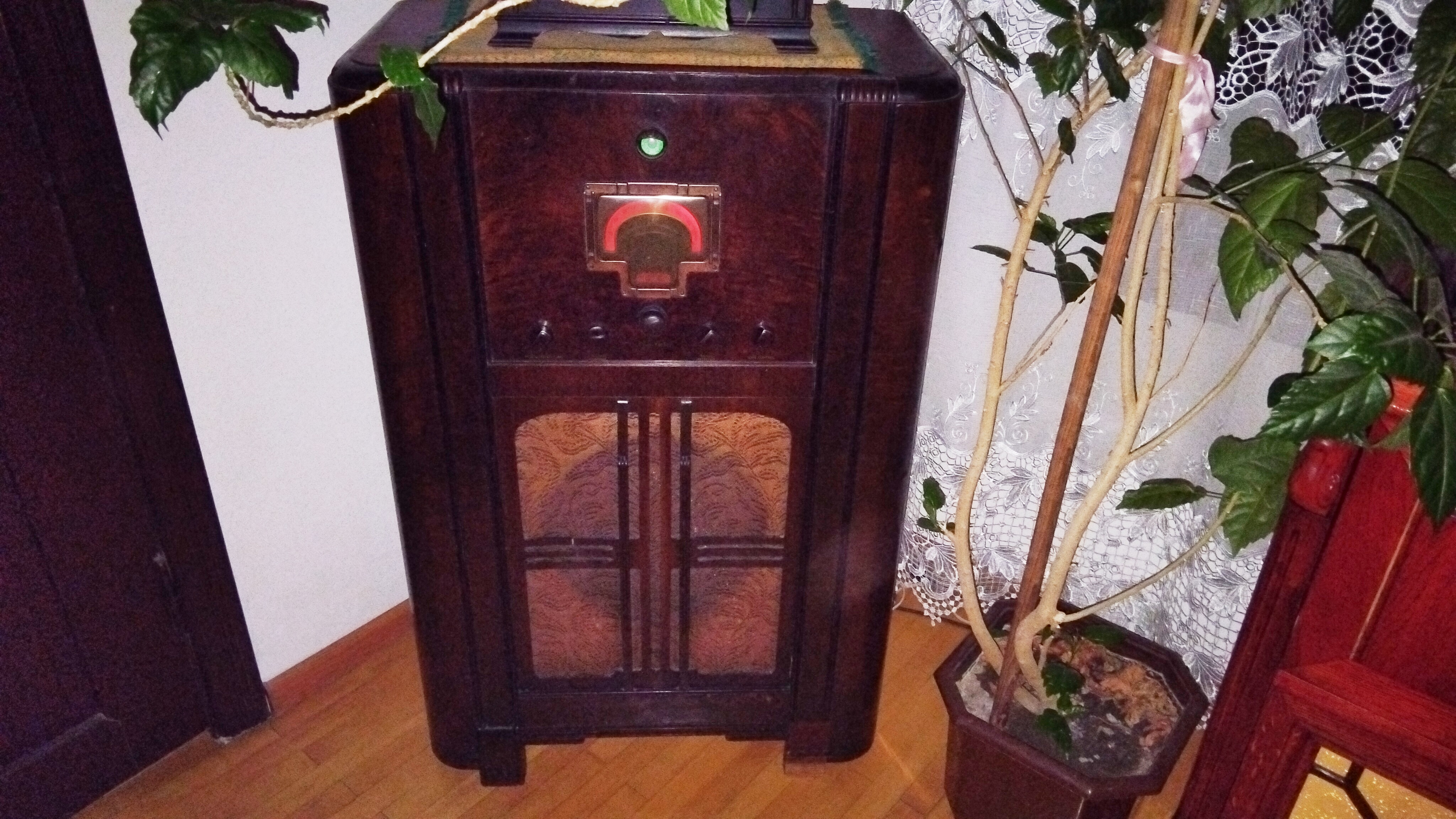

After applying the filler to the entire body, I noticed that the shades of the facade and the side and top walls were very dissonant and I didn't like it.
I had to choose tinting stains and tinting varnishes for a long time until I managed to achieve harmony ...
Below is a link to four videos of the entire restoration process (if someone has the patience to watch everything), and for all normal people who value their time, I'm giving a photo of the body after all the work is completed.

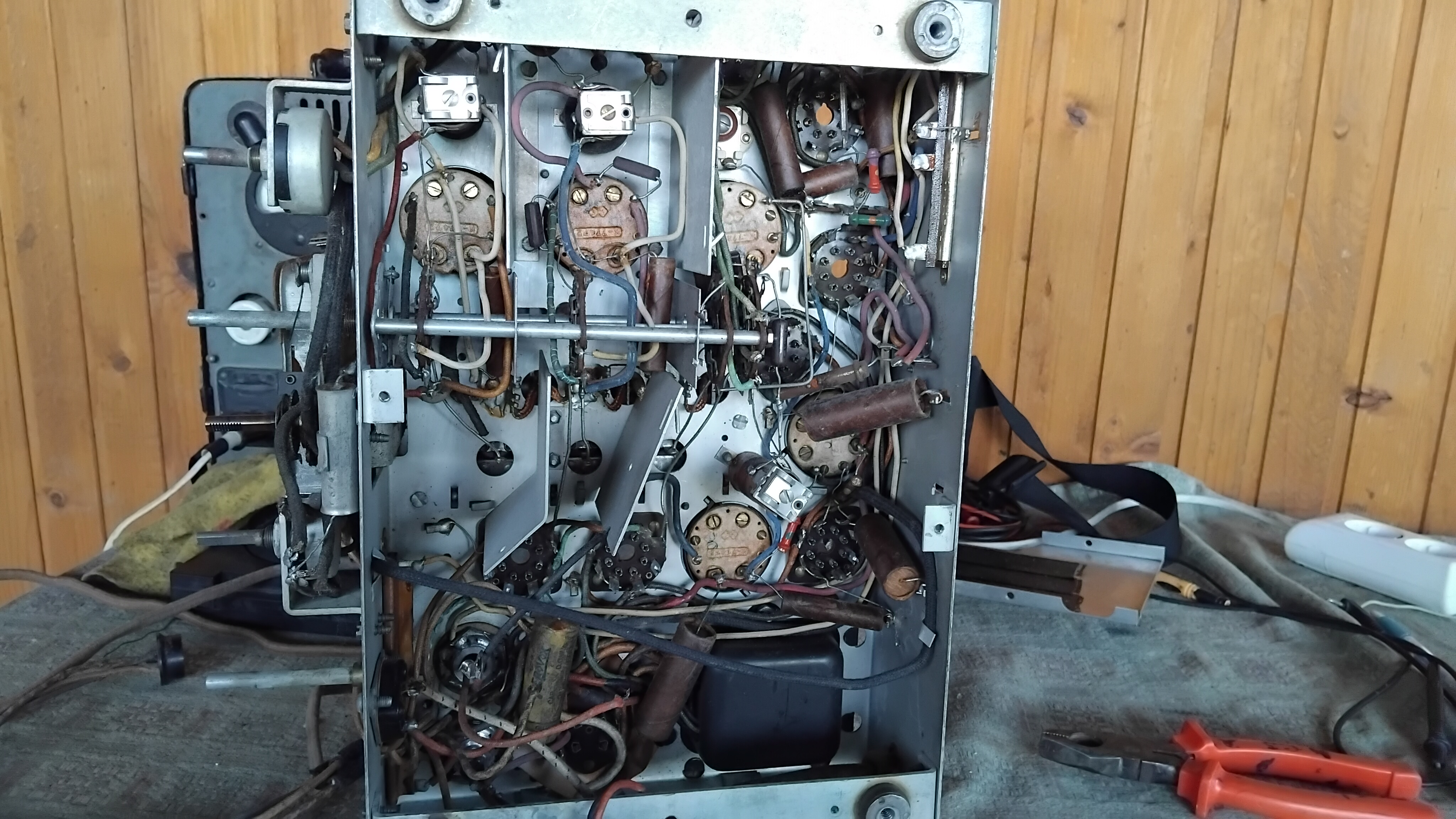

Well... While the varnish is drying up, I started repairing the chassis...

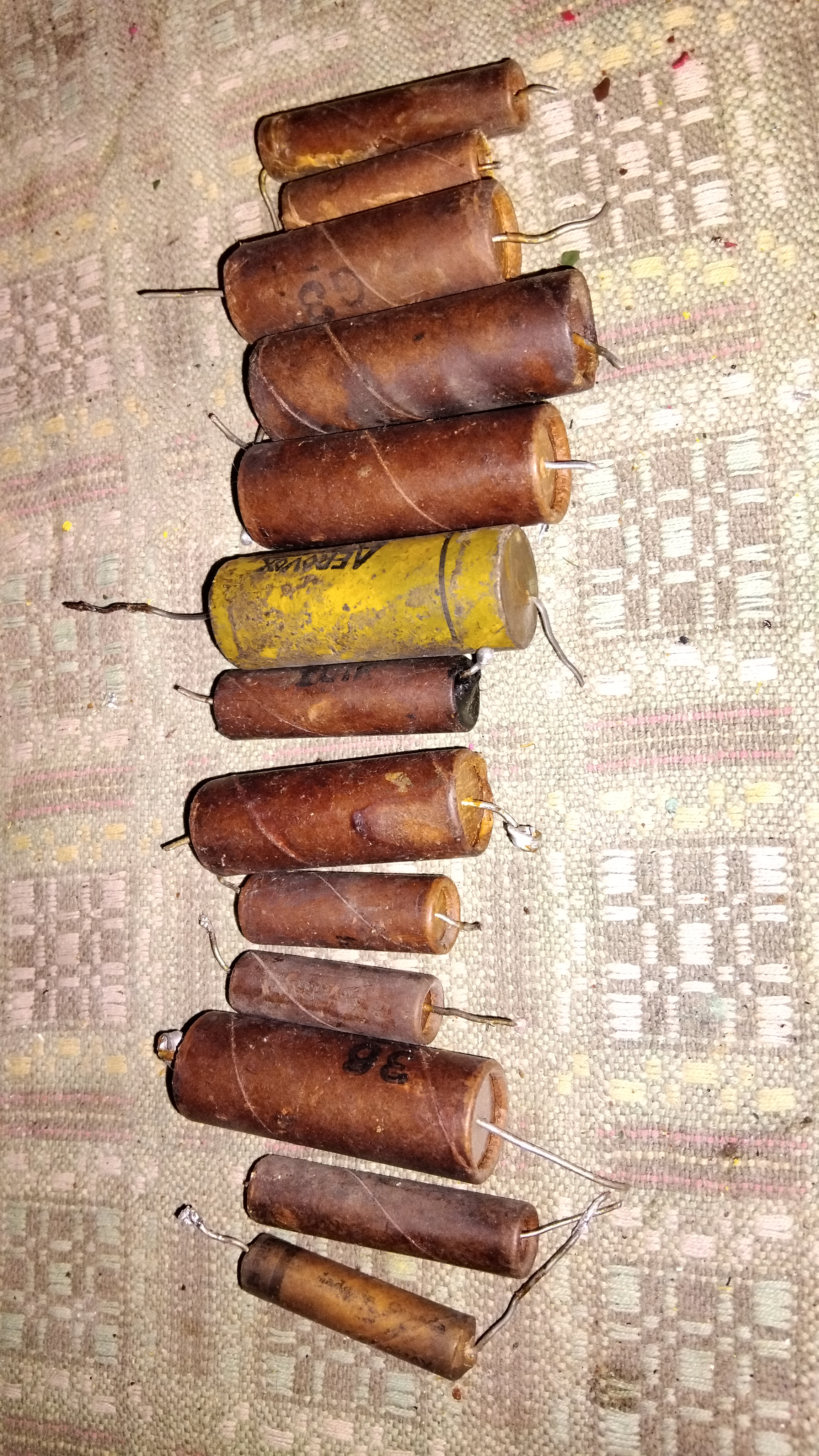

Of course I started by replacing the paper and electrolytic capacitors...

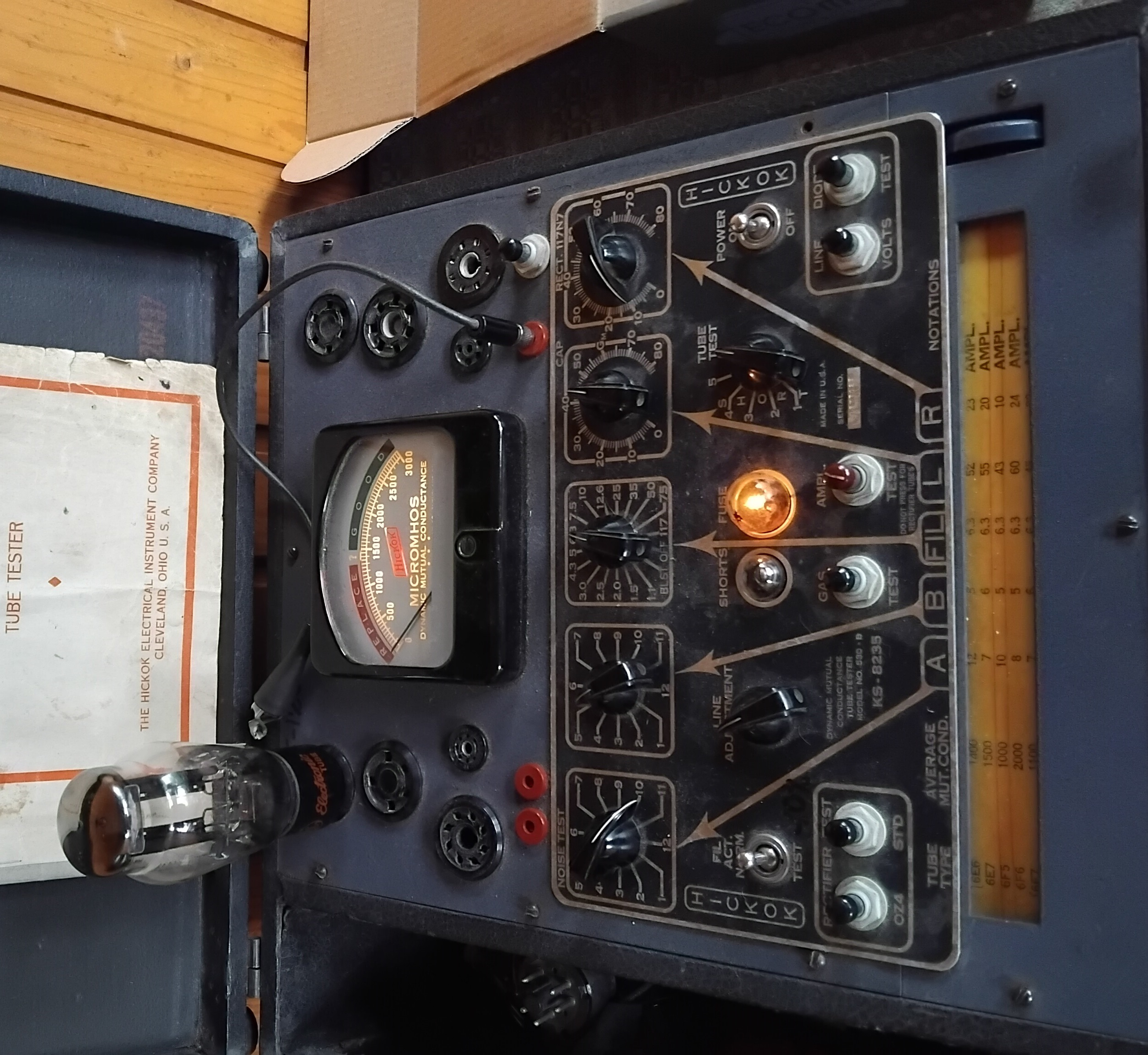

I also checked all the radio tubes on my Hickok 530 tube tester. The 5Z3 kenotron turned out to be faulty, all the other radio tubes are good.
True, attentive readers will immediately see my mistake - when I took the photo, I forgot to switch the tester settings to the 5Z3 measurement mode and the settings remained on the measurement of the previous 6f5 pentode radio tube.

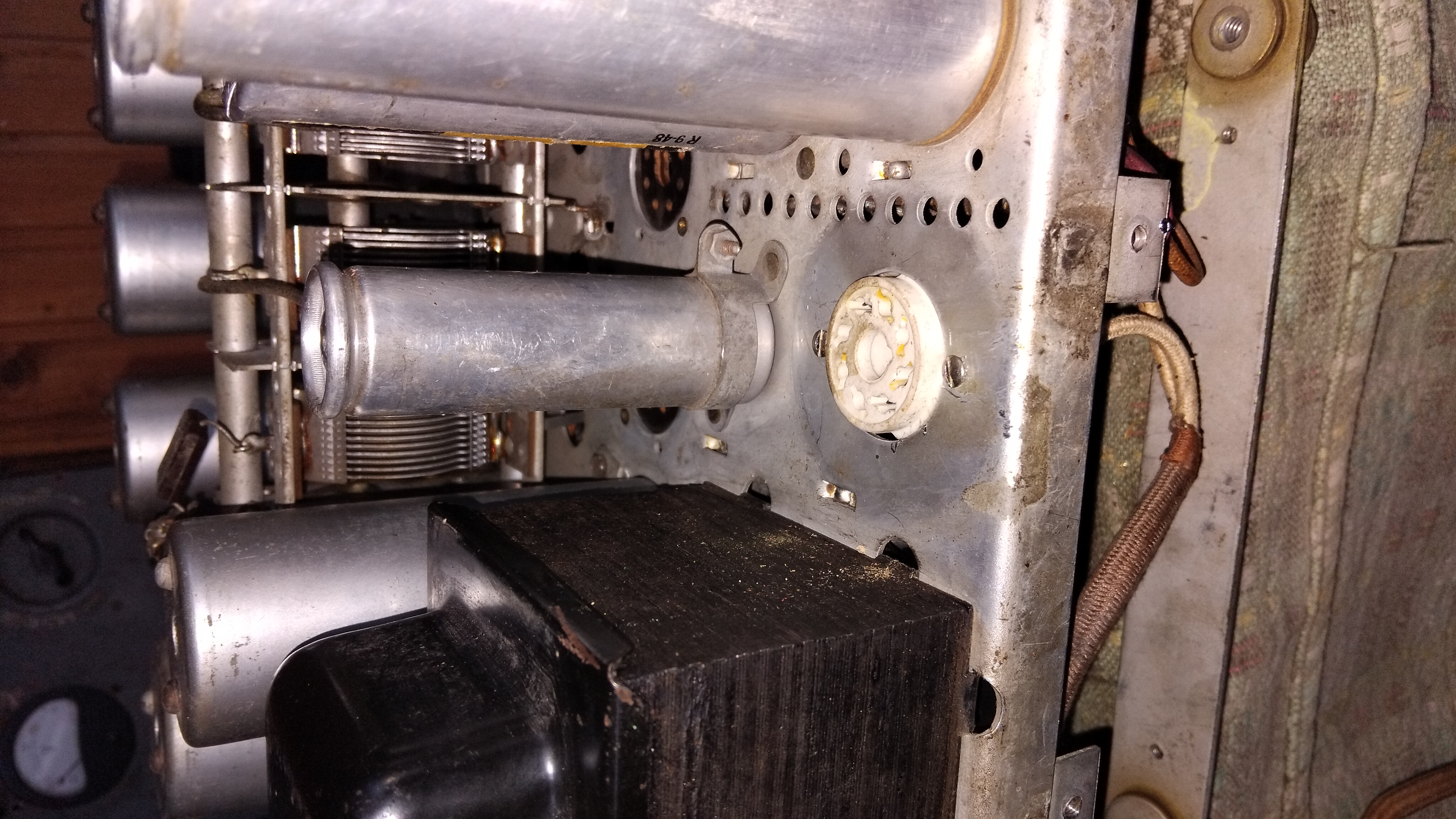

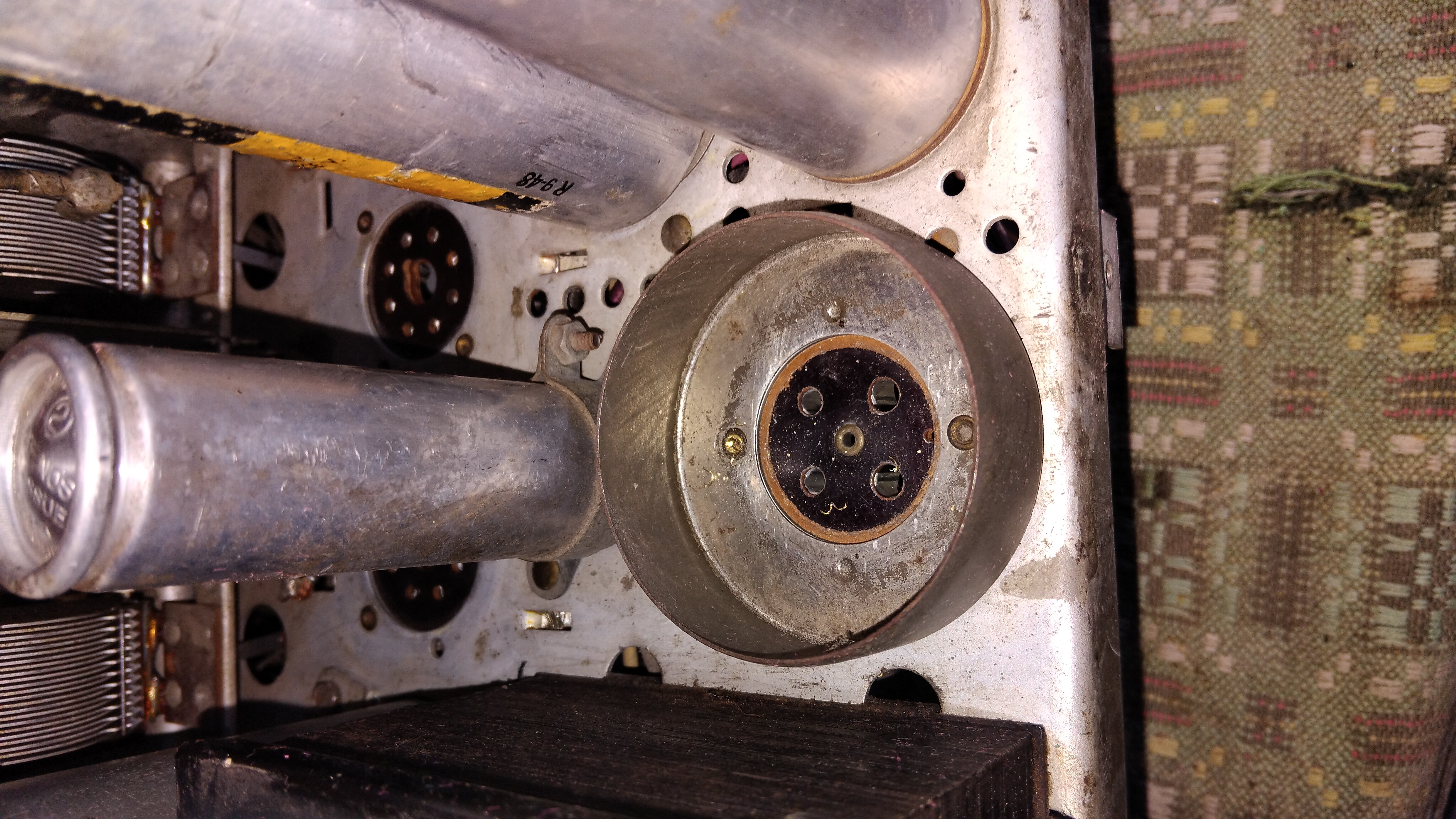

The problem with the 5Z3 box turned out to be more complicated than I thought - I don't have it. But there are many Soviet analogues of the 5Z3, but with octal sockets. So I had to replace the 4-pin socket with an octal one.
It was ...
It became ...

I think that I would have been more inclined just to make a 4 pin to octal adapter out of the base of the 5Z3 tube, we have an odd rectifier tube/kenotron that Rogers made here called a 2X3, and it is half of a 5Y3, both in pinout, and electrically, so you need to make adapters, or change sockets for those. They used pairs of octal sockets but Rogers removed the contacts from the sockets that were not needed for the 2X3s, so you can't put a 5Y3 or 5Y4 in there just by rewiring one of the sockets. I'm surprised that the C.G.E A-87 used a 5Z3, a type #80 or 5Z4 would have been more common then, a 5Z3 is like a four pin 5U4, which was normally used in larger sets with push pull output tubes.
That type of paper capacitor, with the rolled over ends, is one of the easier types to restuff, if original appearance is important. You can get the capacitor out by placing a mechanic's socket, of appropriate size on the bench, place one end of the capacitor on top of the socket, grasp the body of the paper tube, press down over the socket, and the inner part will pop out of the top.

Arran , pdieten... Guys, I am also very surprised that a rectifier radio tube with three times more power than is enough for this circuit is used here. A rectifier radio tube of type 80 or 5Z4 is really more than enough here. But they are also 4-pin and in Ukraine are extremely rare and expensive. But we have many Soviet analogues of these radio tubes with an 8-pin base here. So that is why I replaced the 4-pin socket with an 8-pin one and then I will be able to use the Soviet analogues of 5Z4 without any problems. Today I am finishing the chassis repair and in the near future I will show the final photos after the repair

There’s nothing wrong with switching to an octal socket for a 5Z4. Typically if I’m restoring a set like this I try to reinstall the shield base and shield to retain the original topside appearance. But if that isn’t possible, then so be it.
