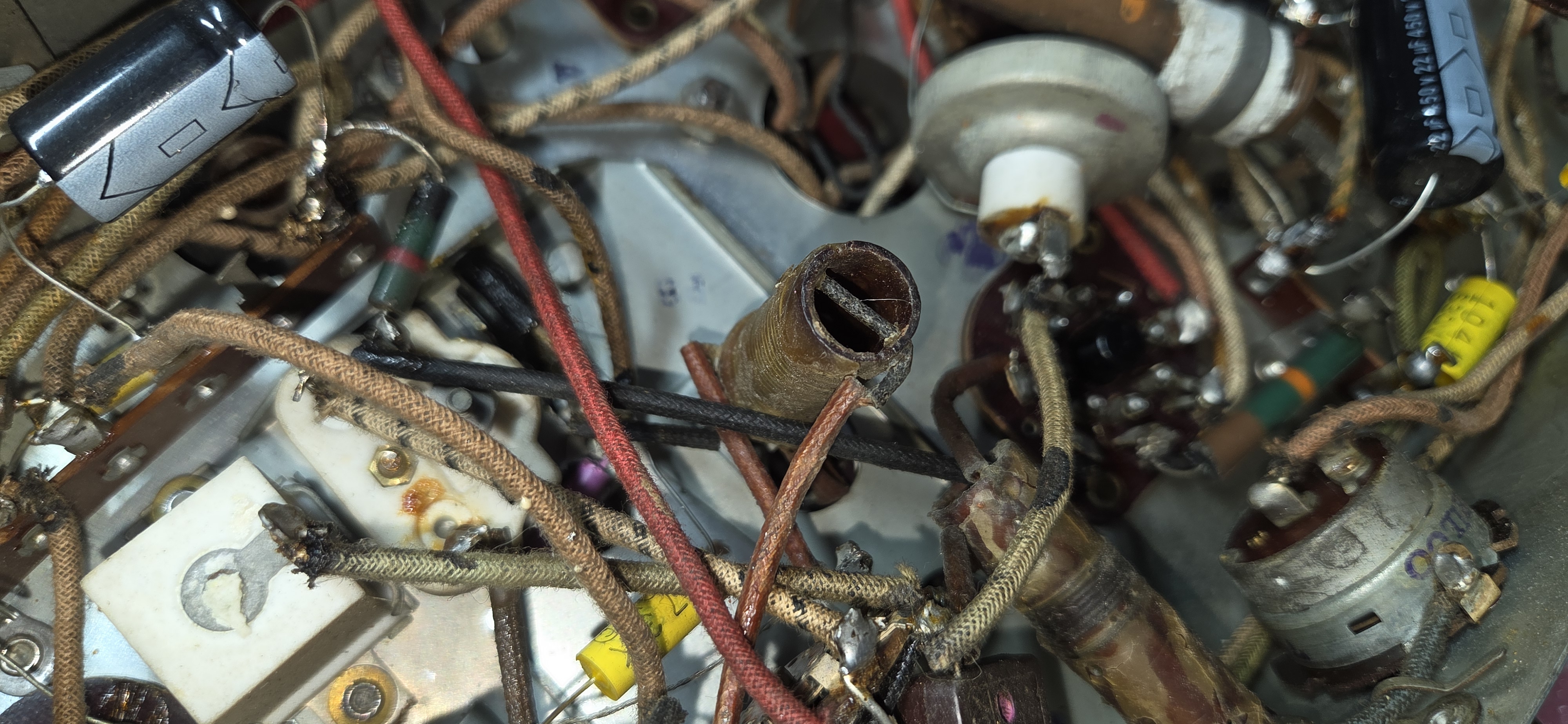

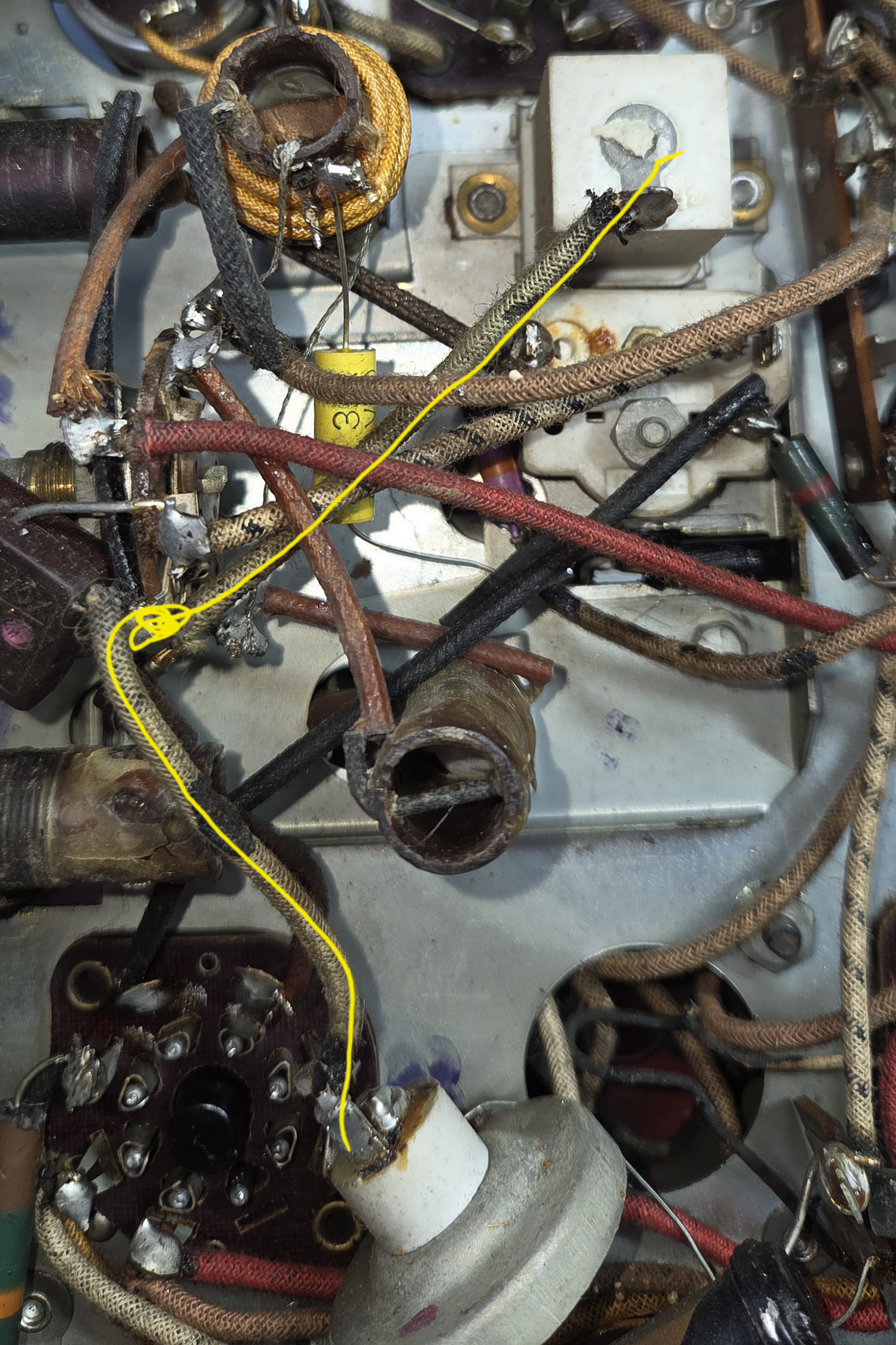

All,  I'm restoring this radio and found something I've never seen before.  It has a round metal case that is grounded,  has one wire going to the A3 Bandswitch contact... and that same switch contact also has a wire going to the square ceramic Compensator (see my yellow drawn line).
Can anyone tell me what it is ... and what symbol it is the schematic?

This is a good question, to me it looks a bit like a doorknob capacitor, but with terminals for soldering. However it has a metal case, that you say is grounded? An RF choke of some sort? That cloth covered wire winding around the outside of one of the coils has me curious too. It has the hallmarks of being "Hammed". By the way the 1936 and newer Philco models had brown rubber power cords, even though the cloth one looks cooler.

I think that is a thermal capacitor that is undocumented. Notice how close it is to resistor #12 , 10K 3 watt? As the resistor heats, the capacitance changes to prevent the oscillator from drifting.
Hope this helps.

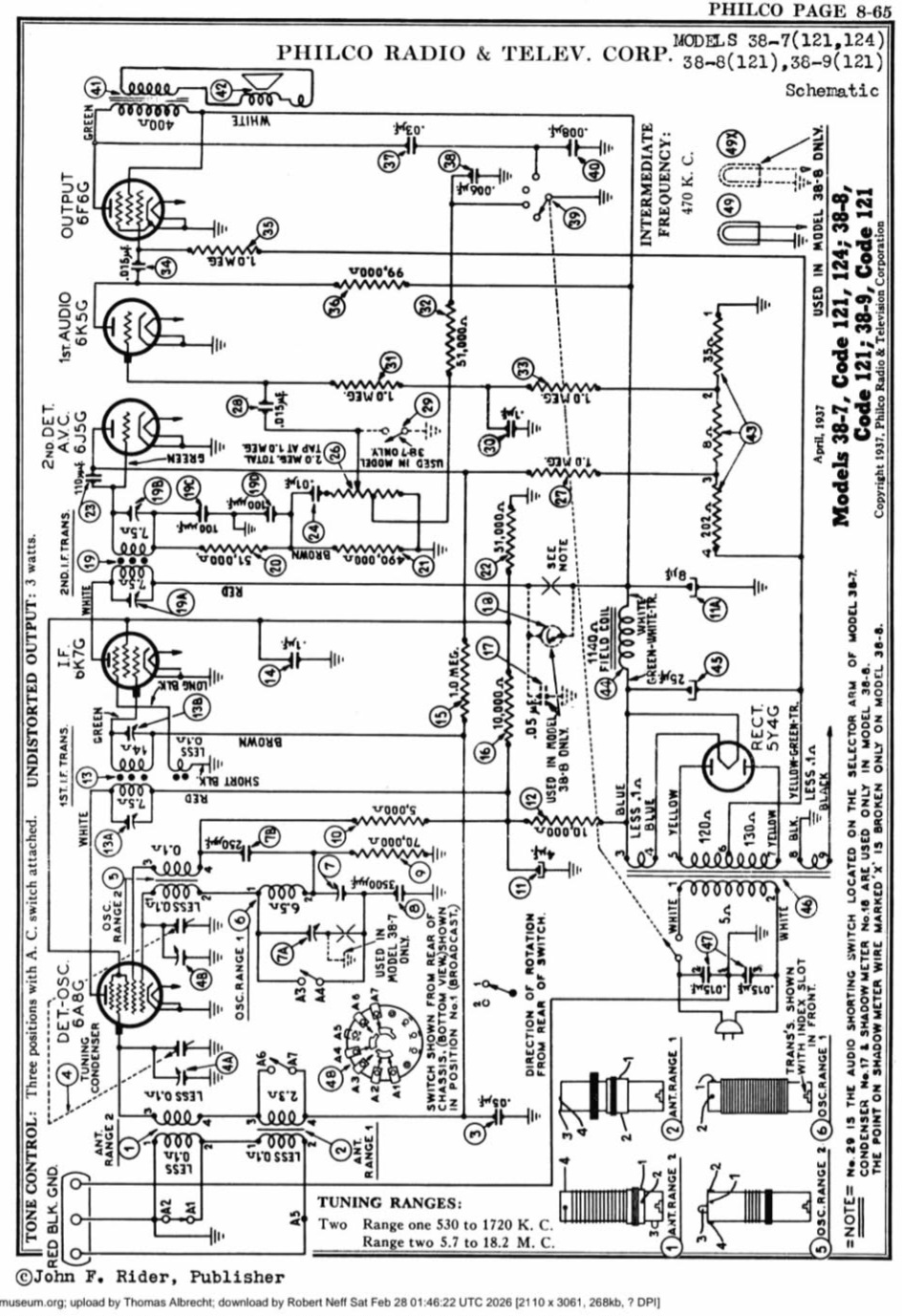

Ed, that would make sense.  I'm thinking you are correct.  I should have included the schematic ... which I'll do here. Do you see it in the schematic?
I'm thinking it's the dotted line ground symbol that says "used in Model 38-7 only".  Though I still don't understand what it really does.  When it gets warm enough,  it grounds that line??

It is documented in the Philco service manual (38-7, codes 121 and 124, is on pp. 113-116).
Part 7A on the schematic is shown as a "Compensator Model 7 (1500 KC)," and is Philco part 31-6196. What you show in the photo, though, does not look like a compensator, which is a trimmer capacitor.

The square ceramic object is most likely a padder condenser, which is for the tracking on the lower end of the dial, in some sets they call it a "600 padder". This temperature compensating device is certainly an oddity, I have run into zero temperature co-efficient caps in some Rogers built sets, but not one that intentionally varies with temperature, not in an 89 year old radio. I would guess that Philco must have have produced them in house as I can't recall seeing them in anything else, on first glance I thought maybe someone was playing around in there, I've seen chokes and other things added before to try and quash some interference, or sub another defective part. Someone was doing that with the antenna coil, either the primary is open or someone was experimenting with it in some way.

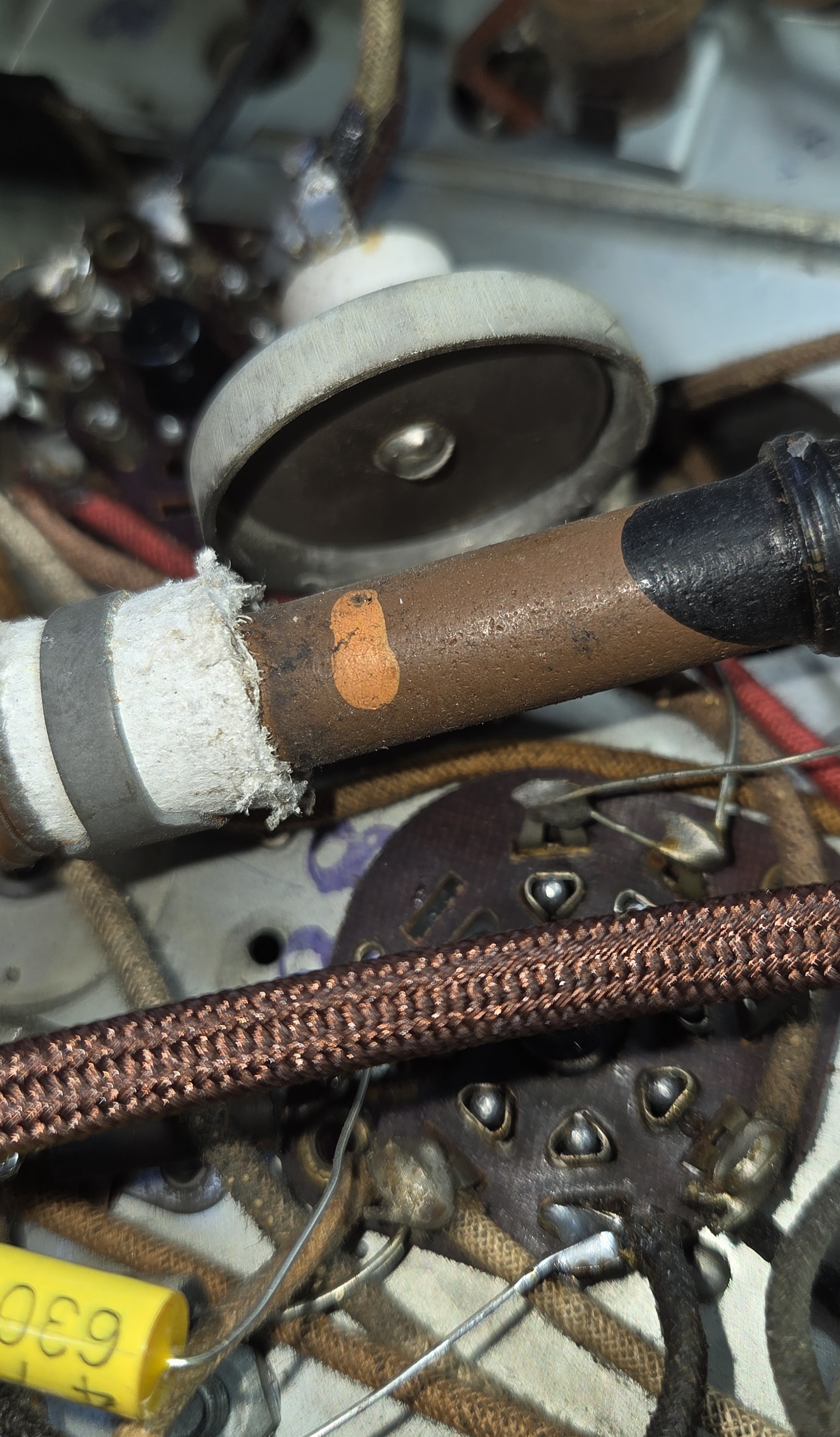

The antenna coil ... could a tube have shorted and pulled enough current through the coil to fry it a few turns from the end?
I recently restored a 1938 Motorola 9A Ch=9-3 Chairside and it had the first IF coil partially re-wound. I was told by someone who restores a lot of 30's radios that it's a fairly common issue when a tube shorts in the first or second stage.
RE: 38-7 Chairside - What Is This? - Arran - 03-11-2026
Lightning could have been the culprit, if it looks burned, or some form of mechanical damage to the winding. The tubes themselves seldom short, and the shorts are usually between one grid, and another, or between the heater and cathode. What can cause an IF winding to fail might be the IF amplifier tube being biased improperly drawing excessive current through the primary, possibly due to a leaky capacitor, which is usually connected between the B+ and the plate of the IF amplifier tube. Sometimes they fail for mechanical reasons, like the wire physically breaks, or corrodes.
