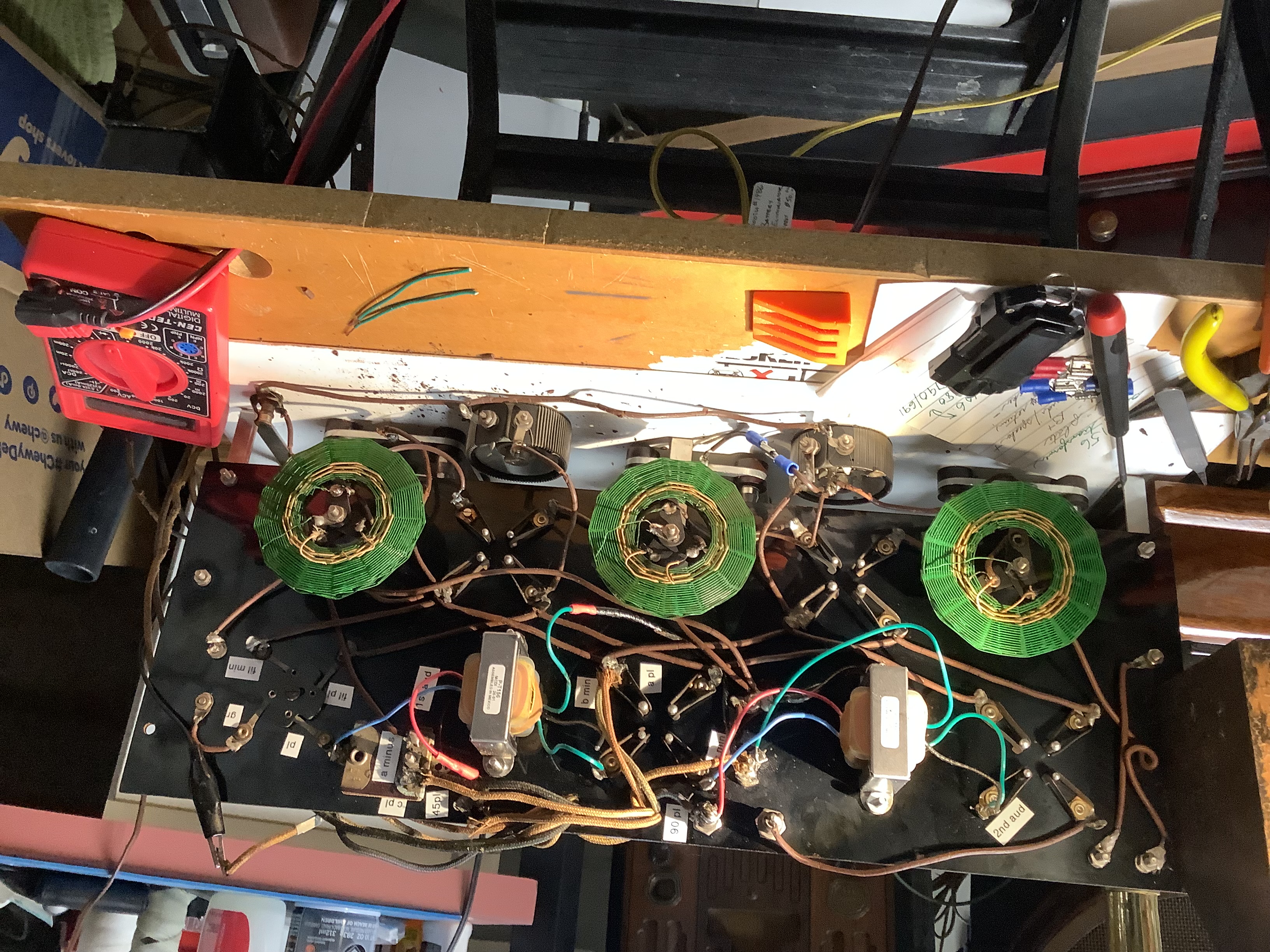

Hi Guys,
I picked up a Montgomery Ward Airline “Enchanter” U-15 from the 1920s with some issues. The second tuning capacitor is stuck and has resisted numerous efforts to have the shaft move in the brass collar. If necessary I think I can block the stator and have the collar move inside the metal chassis face. Thoughts?
Also both audio transformers are open. Any idea what to use for replacements and where to get them? I’ve counted on AES for supplies in the past but haven’t been able to access the new address after they reorganized.

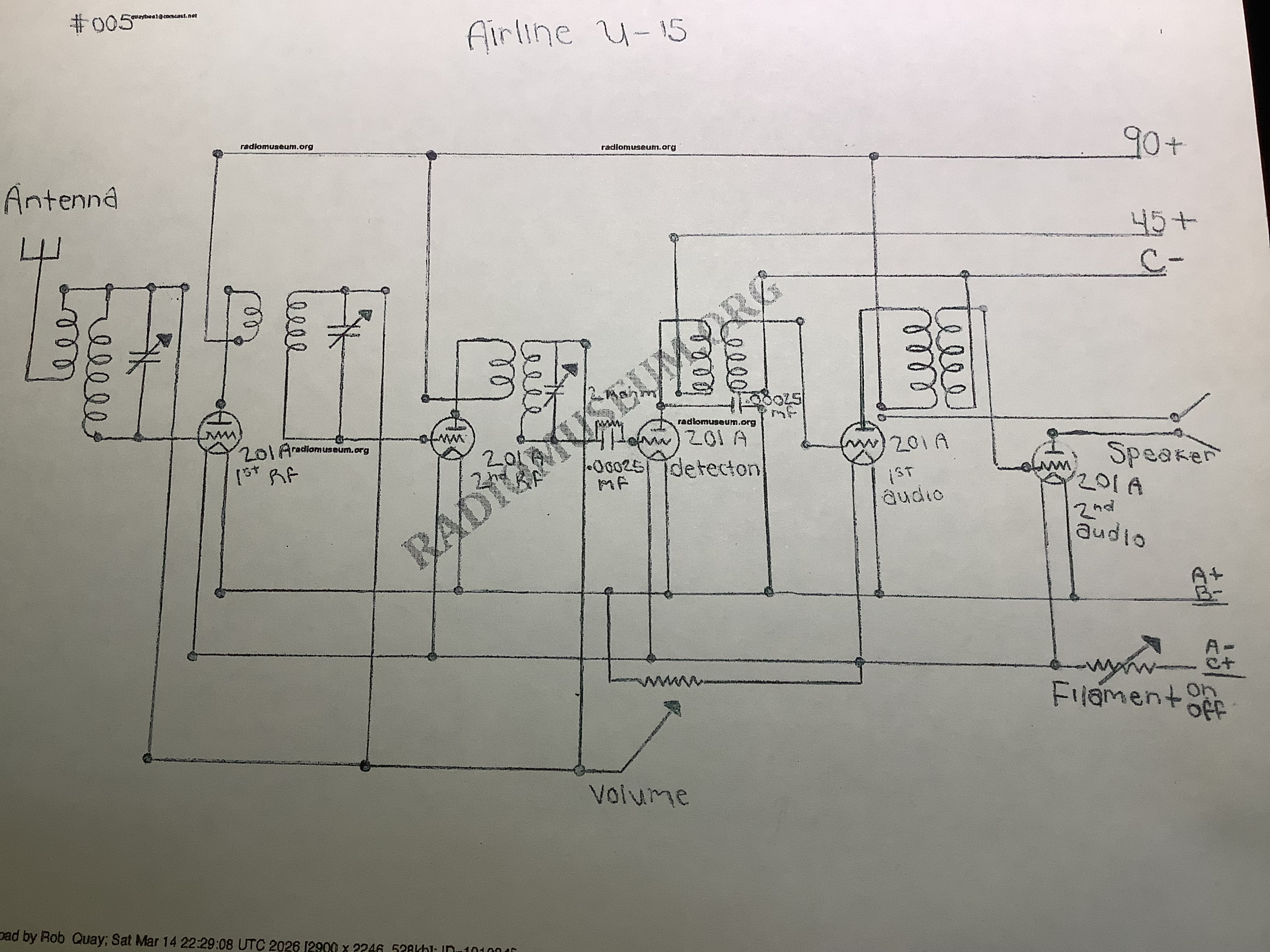

The model I have is the one with a self contained horn speaker, which works. As often happens with me the look of a radio got me to acquire it. Only later do I find out how much work is involved in getting it to work. The only schematic I’ve found is hand drawn but appears to be well done. Any suggestions are welcome! Thanks. - Rob

However, one thing that makes this easy is that almost all sets not sold by RCA (and many that were sold by RCA) were TRF sets until about 1930, as RCA heavily controlled the Armstrong Superheterodyne patents. The TRF circuits were fairly standard. The main differences were whether the detector was a grid leak or biased, whether regenerative feedback (an RCA patent) was used, whether "reflexing" was used (where a stage serves as both an RF amp and an AF amp; see the schematic for the FADA 160), whether Neutrodyne circuitry (a Hazeltine patent) was used, whether triodes or "Screen Grid tubes (Tetrodes) were used, whether the output is a triode or pentode, single end or push pull and, of course, battery or AC.
Oh, OK, there is a lot of differences out there. However, comparing your set to various schematics, you can find one that works.

RE: Airline U-15 issues - Rob Quay - 04-08-2026
Close……but no cigar. I’ve replaced the audio transformers and have sound but no signal. Checked tubes, cleaned pins, disconnected variable capacitors and checked for shorts, found and fixed loose wires, checked from antenna to “volume control” and have continuity. Some suggestions as to what to poke around with are welcome.
It’s a good looking radio even though the lettering is almost gone. Fortunately my wife is  graphic designer/ commercial artist. If we can get the old gal working she can restore the artwork on the front panel. Thoughts? - Rob
