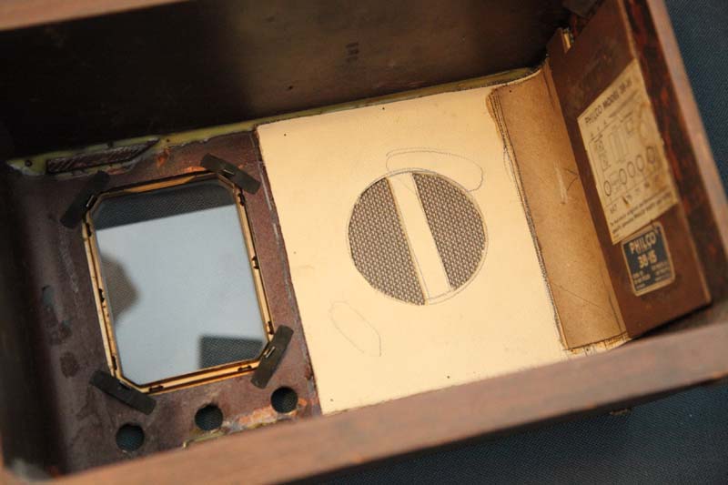

Wanted to pick your brains, guys.
The radio came.
Yes cosmetically it is very good and the chassis seems to be OK.
When taking the radio out of the box (packed real well) I heard some banging....I looked inside when I unpacked it; the speaker was loose.
But that'd be OK as long as it did not destroy anything (which it seemingly did not, or at least I do not see any damage); the problem is, the radio was obviously a subject to someone attempt to restore it (which we knew from Ron's comments) and the grillcloth was stretched over a solid piece of something, with no slits or a hole for the speaker, and the speaker is not bolted to anything at all.
My guess is, the restorer relied on the speaker to remain in a tilted position (it is propped up by the power tranny) for the sound to move in front of the cone; otherwise it would be a problem.
So, should I let it go or do you think that will be too much work to do? The cloth is stretched over some bending radius, so it is not as simple as simply stretching it over a rectangular board.

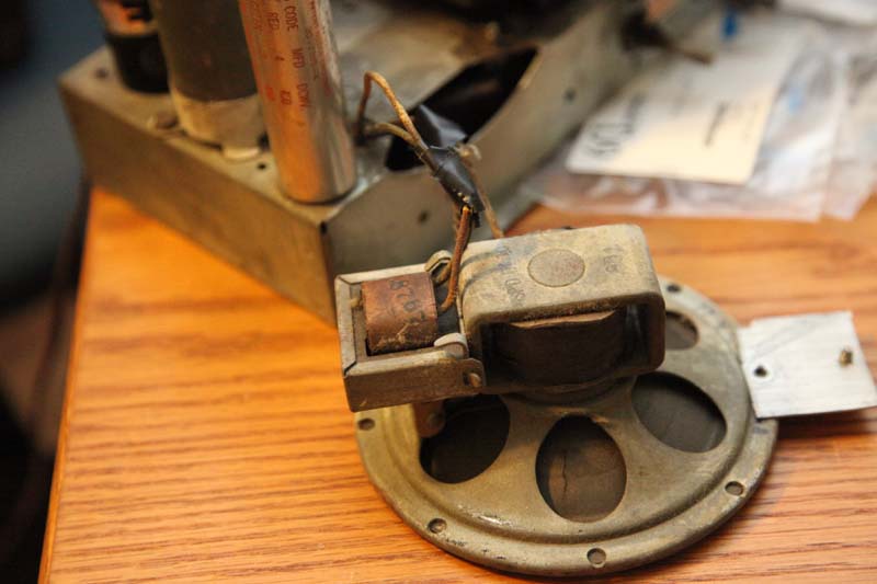

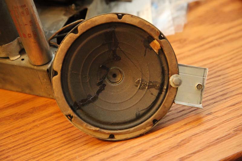

morzh - 02-02-2013

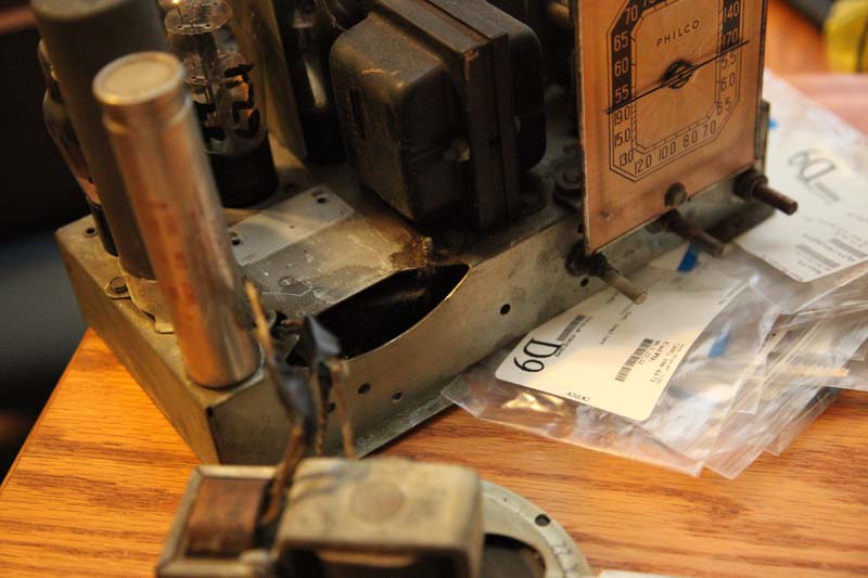

Here are the pics.
Obviously the opening is there, but the speaker is secured to the chassis (sort of like in portable radios) and not to the cabinet.
But it is possible the speaker is no original, so the make-shift bracket was concocted from a piece of aluminum, and the screws are short and during the transportation they just let go.

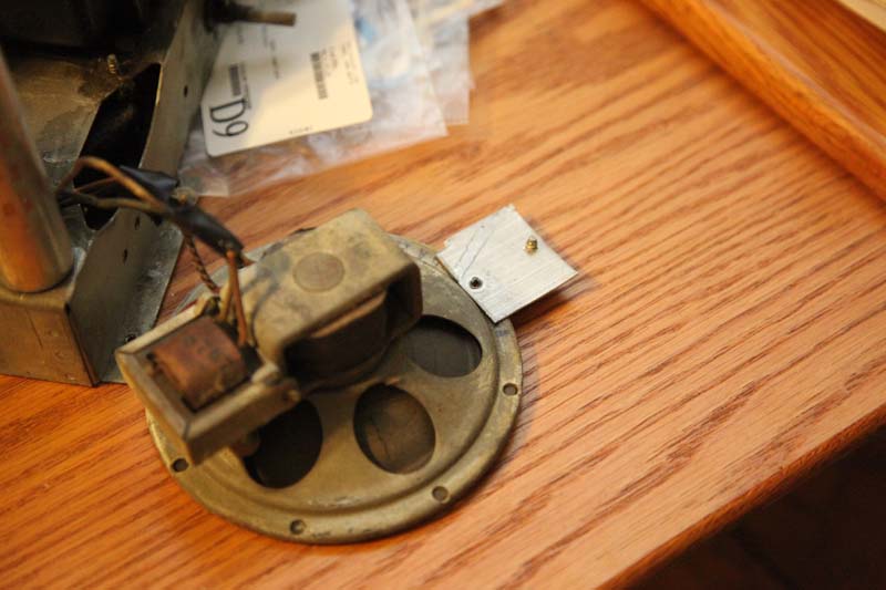

morzh - 02-02-2013

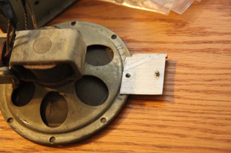

More pics:
The speaker of course was repaired for multiple tears.

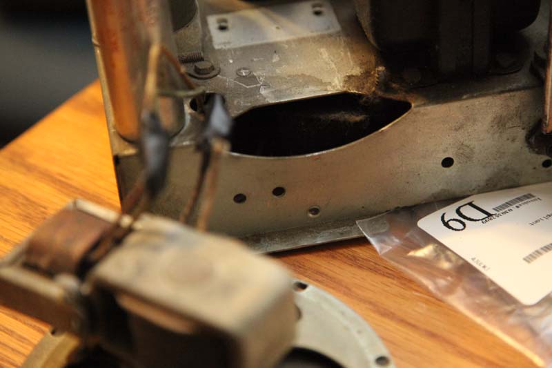

Ron Ramirez - 02-02-2013
Your speaker is definitely not original.
[Image:
http://i326.photobucket.com/albums/k420/mrphilco/Phorum%20Stuff/38-15_1_zpsdd27760f.jpg]
See where a bracket was once fastened on the chassis behind the speaker? This bracket was fastened to the original speaker.
[Image:
http://i326.photobucket.com/albums/k420/mrphilco/Phorum%20Stuff/38-15_2_zpseef5a6f4.jpg]
Yup, that's a homemade bracket on the front of that speaker. The original had a bracket here, also.
Looks like you need a speaker. You can use one from either a 38-15 or a 38-12, as the field coils have the same resistance.

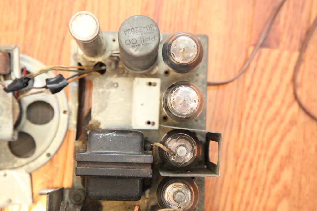

OK, so now that I am more or less done with the 18, I eventually got back to this one.
This is the sch.
http://www.nostalgiaair.org/PagesByModel/239/M0013239.pdf

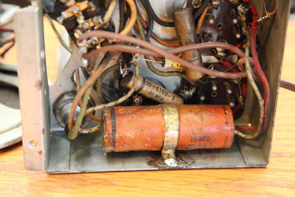

Took some pics of the underbelly.
The set was repaired at some point and that point was probably when I was..well, not in diapers - we did not have diapers, but as we say when I was able to walk under the dinner table without stooping, which I think translates as knee-high to a grasshopper.
It was done fairly neatly - the "new" cap is secured with a tin band soldered to the chassis (I thought the chassis was aluminum but soldering indicates otherwise, probably steel).
You can see a cut wire from the original cap, which was not removed.
It's the grey cap at the top-center of the chassis.
It is 16uF and not 12uF like it should be, but I guess that much deviation is OK.
Oh! Is it me, or did Philco connect the capacitors across the power cord without discharge path? Granted, it is 5nF equivalent but it will give you a painful pinch if touched after it was extracted from the outlet during the peak voltage.
Since it is a RPITB to re-rout it I intend to introduce a 1M resistor just across. The caps need changing anyway, the only backelite block in the whole set. The rest seem to be the tubulars. They all marked as PHILCO so I intend to keep the shells to hide the yellow.
