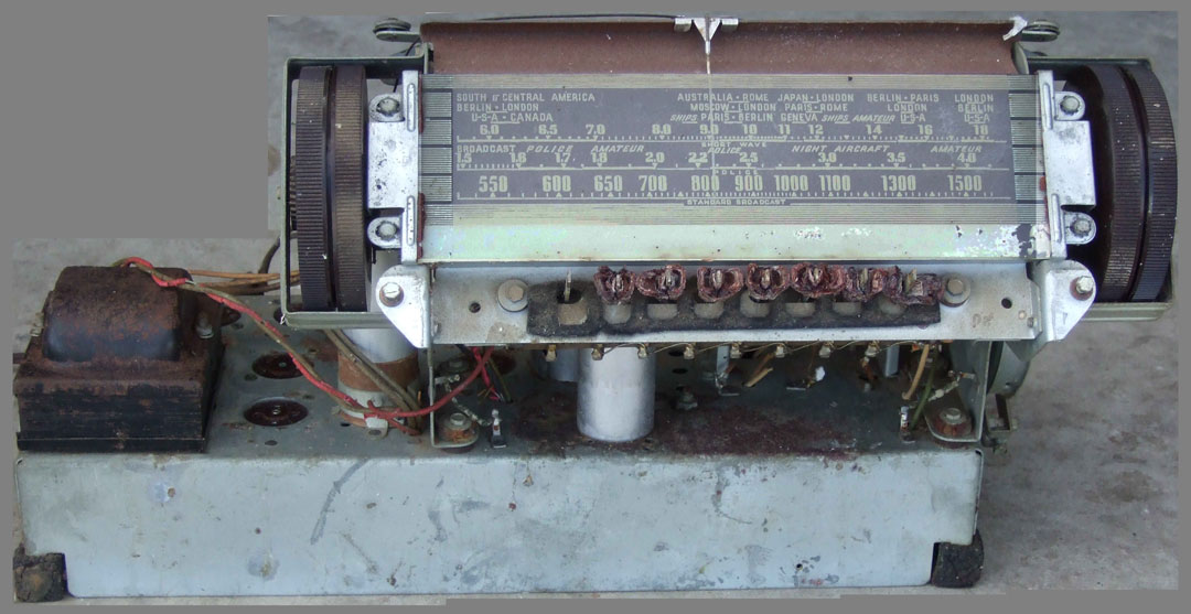

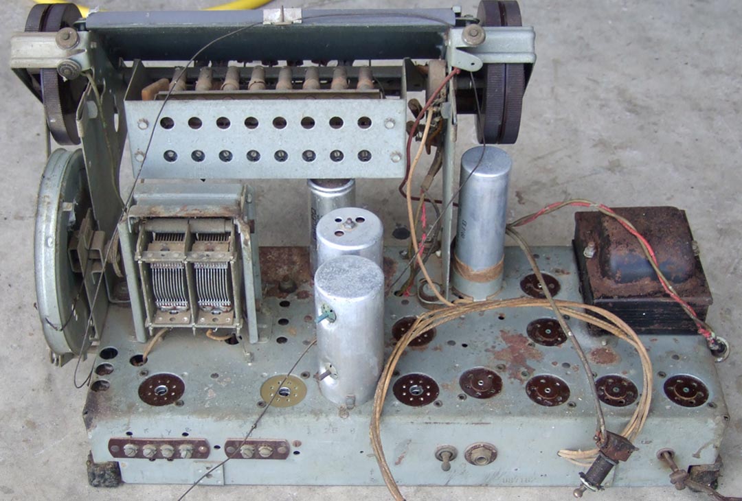

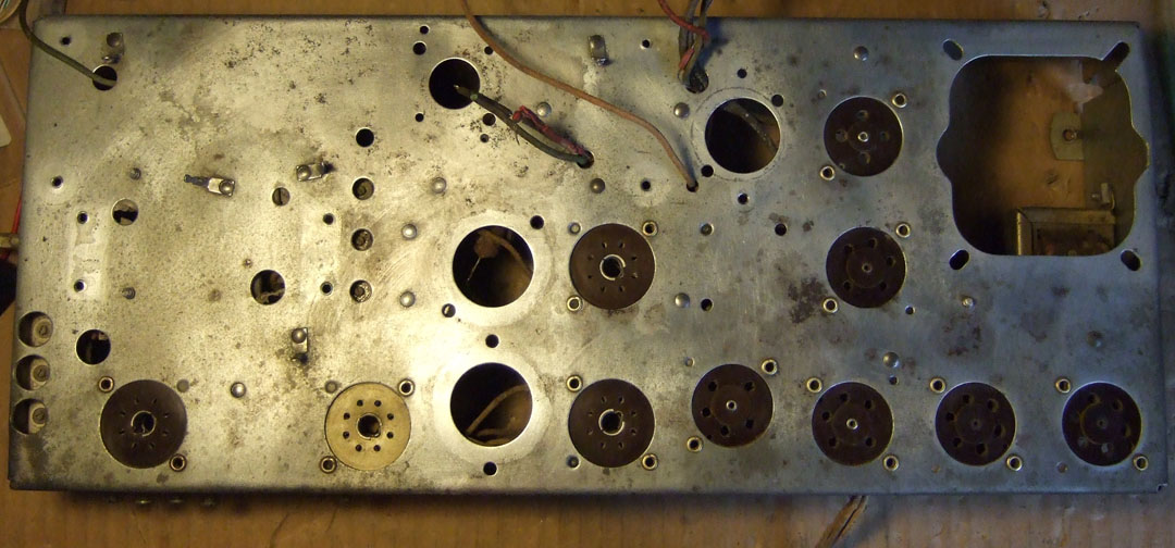

Since the 40-201 I have was so corroded on top from mouse pee etc., I decided early on that the best way to proceed would be to remove all top-side components and get it ready to paint. Here are a couple of pictures that illustrate the damage in the beginning and the condition now.
The last things I did were to remove the rivets holding the C78 electrolytic capacitor in place and the power transformer. I made sure I made a sketch of the connections for the power transformer first before disconnecting leads.
I probably need to get some naval jelly and treat a few stubborn spots first. Then I will mask off all the sockets and holes in the chassis and follow that with a light coat of primer, then a coat of Krylon Silver Satin paint as Ron suggests. I will loose the ink stamped model and code number lettering plus what I think is the date code and run number, but I have to do something to preserve the chassis for the future. I don't want it to continue to rust.
Of course the wires will have to be secured underneath too.
Joe

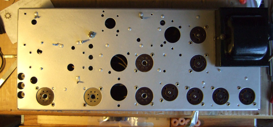

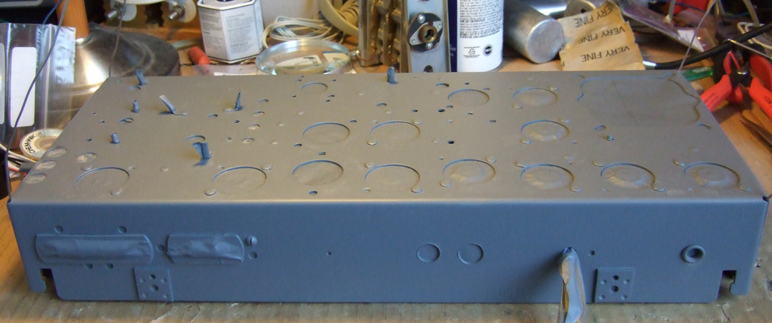

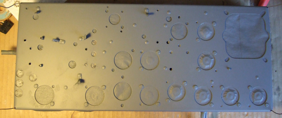

Joeztech - 11-28-2013

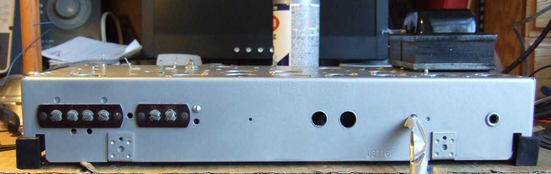

Today I fabricated two carrying handles for the chassis made of some electric fence wire. This allows me to move the chassis without touching it after painting.
I masked all the openings with either painter's masking tape or a cotton ball stuffed under the chassis against some trimmer capacitor top surfaces. The space was so tight I could not get tape in the spot without removing rivets and taking the trimmers out. I covered all the tube sockets and trimmed the masking tape with an Xaxto knife. I also covered the brass rivets that hold the tube sockets to the chassis and trimmed the excess masking tape there too.
I took the chassis to the barn and shot it with some gray metal primer. The temperature had climbed to a little over 50 degrees F., so it was OK to paint. The humidity is low now as a cold front had passed through. After about 20 minutes I brought the chassis back into the house and took pictures. Tomorrow I plan to look for the satin silver paint at Hobby Lobby or Walmart. I looked yesterday at Ace Hardware, but they did not have the right paint.
Joe

Joeztech - 11-29-2013
Today I made a trip back to Walmart and found the exact paint that we have discussed. It only cost $3.67. I bought the can, brought it home and proceeded to paint the chassis. The weather was great today with temperatures in the middle 50s and dry air - lots of sunshine. It did not take long to cure enough to bring it back inside and begin removal of the masking tape and cotton balls. It is not absolutely perfect, but looks far better than it did to begin with.
Ron graciously offered me a 36-1565-4 field core speaker which is exactly the 12 inch size and has the mounting holes correctly spaced to fit the baffle board. It arrived today and I promptly mounted it to the baffle board. The baffle board has received a coat of shellac like the rest of the cabinet interior to eliminate mouse odors. The new push-buttons, chassis rubber corner cushions and control panel bushings arrived today also.
It is starting to come together.
Joe
