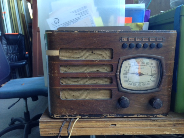

Here is the radio when I bought it:
By the time the post office got it to me, it was much worse. The grill slats had all separated and had to be glued back together, and the rest of the veneer looked like it had been worked over by Wolverine before his first cup of coffee.

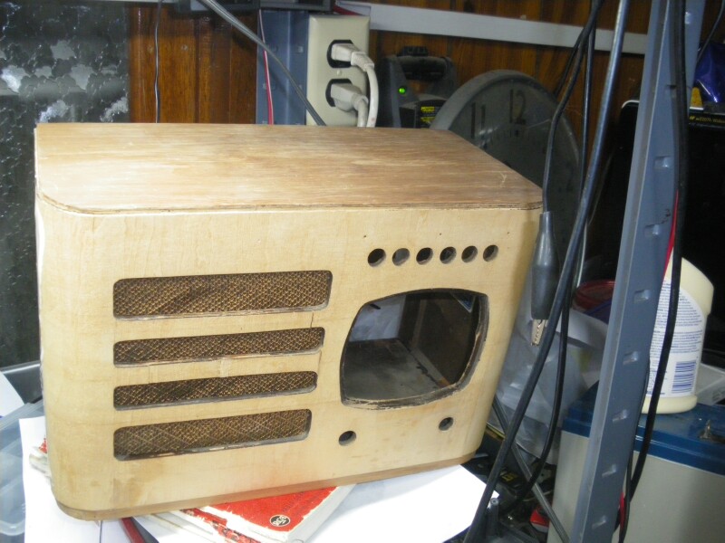

Here it is after a lot of regluing, stripping the rest of the flayed veneer and removing the trim pieces. I also lightly sanded it to smooth out the rough surface from the old glue.
Now, I've started the process of putting on the new veneer. I've done a couple stupid things here..
For starters, I put on a new grill cloth, and then proceded to glue the cardboard frame back into the cabinet. It looks good, but OOPS! Now I can't get to the back of the grill slats to make the appropriate cuts in the new veneer. This will be interesting.

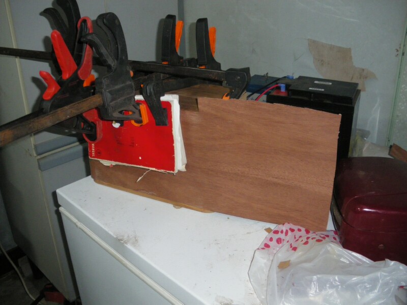

Next, though I did actually make sure that I had the straight side of the veneer set to the bottom edge of the front, it seems that while applying the first glue and clamping everything to apply the veneer to the side of the cabinet, it moved just a TINY bit, so now the veneer will not line up properly at the bottom. Icon_sad I noticed this within the first two minutes, but it was already too late, the glue had set enough that I could no longer move the veneer back into alignment. Icon_sad Not at all sure how I'll deal with this. Perhaps I can kill two stones with one bird, and run the veneer to the edge of the grill, then I can try to cut out the grill slots and get the veneer back in alignment for the rest of the application.
Now, I need a bit of advice: What is the best way to make the veneer form smoothly to the curved corners?
Thanks for any help anyone can provide.

Maybe a heat gun and a wet towel over the wood to steam it.

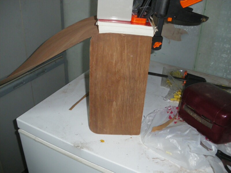

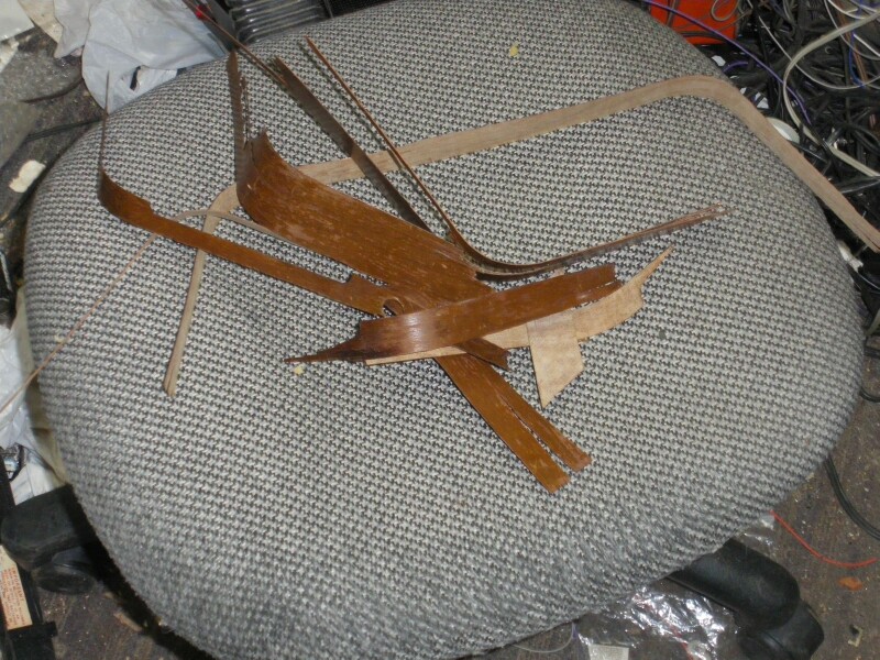

Tonight's progress...
This first pic is of what was left of the old veneer. I think you can see it wasn't worth trying to save.
And here is how far the application of the new veneer has progressed:
Tomorrow, I'll probably finish the application phase, then I can turn to smoothing the edges and cutting out the necessary holes. Wish me luck on that part. Icon_smile

(BTW the old veneer night come useful sometime for small patches and such).

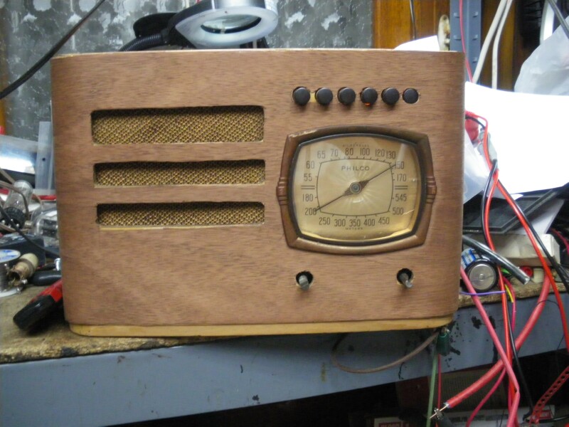

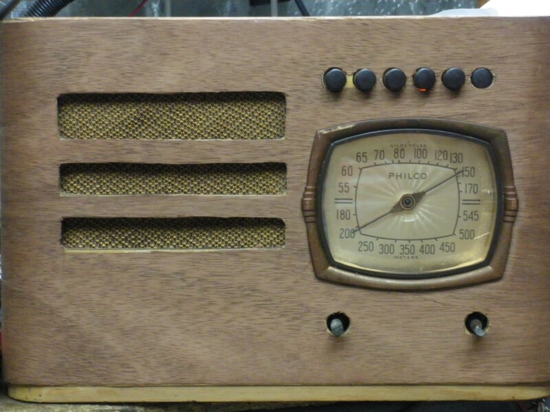

RE: 39-7: The Saga continues - BrendaAnnD - 01-05-2014
Well.....
Tonight, I finished applying the veneer. Let's put it this way, the first 3/4 of the application didn't go too badly. On the other hand, the last curve and side.. not so much. I used a bit too much glue, and as a result there is some waviness on the side. Fortunately, it doesn't show much from the front.
Mistakes were made:
While cutting the holes for the knobs, buttons and dial escutcheon, I made a bit of a mess of things, as you can see from the above pic. I'm going to try to clean them up a bit. I also erred by installing the escutcheon upside down. That's a PITA one to redo, as it has clips that one must manipulate underneath some tabs. I still have one more slot in the speaker grill to cut out.
This has all been a first attempt at doing a fairly (at least to me it is) complex veneer repair. And that was after fixing all the cabinet problems like separated joints and the "backbones" for the curved corners. I guess all in all, it's not TERRIBLE, just not quite what I had envisioned. Tomorrow, I'll cut out that last slot, clean up the divots, fix the escutcheon and stain the cabinet. I'll post another pic after that's done.

RE: 39-7: The Saga continues - Warren - 01-05-2014
Hi Brenda, I think your veneer is going good. With a little more work im sure you can straighten the speaker holes up with a file and just patch around any button holes that arent perfect, then do the laquer finish and I think after that it will look very nice. Good Work. Warren
