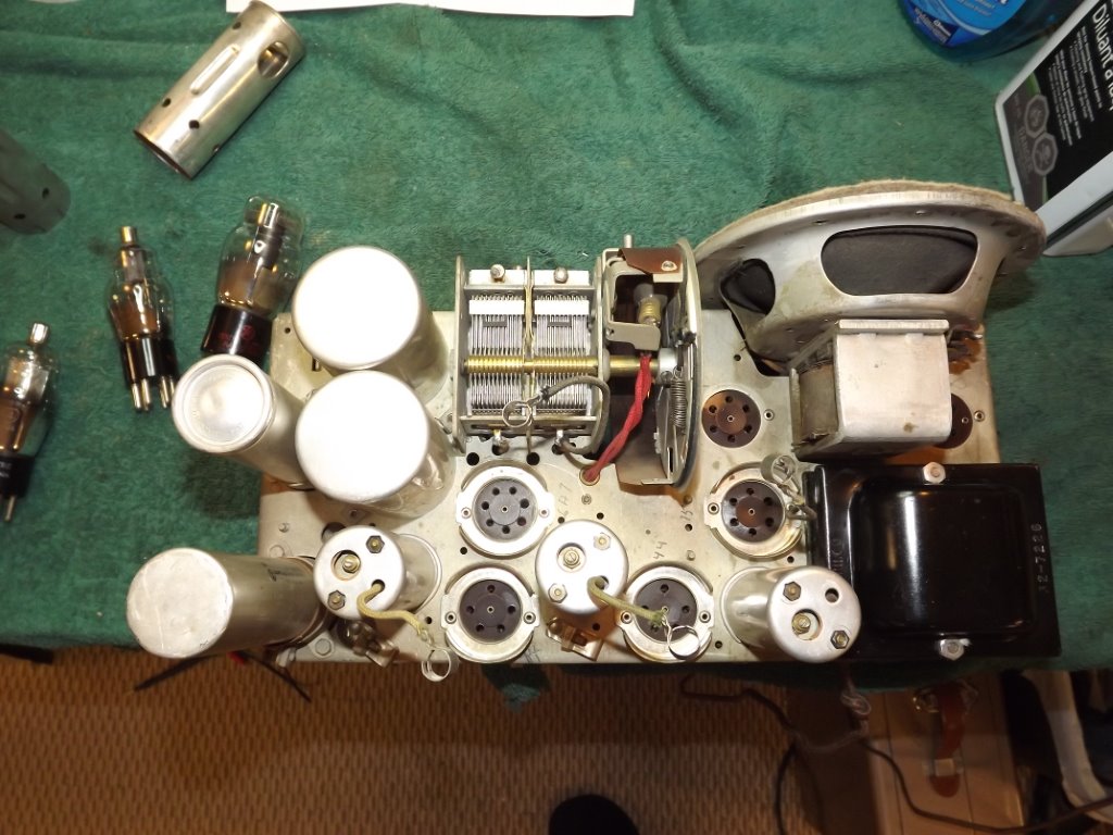

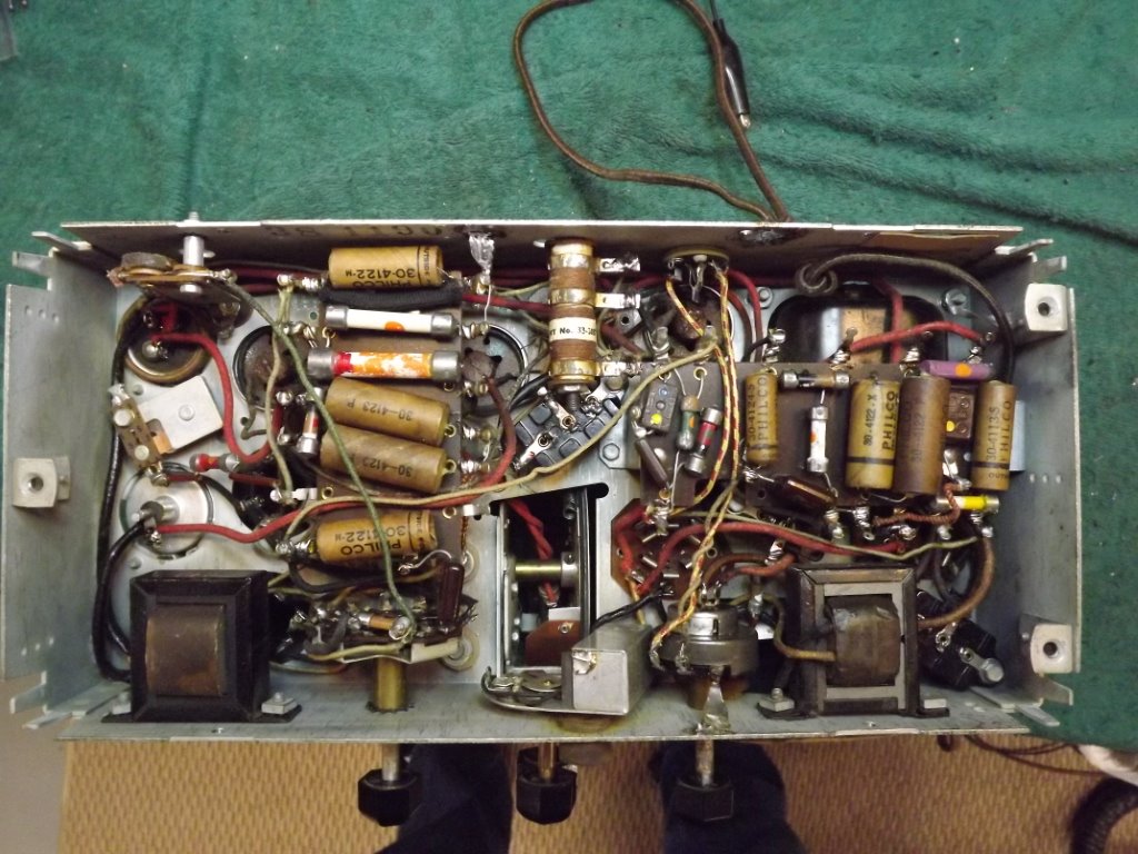

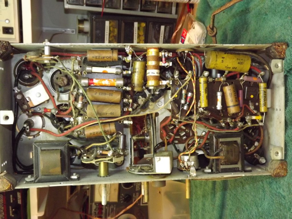

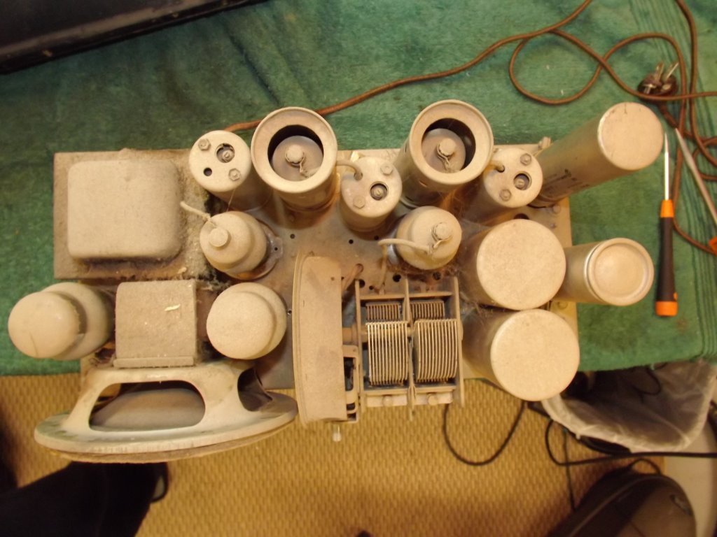

I have completed the chassis on my Canadian 345 Butterfly and thought I would share some before and after pictures. Special thanks goes to Oldrestorer who assisted with some parts!
All caps have been restuffed, all resistors checked and only two replaced. It had a bunch of different tubes in it and the 42 and 75 were both weak so all Philco tubes have been installed. The original line cord was in good shape but the plug was broken so a new vintage one was installed. New grommets were installed under the tuner and a new dial light was installed. I am very pleased with the outcome and it works and sounds excellent.
Top as it came from the cabinet.
Top after cleaning.
Bottom before restoration.
Bottom after restoration.

Greg,
Excellent job. Looks like yesterday from the factory.

murf - 02-21-2014
Looks nice.
Alot of work re-stuffing all those caps.
I don't have the patience to go that route.
I see you eliminated that large type 484 cap in the upper right of the picture.
Was that added by someone else in the past?
Anyway, good job.

There are several caps that have been removed.
RE: Canadian 345 Butterfly -
gregb - 02-21-2014
The after is exactly as is should be, the missing caps were previous repairs that I removed and replaced with the proper part number restuffed cap. Radios that I plan on keeping I will go the extra mile to make it as perfect as I can. Some might think its overkill and they may be right but this is the part of the hobby that I enjoy the most.
