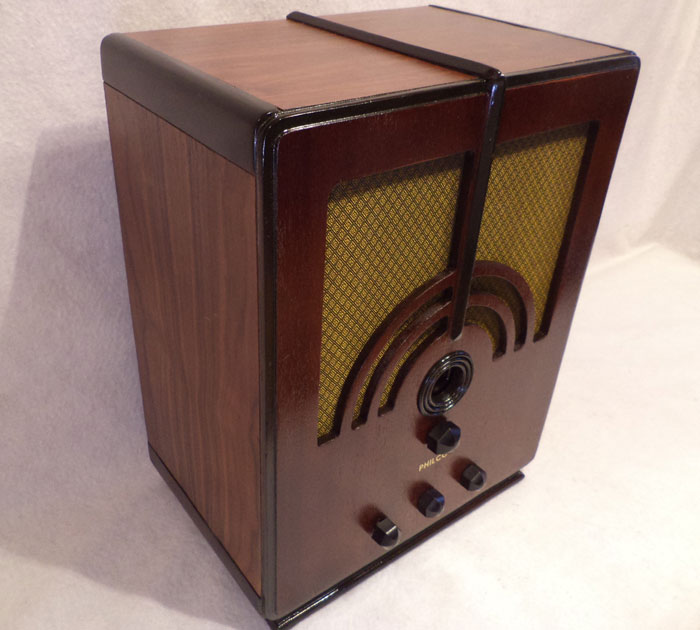

The electronics were done this winter, including all of the Bakelite blocks (thanks to many tips from Phorum members). I've been waiting for some nice weather to finish the cabinet.
I had to replace the veneer on both sides and the top. I finished it with Mohawk toners. Medium Brown Walnut and Van Dyke Brown for the trim. The grill cloth is a repro that is somewhat close to original.

B-E-A-utiful job, veneer is perfectly flat and looks original. where did you get the veneer and what type is it? paper backed?

RE: I finally finished my 66B - Eric Adams - 05-21-2014
Thanks guys.
Kirk,
The veneer is from Rockler . It is pressure sensitive. No messing with glue, etc.
I've used it before and have always had great results.
