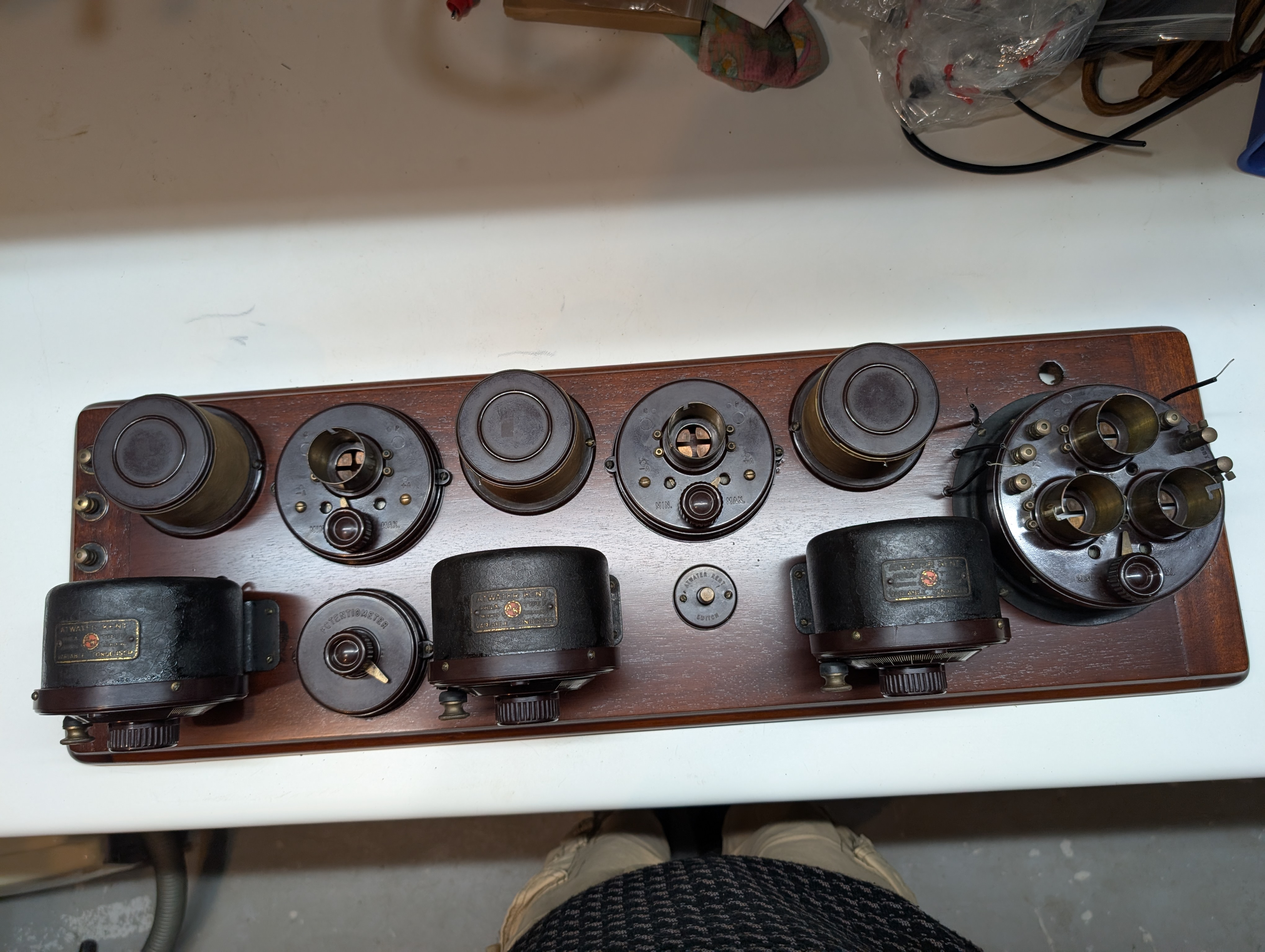

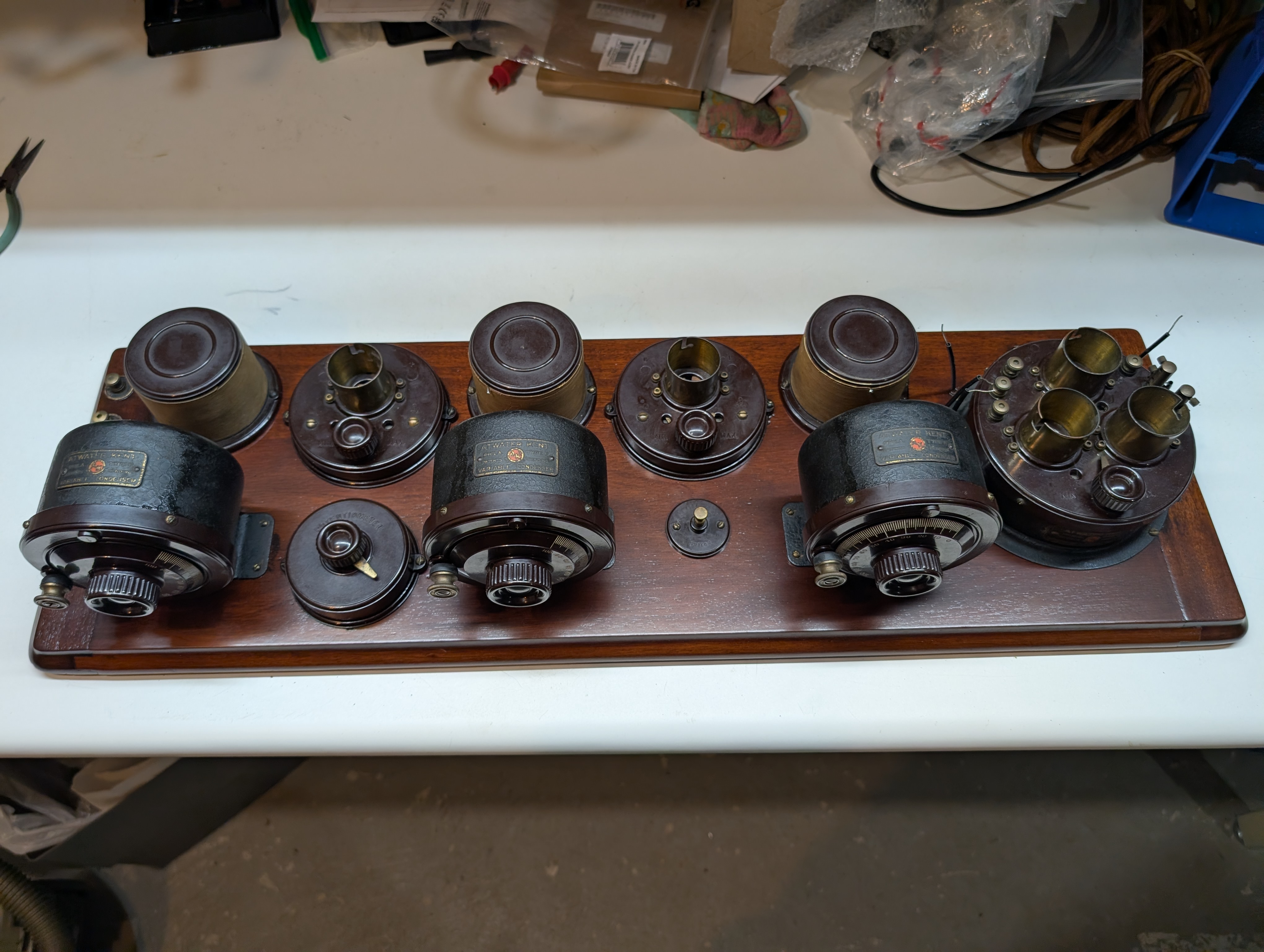

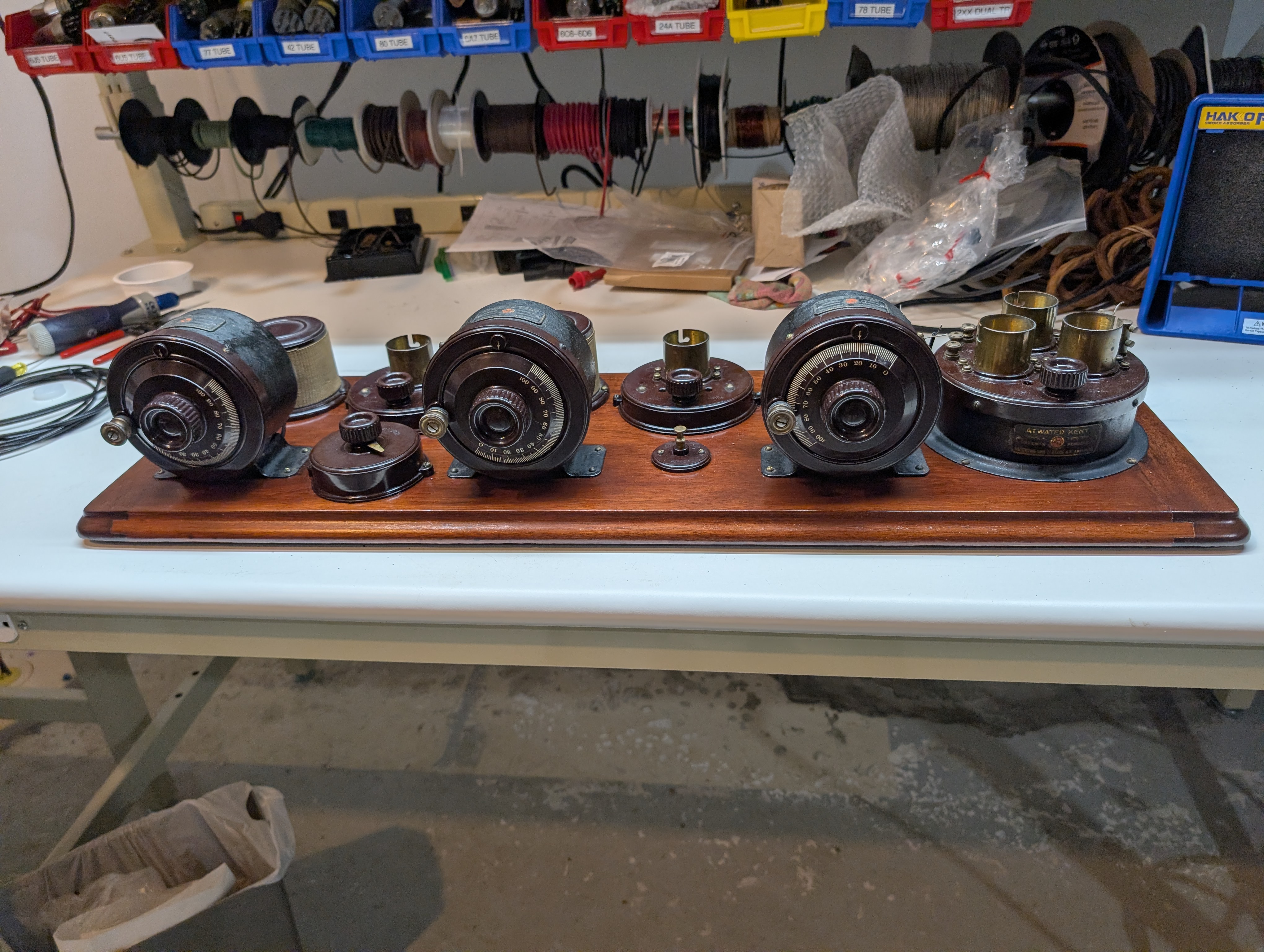

I could not get myself to go to the basement yesterday and had excuses in order not to, but today, after having cooked a meal for the family, I wentdown and assembled the parts to the board. No connections restored yet.
Here it is.
RE: Starting on Ron's AK10-A - RodB - 03-22-2026
Looking good, Mike.
