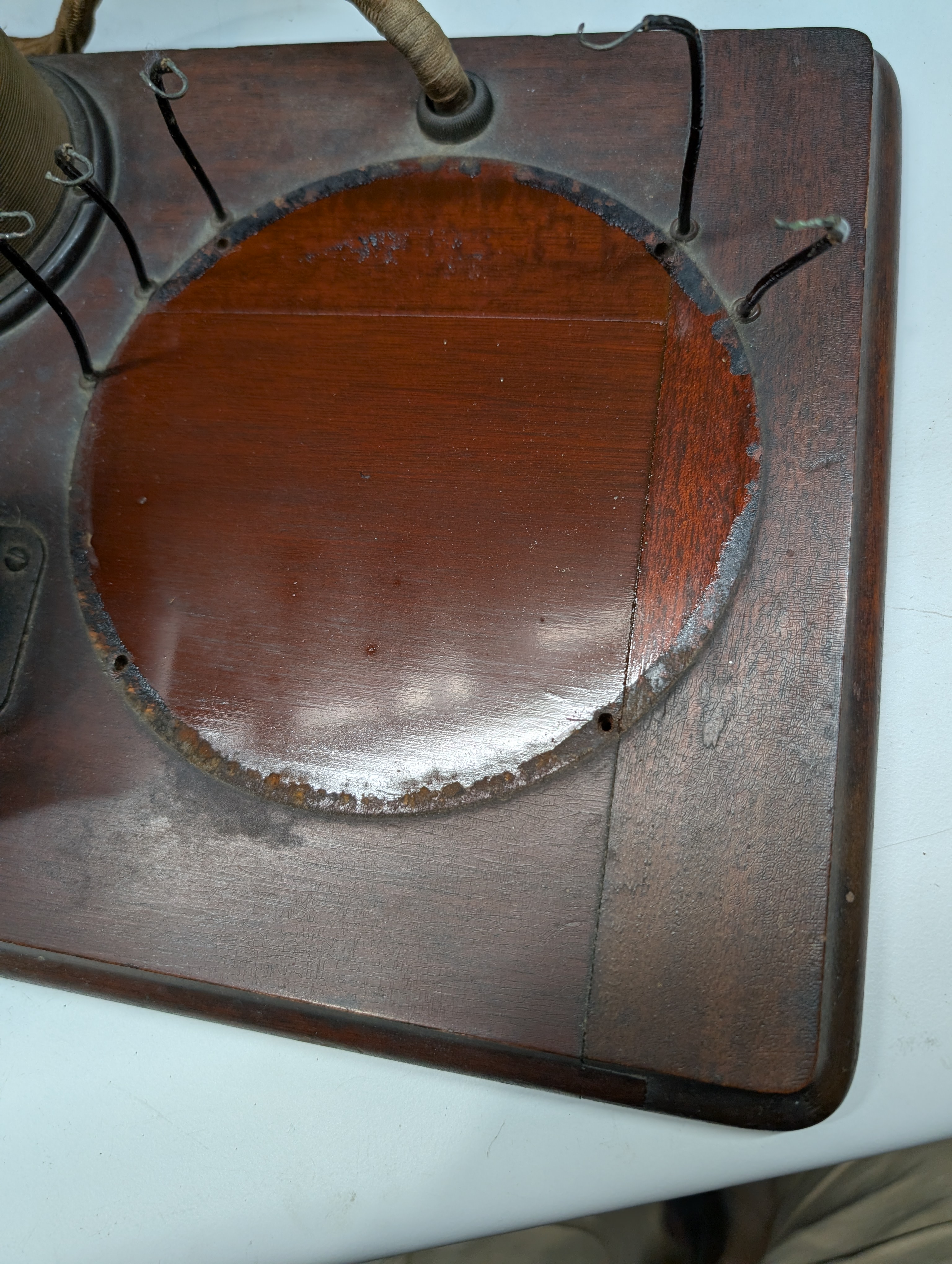

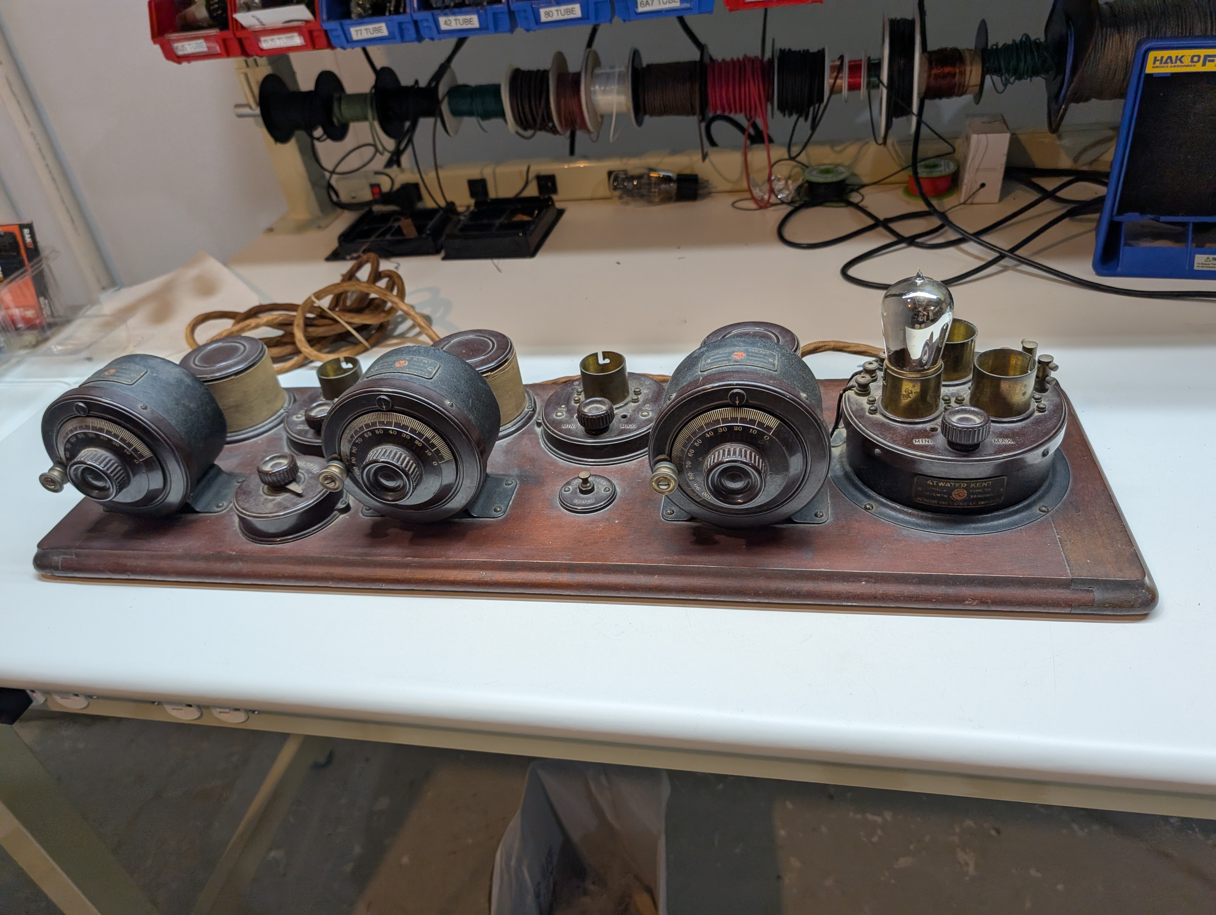

This is how it looks before the taking apart commences.
I took the amp assy off.
This is what the original finish looked like.

The first audio transformer is good.
The second has its primary open.
I am not sure it is easy to save one transformer and remove the other.
Will probably have to replace both.
