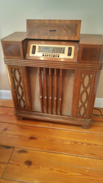

next question - I have a 40-201 -
clearly shown on the wiring schematic is a a 7C6 for model 40-200 only. I am supposed to have a 7A6, but the tube is a 7C6 in the socket. Is this ok? Tracing the wires it appears that this socket is in fact the 7C6 socket in the 7A6 location????? The schematic says that this is the location of 7C6 and use of 7C6 in the 40-195 model only.
RE: help with an old repair - 40-201 chassis -
Raleigh - 08-20-2015
Check out the notes on the bottom of the schematic, under the coil diagrams. It should be pretty clear that the 40-195 code 121 and 40-201 code 122 use the same chassis, so whatever the schematic says about the 40-195 is the same as your radio.
They don't say "the same." They say "similar." I have a hunch they probably mean "the same" except for model and code number stamps, serial number series, and other non-technical things that would distinguish one chassis model from an otherwise identical assembly destined for the other model.
It does clearly state that "Service information for Model 40-201, Code 122 is the same as that for the Model 40-195."
Note that the schematic diagram shows connections for the 7A6 are in dotted lines. The note says the dotted connections apply to 40-200 only. For service purposes you have a 40-195, so the 7A6 is not in your radio. The 40-201 should only have 2 tubes in the row next to the IF coil #39.

I like the idea of drawing it out too. I do find a sense of awe looking at a 75 year old piece of work. That this radio could pick up shortwave from Europe during the war is outrageous. to wonder if those listening (the original owner were manhattanites and had a summer home here in Wading River where ultimately all these great pieces were auctioned off, were from Poland and 1st and 2nd generation!) -

So I saved some money and sent the chassis and enclosure to a local professional -He replaced caps, resistors, bad tube, fixed some broken insulation, you know the normal stuff in a 74 year old radio.
The tuning section only required cleaning and the presets actually were still spot on!!!
at night, on the east end of Long Island, NY, the dial comes alive with broadcast and SW stations. Last night the kids listened to the Red Sox BB game and some music from 1500 Am out of Pittsburgh.
Absolutely amazing, and my 16 year old daughter pinky promised me that she would get the radio when it was time to move it.
That's special!
