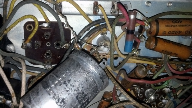

looking over the chassis I notice someone added a capacitor the existing wet cap, next to the rectifier tube. it is connected to the stem of the original cap, the transformer, the rectifier and one lead of the speaker.
Why was that done?
Could be the old cap got ... old. Not the best way.
I'd disconnect both. Chances are the wet cap is no good and the dry one isn't too far behind it. Lose both so you won't be looking for a power transformer or burn your house down.

As Mike and Terry said, that cap that was tacked in under the chassis was probably an old repair to replace the original electrolytic cap that had died. The old cap is probably an aluminum can that sits above the chassis with the lug below.  You can take off the replacement cap and stuff new electrolytic cap into the can.  There are a number of threads showing how to do that but here's one to start that gives you and idea of what to do.  You will need to replace all electrolytic and paper caps.  mica caps are likely still good.  Also check and replace resistors that have drifted high (>20%).  Some folks replace all resistors any way.  1940 sets may have rubber coated wires that need replacing as well.  See this thread.
 Yes, that can was added as a old repair, the original wet electrolytic probably dried up and in effect went open circuit. There were a lot of service shops, and even more amateurs that used to do that, even though every technician's course, and even some factory service manuals, told them not to.
Thanks - yes I'm a newbie/am, but can use a multimeter and can solder. The original cal looks like it's insulated from the chassis. so is there a ground somewhere?
Also I believe the repair was made because the clamp screw is facing the radio chassis and you'd have to remove the entire frame assembly to access the screw.

Ok so next question is all the resistors, caps and wire tidbits are twisted together and soldered as one hunk of love. Do I unsolder the entire mess or snip tight and solder a new mess onto the old mess?

Re: the twisted wire mess shown in your photo....if you restuff the original capacitor can, the leads from the replacement cap will come out.  That should help clean things up.
got it - looking at the tube sockets for instance it looks like the original work was  done by twisting the resistor wires and caps around the tabs and soldering them at once. To replace these resistors and caps would i de-solder and remove all that original solder and wire? I think I may have answered my own question...
Ah, now I understand your question...just a little slow this morning. Best to get a solder sucker and take as much solder off as possible, then work the leads off the tube socket lugs. Once the leads are off you can suck off the last off the solder and have a relatively clean lug to attach the new leads to. Sometimes the area you are working in can be crowded so there have been times I've clipped the old lead but left enough of it to use as a lug to solder the new lead to, but I usually take as much of the old out as reasonable.
I'm with Klondike on this one. I did my best to clean up as much of the chassis as possible--including complete removal of old components wherever possible (unless, as noted, I needed the lead extension) and the whacking great wads of solder from the previous connection. Less to heat up in case my new component fails or (more likely) I hooked it up to the wrong lug. (Ahem.)
