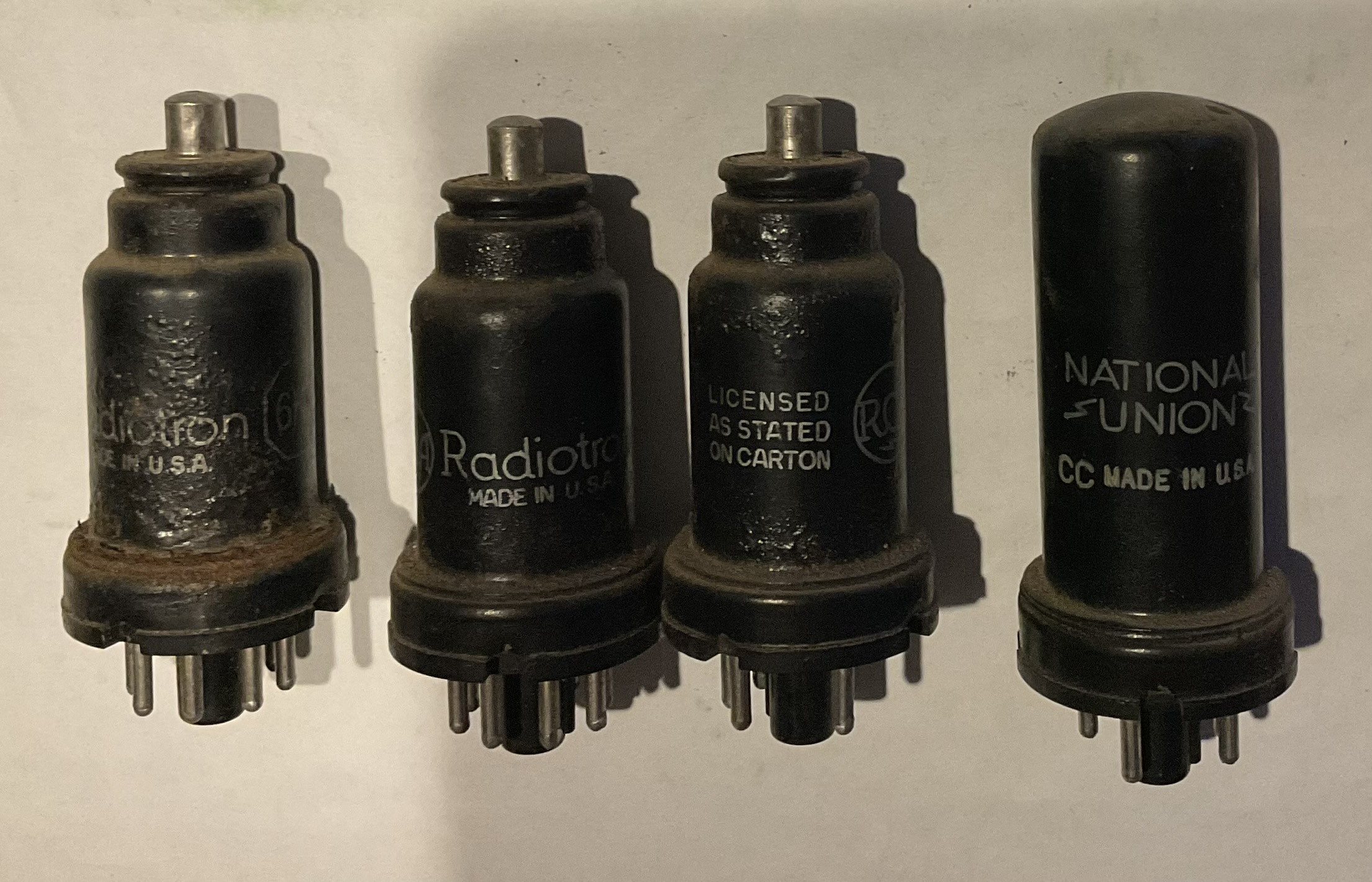

6F6 and 6H6 ordered NOS and installed (missing when I acquired the radio)

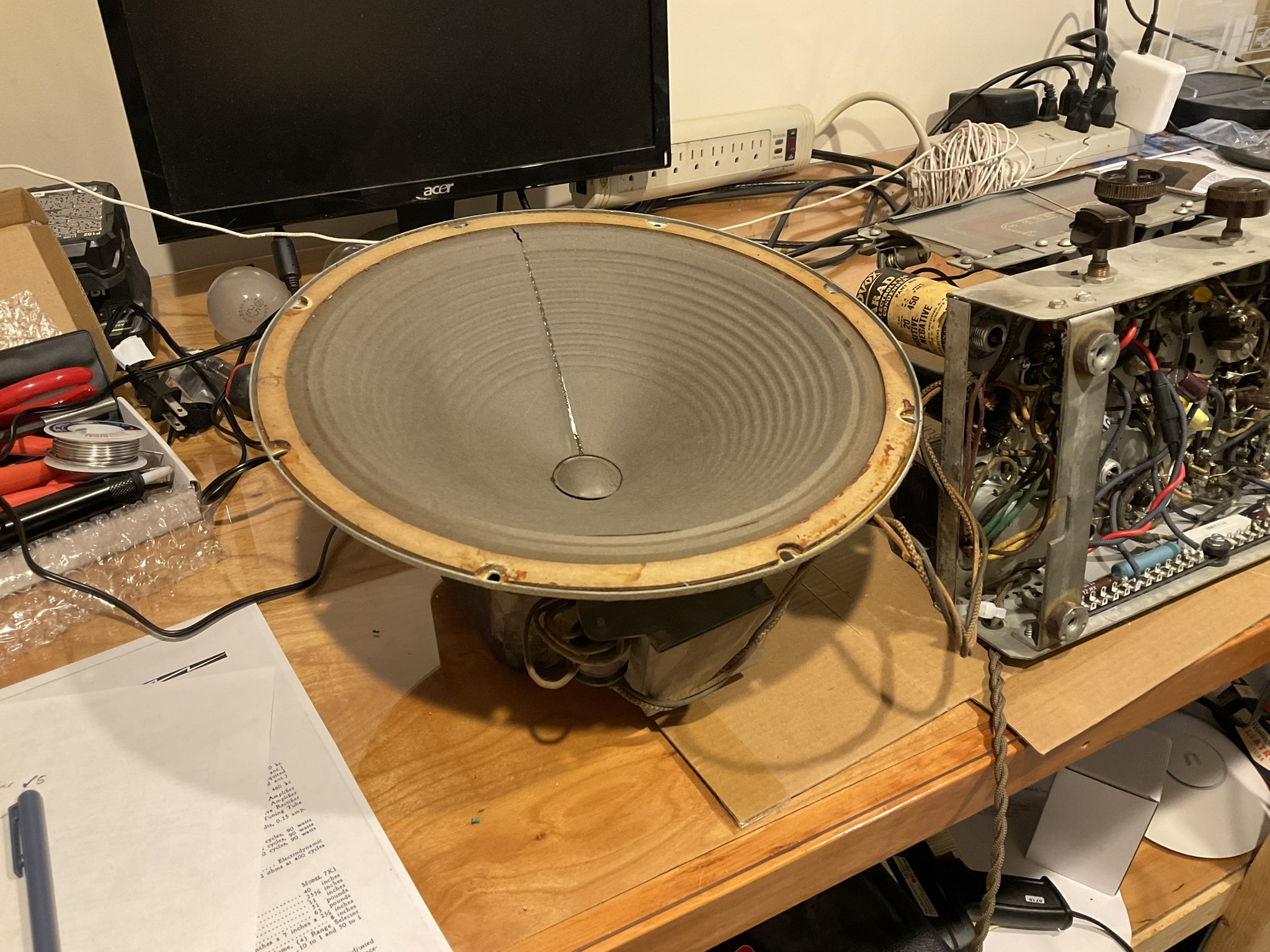

Update after testing external audio: the speaker sings as beautifully as only an 89-year old speaker reproducing the right audio channel will allow with a little evidence of needing to clean the volume control.  I was even able to test the tone control and could hear the difference so at least that also seems to be working.
So the silence is coming from the RF section it seems. The 6H6 (NOS from findatube) seems to be next in the chain backwards, is that where people would suggest we begin checking?  The chart for voltages from the service notes file seems pretty straightforward.

RE: RCA 6K3 Preliminary Capacitor/Resistor Research - morzh - 05-10-2026
I tell you this: a...let's see...89-year old speaker from the 37-116 (also, with different field coil, used in 37-690, 38-116 and 38-690), a 14" job, despite the age, will rival many a today's HiFi speakers. Which showed when I demoed my 38-690 to an unsuspecting visitor and they refused to believe that thing was built in 1938.
