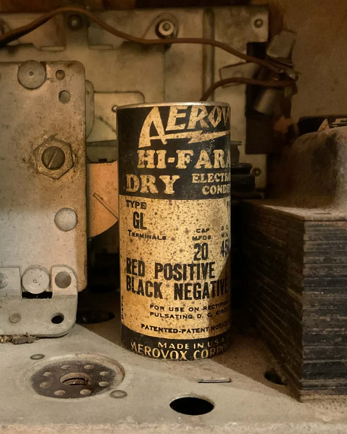

Re: electrolytic values, C30 (10 mfd according to documents) is the one that connects to the rectifier. I'm attaching a photo of the part that is installed. It's definitely old, but I'm not sure if it's original. Obviously, if the radio was serviced and parts were replaced, they could have been replaced with different values than original or designed. When you say that this value should be observed, would your recommendation then be to go with the value prescribed in the schematic vs what is in place? I have no desire to replace with something that is out-of-spec, on any of the three, let alone the one connected to the rectifier.

For electrolytics, it is different, at least it used to be. These were rated in "working volts". A 20 uF 450WV electrolytic would not achieve 20uF at 150V. With modern electrolytics, this may have changed.
It is best to replace the electrolytics with capacity values close to spec. However, the electrolytics back then had a tolerance (the level of accuracy) between -20% and +50% so a little more wasn't bad. However, for the capacitor closes to the cathode of the rectifier should not be too high. 20uf is not bad. I suspect that these caps have been replaced already as electrolytic caps do fail.

The Aerovox can pictured is an older replacement, possibly from the 1940s, or early 50s, the original RCA caps would have been in bright aluminum cans, no label, and may have been wet electrolytics, or at least the input filter cap. Traditionally the value of the input filter cap should be as close to original as possible, within 20 % of what the schematic suggests, or a tube manual if you have one handy, but I'm not sure that this matters as much with model electrolytic caps.

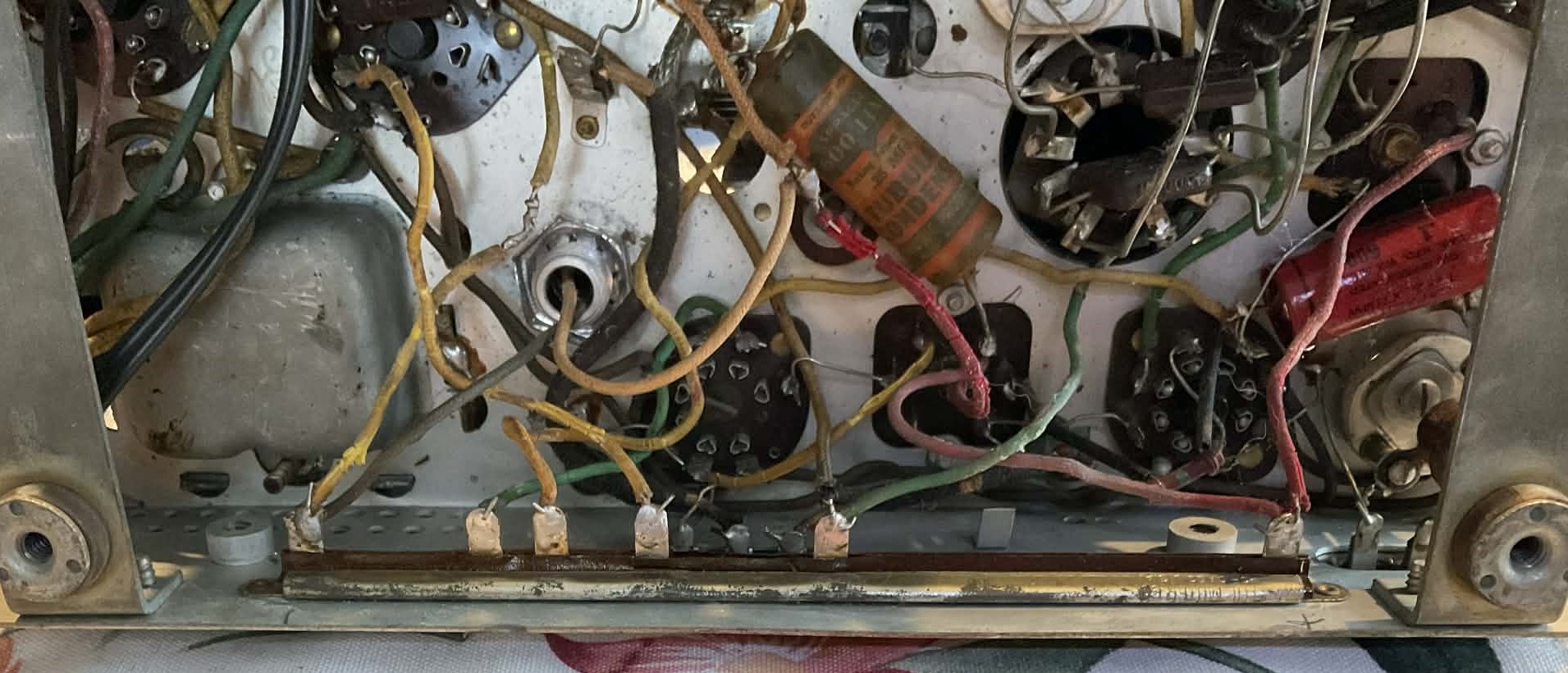

As for the potentially open resistor R15, since that is a segment of what appears to be one large single component, what would be the way to repair this? Does the entire voltage dividing resistor need replacing, or can the existing piece be modified/supplemented with an appropriate replacement?
I'll pull the chassis back out of the cabinet to check the readings on R5 and R7 as you described before placing an order. If the readings come back poor, is there any best practice for removing the shields around the transformer since they are riveted on?
Arran, thanks for confirming the existing electrolytics are not factory original. I will make sure to match the replacements with the values specified in the schematics.

Generally speaking, in Philco sets, any cap that is not marked "Philco" is a replacement.

Hi Roy, Arran beat me to it and with really good info. How to proceed depends on whether you are trying to produce a museum quality piece where you hollowed out all the original caps and used the casings to hide the new caps (called "stuffing" caps) or if you only care about everything above the chassis to look vintage and the underside can look new. The resistor we are discussing, RCA P/N 11466is a "Candohm". This resistor based voltage divider supplies the various "B+" voltages and the bias voltages for the 1st AF and Output tubes. Note that chassis ground is not the most negative point in the power supply. The center tap of the HV section of the power supply is. Please note that the negative lead of the Caps C30 and C31 does NOT go to chassis ground, the negatives go to the center tap of the HV secondary of the transformer. The negative of C16 DOES go to chassis ground. BTW, as Arran stated, the Aerovox 20/20 uF cap shown in the picture is definitely a replacement. The Parts list shows 3 different P/Ns for the 3 electrolytic caps.
You can leave the cap mounted but cut the wires from the under-chassis connections and replace these with modern caps under the chassis.
In either case I would completely replace all resistors in this voltage divider. (R13 through R18). Granted, the section that blew dissipated the most heat and power as it had the highest resistance, however, it's like headlight bulbs in the car. If you have to replace one, you will be doing the other really soon.
I think that the easiest and most reliable way to replace these resistors is to remove the Candohm (Drill out the rivets), mount a terminal strip or 2 and use 10W ceramic resistors. Dress these so they get as much ventilation as possible and keep them as far away from other devices as possible. They can be placed against the chassis and allow the chassis to dissipate heat, especially if the voltage divider resistor was a metal enclosed resistor ("Candohm") mounted against the chassis. DO make sure that you connect the wires routing the resistor correctly. Alternatively, get the aluminum encased resistors that Arran referred to as "Arcol" resistors and mount them on the chassis, or on a metal plate that you then mount to the chassis.

MrFixr55, I'm going for functional and generally authentic external look. I'm not laboring over minor cosmetic alterations, but I am trying to keep the general construction and function/circuits authentic as well. So, I'm not going to replace an entire chassis with new radios, but as far as a piece like this candohm, whether it's a single unit or an assembly of individual resistors, I'm fine with the most expedient and reliable way.
Photo of the current part:
In your terminal strip scenario, you mention mounting them against the chassis - I take it you mean to solder them in place on the strip such that the bodies of the resistors can press against the chassis side without making electrical contact, like a heatsink? Is the spacing and length of the segments of importance to reproduce, or is it arbitrary and more about getting it to tie together correctly? Given that in testing the segments there were terminals in common, I presume that the resistors themselves must either have solder points in common, or a separate connection between them to connect the series. This is of course in addition to the other wires that come in from the other points in the chassis.
Separately, after following your guidance on testing R5 and R7 (I actually also checked at the base of the transformer directly as well since the R7 tested very weird at the exterior terminals), R5 tests at about 80.2K and R7 tests at 230K, so it sounds like R5 or something connected to it may be problematic. Any tips on extracting the transformer from the shield, or is it simply a matter of grinding off/drilling out the rivets?

Not to reply to myself, but, I did find this guide from back in the day already as an attachment in this forum, though I don't know the context of the post:
https://philcoradio.com/phorum/attachment.php?aid=5868
This appears to be the identical candohm (from an RCA 6K2), or if not, the values it is supposed to have are the same. I know it has said to use 10 W resistors, but some of these values are really pushing the bounds of the 20% rule of thumb. I've been going with JustRadios.com, so if people would recommend a different source, I'm open to trying something else. I'm seeing a few other closer values in 5W. Both the 5W and 10W are advertised as +/- 5%. Would the following values be acceptable in this case (replacement value is closest 10W, with closer 5W values indicated in parentheses if available):
Orig -> Replacement
3.5K -> 4K (3.5K available in 5W)
13K -> 10K
85 -> 82
175 -> 200
40 -> 47 (40 available in 5W)
As far as how to install, I was thinking of getting a 13-terminal strip to be able to space things out, since heat is a concern and also I understand that 10W resistors are going to take up more space in the first place. Something like this from Tube Depot: https://www.tubedepot.com/products/termi...-terminals
Maybe not going the same exact route as in the guide but a similar premise. I like the dual terminals to keep the resistors and connecting wires separate.
