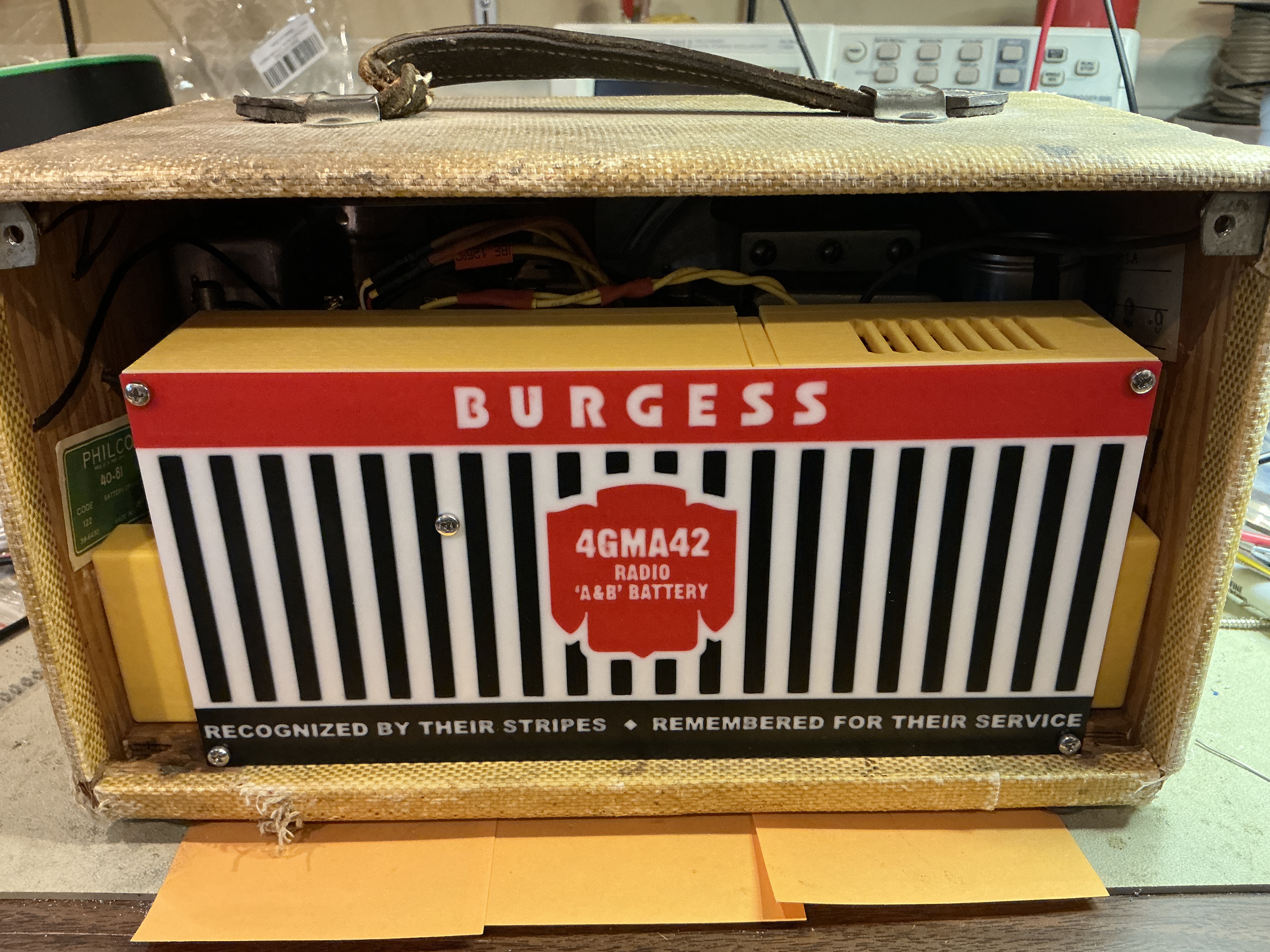

That sounds very cool, Dale! If this was my radio I’d run with the Burgess art. It’s pretty neat to wrap a “battery” in original art!
On this one, I returned it again today. I just couldn’t get the switcher quiet enough so did go with the LM317. It was a world of difference. A switcher might work but probably needs to be in a shield or something. It was always night and day between the switcher and a solid linear regulator or bench supply. The big advantage was it just dropped out fast without much sag.
But with the LM317 it sounds great. We listened to it a little and on the internal antenna it works great and he was pleased. He’s wanting to ground it and add an antenna on those back panel screws. It was pretty beat up but his grandad’s.
And thanks to all for the insights and information!
Just a glamour shot… ?

MZip, that is totally cool! I don't know which art I like better, the Burgess or the Eveready "9 Lives". The earlier Eveready batteries with the radio towers and lightning bolts are also cool, but by the time that these 1.5V / 90V portables came out, I believe that the artwork changed to the "9 Lives" logo that I remember well from the flashlight batteries of my youth (Lo those years ago!).
Where did you get the case from?
BTW, some of the smaller "3 Way" portables, especially the smaller ones like my 1948 Zenith 4G800 "Zenette" and my 1954 Revere 400 had elaborate switching systems, usually activated by plugging the line cord into the chassis, where on AC (or DC) line operation, the tube filaments are in series but on battery operation, the filaments (including the 2 subsections of the 3V4 output tube) are paralleled for 1.5V operation from a single D cell. The B Battery is 67.5V. Later on, by the mid 1950s, this was eliminated by a 7.5V A Battery that installed with clips but different from the clips for the 67.5V or 90V B battery. By 1960 or so, these radios all but disappeared, replaced by transistor batteries which, while more expensive to buy, paid for themselves in one season in reduced battery costs.
RE: Battery Box Project for 40-81 - MZip - 08-19-2026
I 3d printed that case and the covers. Drew it up myself as I was working on the other bits.
I also really like the 9 Lives one. I almost did one of those too but it’s not even my radio. But it’s a very cool design!
