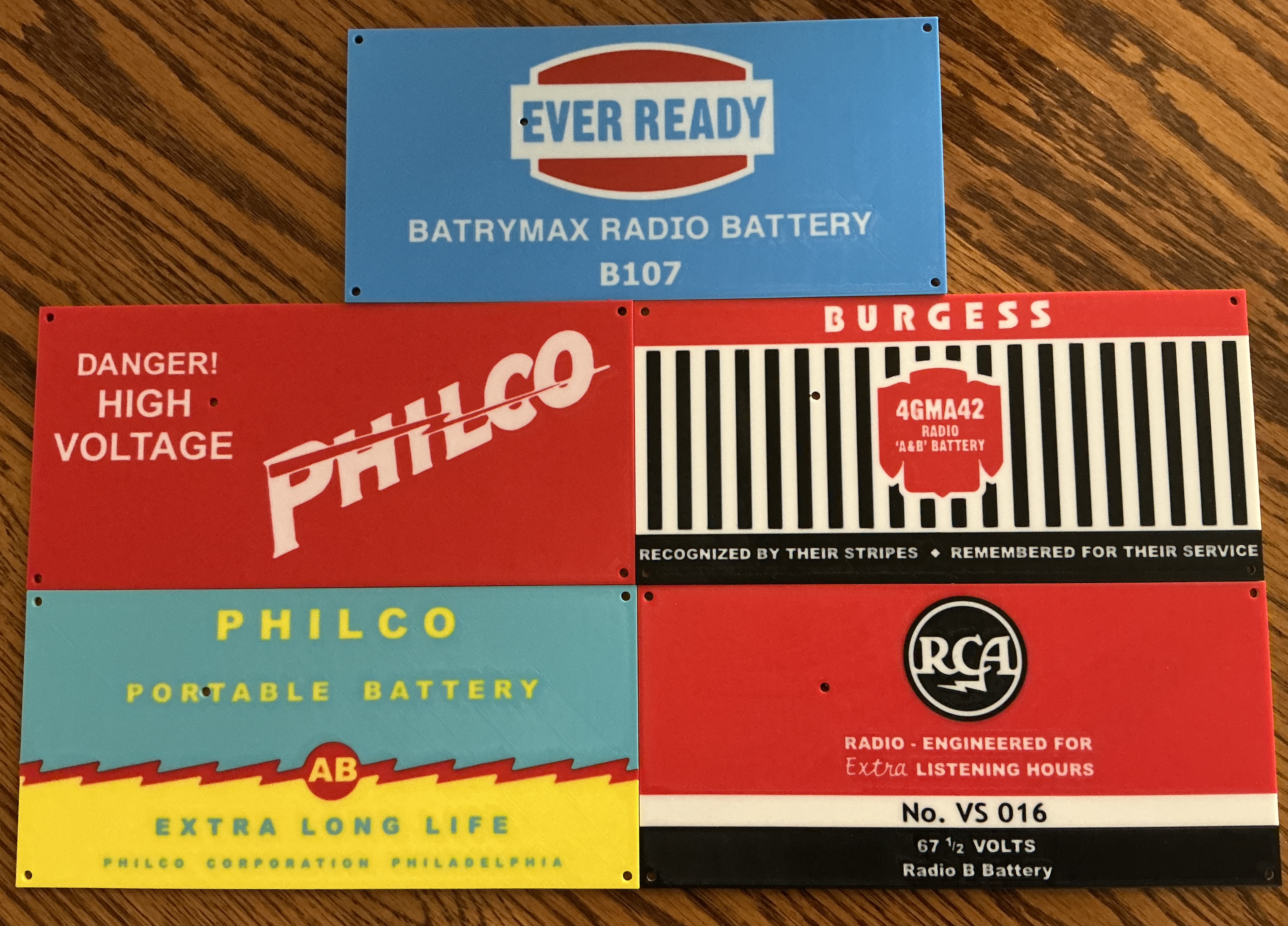

A friend’s grandfather had a 40-81 portable radio he asked me to get running. Did the typical replace caps and brittle wires and got it working. Sounds amazingly good, really. Part of that was building a battery box to hold the A and B supplies.
Anyway, the battery box needed a cover so decided to make some in the style of the old batteries. A little massaging of the designs was involved (not 100% accurate but fairly close). These are 3D printed to fit the compartmented box I also printed that holds the batteries. For those that care, I used PETG for the box and its bits for heat tolerance near the tubes (which don’t seem to get too hot at all) but PLA for the cover plates for easy printing of the designs.

Anyway, for whatever it’s worth. They snazz up a battery project. My friend only wanted a personalized cover plate. These were extra for fun. The high voltage Philco isn’t historical. It was just in the style my friend wanted but personalized and looked ok.
Those are good-looking covers.
Thanks! I love the retro stuff like that. And with the back in place you can’t see it. But it looks cool when you open it up.
The battery box isn’t to scale from a real battery so another deviation. I was trying to allow as much air circulation as possible but the 40-81 just doesn’t seem to get too warm at least so far that I’ve noticed.

Great job!!! I like the Philco and RCA ones, but the Burgess is my favorite. I remember the Eveready "9 Lives" Logo with the black cat jumping through the "9"

I’m with you on the Burgess and RCA covers. Definitely my favorites too.

On the cover designs, I used battery images from the web to draw them up. I saw where one person had printed the Philco wave version and used it to wrap a box and that looked cool. I 3D print a lot so making the box and covers was really easy.
