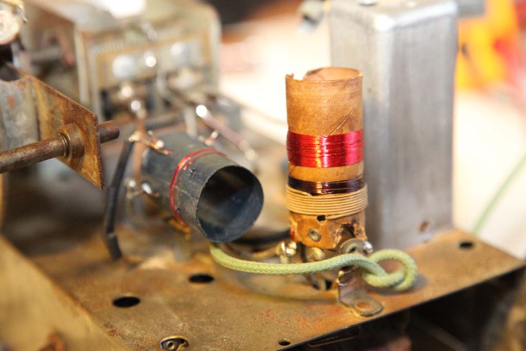

RE: Silvertone 45 chassis -
morzh - 02-26-2015

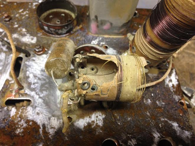

OldRestorer - 02-27-2015
Looks good Mike but just a thought. In the picture below there seems to me much more wire on the small bobbin.
Maybe I really did remove wire?
morzh - 02-27-2015
If you did it is no good. Why didn't you put this photo out before?
Do you have other photos of this coil?
Any other wires removed?
Wll, I will dismantle it and try to count turns on the photo.
For the future, the length of the wire left is the key, so do not touch it.
I don't think I would ever do that but I will look for photos when I get home.
I know I thought about it so I just wanted to say it as a far off maybe.
Hope I didn't screw this up
Kirk

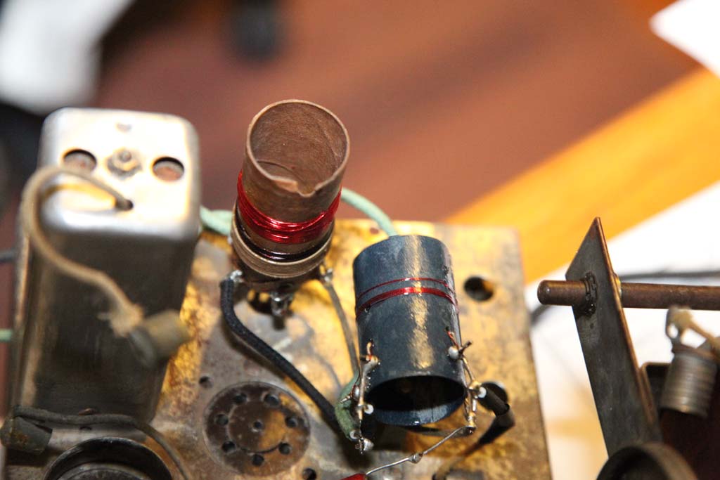

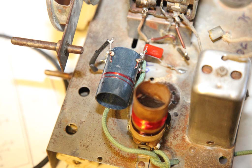

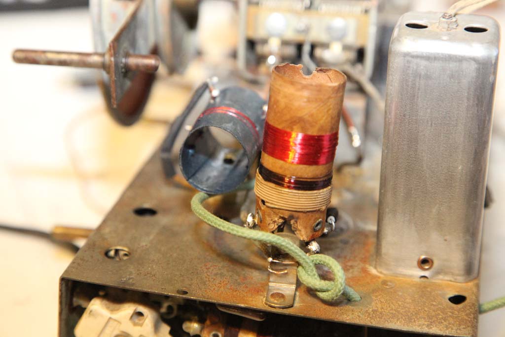

morzh - 02-27-2015
OK. Disconnected the coil, wound 30 turns (this is what I was able to count on the photo).
morzh - 02-28-2015
Well,
I suspect if it works, the coil will still need adjstment.
Thing is, the coil in question is a part of the first tuning resonant tank. So the inductance of it is important.
Now, the formula for cylidrical coil involves:
1. Square of the number of turns (so it is the most important) and this is what we are guessing.
2. Length of the winding. This we also do not know.
3. Crossection area of the bobbin. This we know.
So, first order of approximation is, I think, OK, but then it will need some adjustment.
morzh - 03-01-2015
Some radio....
While resoldering electrolytics (wires cracked so I actually just put one right where the wires came from, and other needed a shorter single wire) I could not understand one wire coming to the solder post which came from dial lamps.
Obviously it was connected to the negative (xfmr centertap.)
http://www.nostalgiaair.org/PagesByModel/931/M0010931.pdf
But.
This sch shows a sepatate winding for that.
I think they rely on negative bias developed across the field coil and the divider to light th lamps!
Wow....
Well, I rewound the coil, put 33 turns and will try to see (if it comes to life) how the signal resonates.
