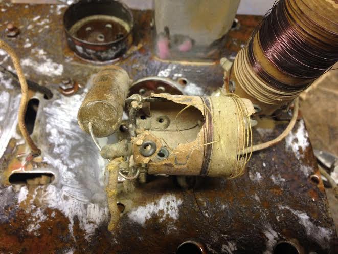

Looks good Mike but just a thought. In the picture below there seems to me much more wire on the small bobbin.
Maybe I really did remove wire?  Icon_e_surprised Icon_thumbdown
#84
If you did it is no good. Why didn't you put this photo out before?
Do you have other photos of this coil?
Any other wires removed?
Wll, I will dismantle it and try to count turns on the photo.
For the future, the length of the wire left is the key, so do not touch it.
#85
I don't think I would ever do that but I will look for photos when I get home.
I know I thought about it so I just wanted to say it as a far off maybe.
Hope I didn't screw this up Icon_rolleyes

#86
Well...imagine you came to a doctor with a majorpain in your behind. But because you feel uncomfy to tlk about it, the doc did something else, and you left the office with the same pain in your behind but without your tonsills and a prescription for estrogen ingections and a free box of Tic-Tacs. Icon_lol
You give me a pretty chewed up chassis that also has no sch, might as well tell me everything you know, every little bit helps.

OK. Disconnected the coil, wound 30 turns (this is what I was able to count on the photo).

Well,
I suspect if it works, the coil will still need adjstment.
Thing is, the coil in question is a part of the first tuning resonant tank. So the inductance of it is important.
Now, the formula for cylidrical coil involves:
1. Square of the number of turns (so it is the most important) and this is what we are guessing.
2. Length of the winding. This we also do not know.
3. Crossection area of the bobbin. This we know.
So, first order of approximation is, I think, OK, but then it will need some adjustment.

Well, I rewound the coil, put 33 turns and will try to see (if it comes to life) how the signal resonates.
