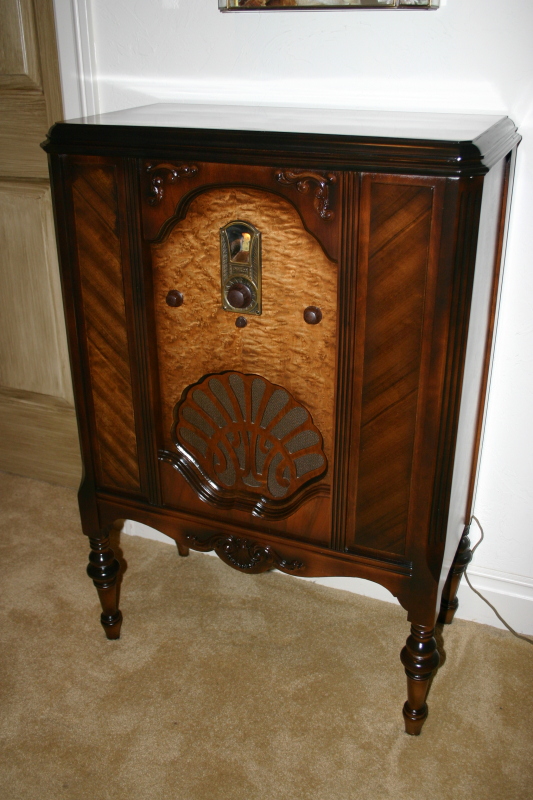

Phlogiston - 12-11-2017
---another one of those threads that I lost.
Anyway, the model 95 in our bathroom:
